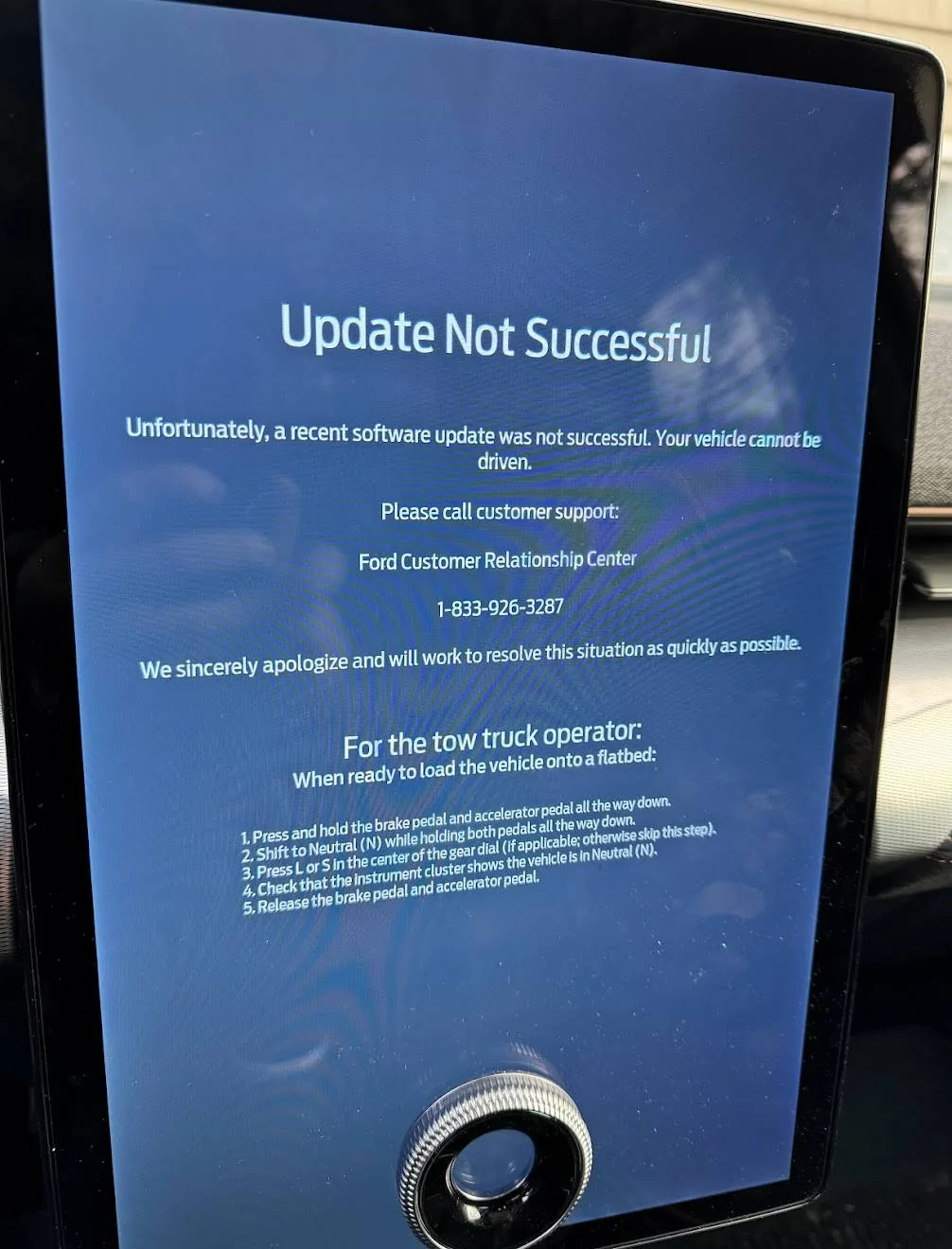

I was just about ready to leave to my in-law's house with a car full of presents, and I go to turn the car on and get this same message. To say I'm annoyed is an understatement. I thankfully have another vehicle that I had to scurry to re-pack everything into.. but how is this scenario remotely acceptable in any circumstance?!
I called the number on the screen, and it just took me to a customer service line where they then transferred me (unsuccessfully) to roadside assistance. I had to call back to get redirected again. And somehow the only option is to get it towed to the dealer. I don't have time for this nonsense :(

Can you send me your Vin?

The update that bricked his car is OBCC update 23-PU0722-DC-CHG3. PTS does not provide any helpful info. According to PTS, the update was supposed to canceled by the server, but obviously something happened.
Correction: His car has a failed 6.8.0 update on 12/19 that put the vehicle into inhibit to install and failed. Looks like it was that one. Waiting on @ricapar to confirm something via PM to confirm.

So, some good news and some “meh” news.
The good: Ford gave me a call this morning confirming the failed update on 12/19. The lady handling the case was super kind and helpful. At the same time I also had roadside assistance sending a tow truck to my house. There was nothing they could do remotely. I got assigned a case number in case I need to call back.
The “meh”: the dealership is backlogged. And they only have one person who works on EVs. They can’t give me an ETA on when they’ll even look at it. Folks at the dealer didn’t seem remotely interested in trying to help No loaner but they’ll cover $45/day for a rental as long as it’s a Ford.

Report all of that to your BEV case manager at Ford. They can put pressure on the dealer to be a little more helpful.
Sorry this happened to you. I am curious if it's a wider issue with 6.8. My job 2 has failed multiple times trying to install it and I have seen others going through the same.
You don’t need an EV tech to run FDRS. Oh well, you probably know. But the dealers …

Mostly likely failing due to low SoC/capacity. That is very common with updates that require the vehicle to be inhibited. I can check in PTS with your VIN. PM if you prefer to keep it private.
Do all Ford models update software using FDRS? More occasionally for other models of course, but are all techs trained on it?
Yes, all newer Fords can be updated with FDRS. Because of the high voltage risks associated with EV's, dealers will have one or two techs with the additional training required to work on these vehicles. With that said: To fix this, you do not need to mess with the high voltage stuff, so any tech can do it. Because the dealer does not know what the problem is, they will wait for the EV certified tech to get to it in case more than just module programming is needed to fix it.
