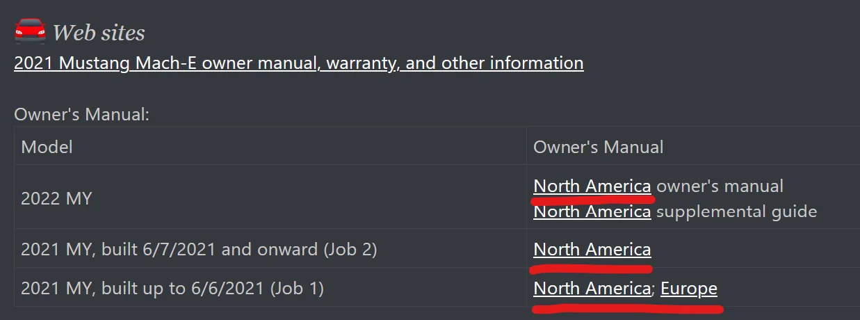

I think it's just presenting content from the owner's manual links shown at the top of this page:
https://www.macheforum.com/site/thr...manuals-and-web-sites-for-mach-e-owners.1660/
