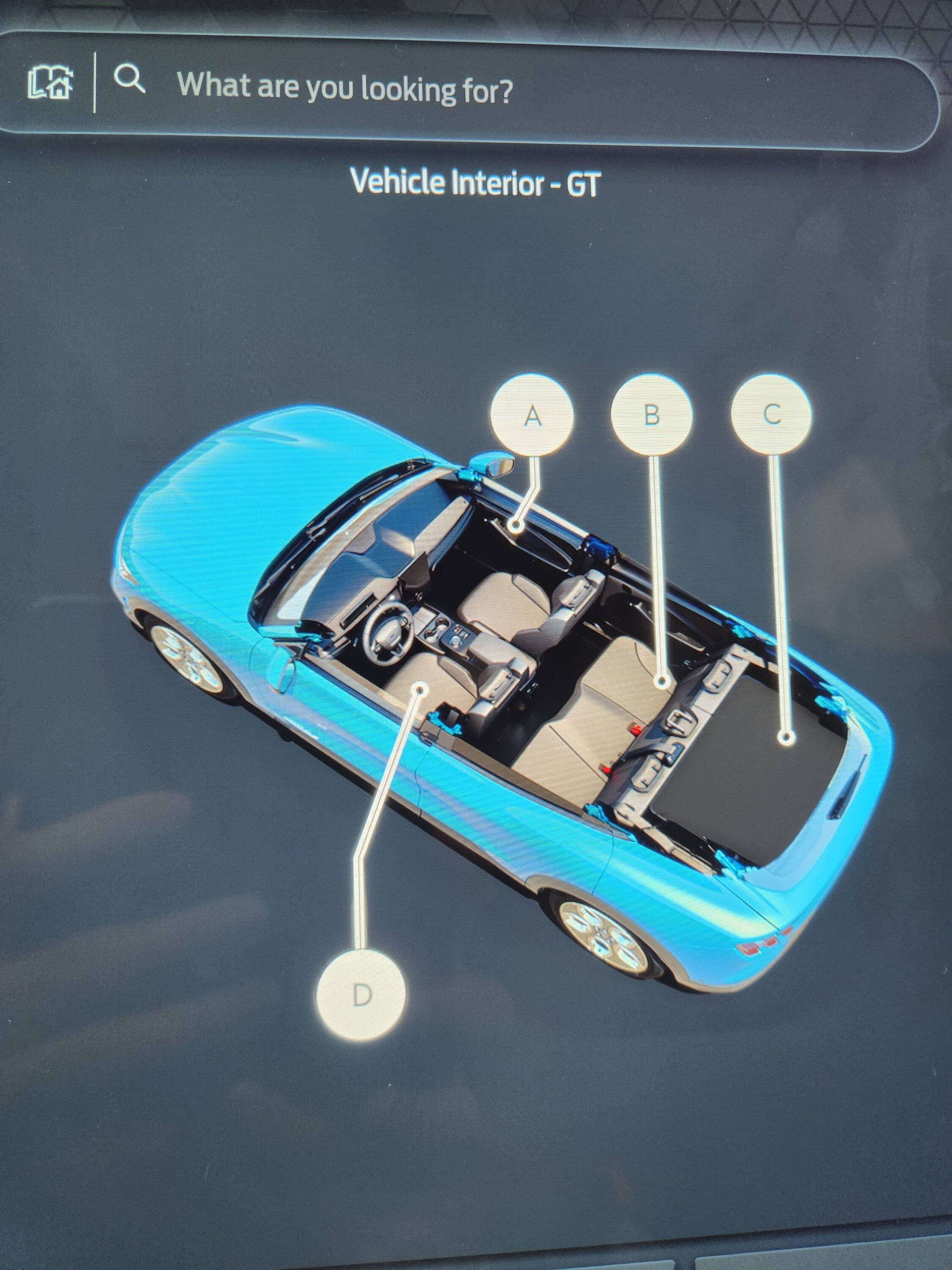

Mine is working just fine with 4.1.3. They also have a convertible mach-e there.

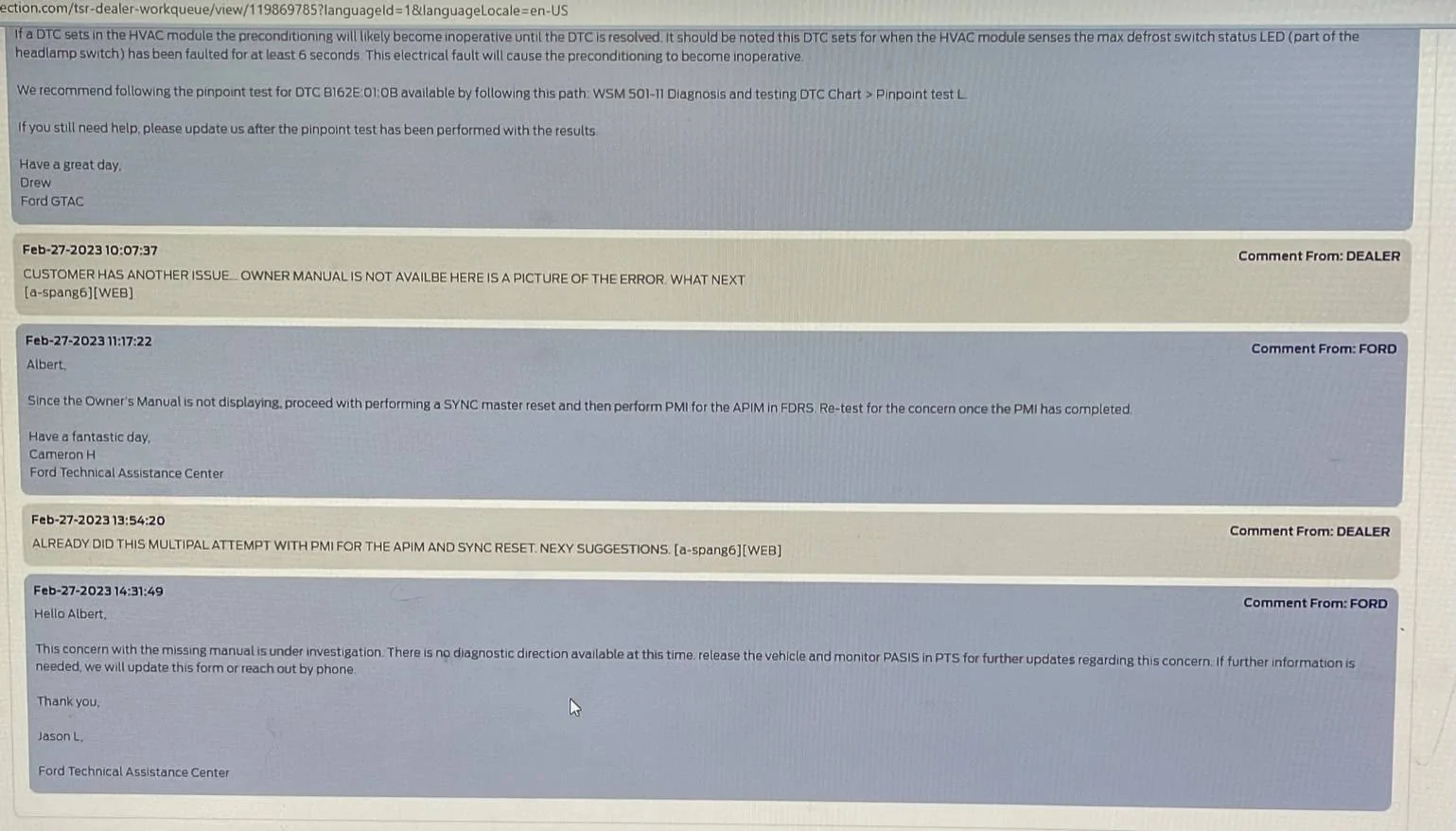

Well, the fun continues on getting the owner's manual back! Here's the message exchange with FoMoCo regarding my dealer's efforts to get it back. Many of you will understand the tech lingo, but I don't.
They finally determined that the preconditioning disappearance was due to a switch malfunction . . . .which, of course, is on back order.
I did file a case with Ford and it tended to speed up their responsiveness to the dealer who was languishing in getting responses timely.
Like the car, hate the problems.
Ford Mustang Mach-E 4.1.2 Owners Manual Not Working Ford Error Messages
Wow, the Max Defrost LED code is caused by the headlight switch bug. When the bug happens the switch doesn't respond and it causes the headlight to stay on as a failsafe, and the HVAC module freaks and sets that code. I'm not sure what your preconditioning issue is, but the headlight switch bug is probably causing it then.
Do not let them replace your HVAC module or APIM, they are fine.
The manual not working is caused by a configuration issue that can't be fixed at the moment. They are working on it. Do not bring your car to the dealer for the missing manual because they can't fix it yet.
