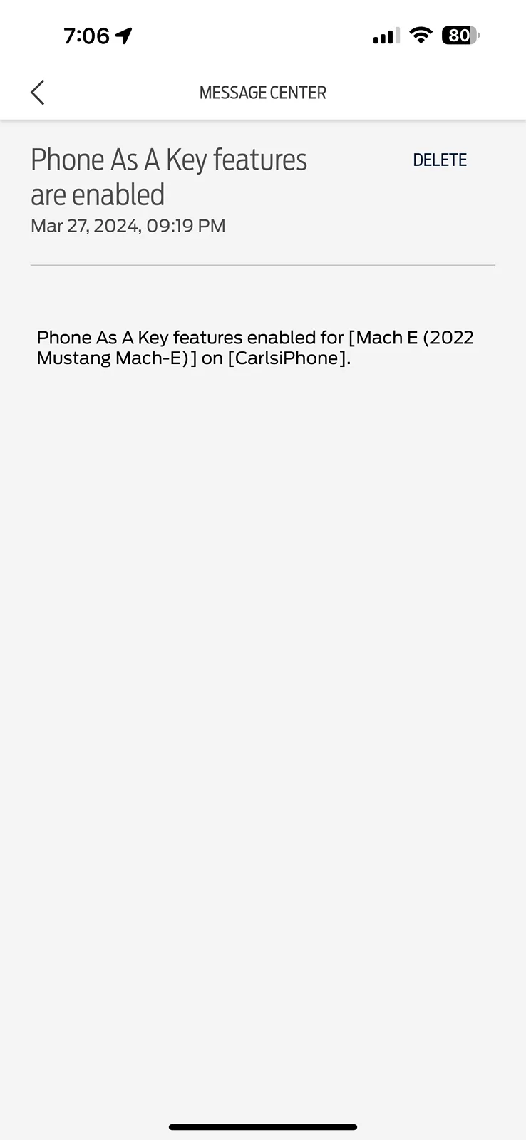

thanks for the reply. Every time I go through the process an email and this from Ford Pass
Ford Mustang Mach-E PAAK stopped working IMG_4436

Go into fordpass-vehicle-features & settings-paak key settings and delete your phone. Wait until it deletes(may take some time). Clear cache and data from the fp app. Open fp and redo PAAK. I've never reset from the car since this method has always worked for me.
Thanks. Tried that too. No progress
