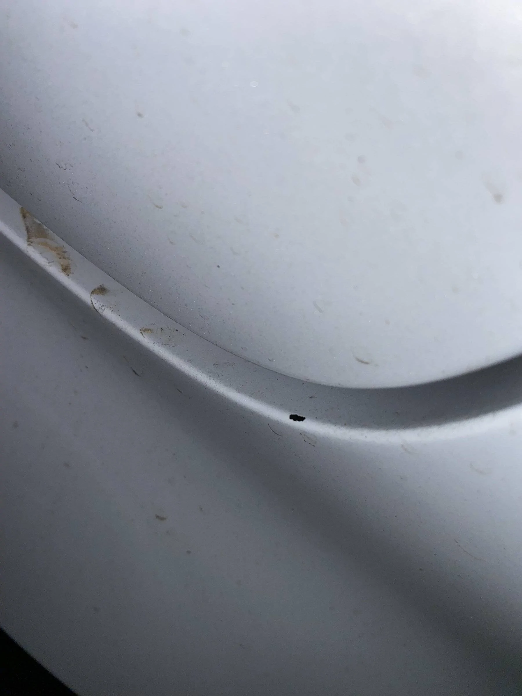

Hi all,
Driving down the A11 today by Thetford, I received a nasty stone chip on the front passenger door, can anyone recommend a good paint touch up kit that I can buy?
Shadow Black colour.

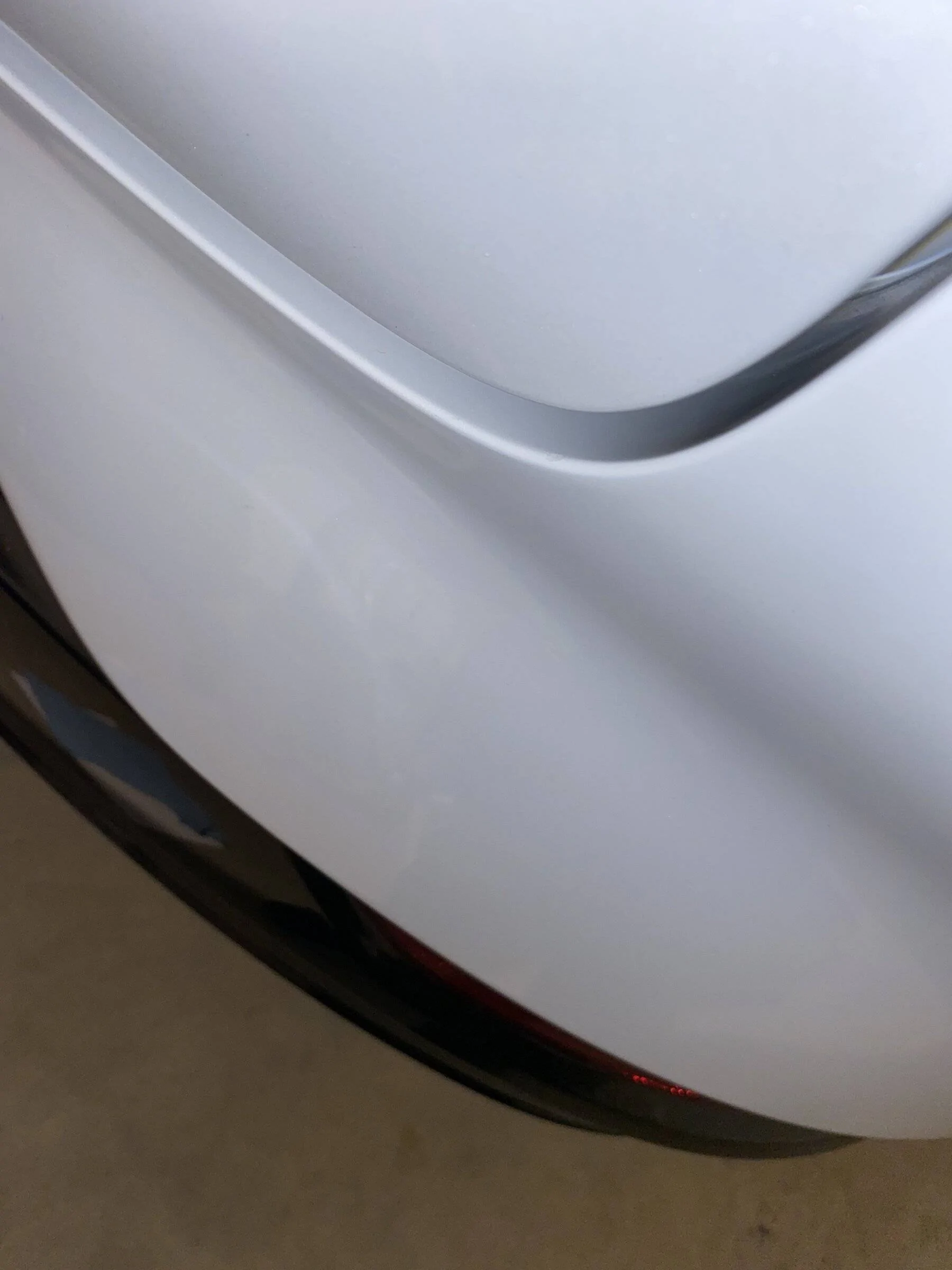

It won't be perfect. I would avoid those applicator pens. Any factory paint will need factory clear as well (which comes in those pens).
I would recommend Dr color chip as it is a single stage paint (no clear needed) and a little more runny which allows you to fill in the hole easier. You can also use their solution to remove the paint and try again. Its perfect if you're a noob.
Whatever paint you go with you're going to need precision. For that I recommend a fluid writer pen.
https://www.amazon.com/Gold-Label-D...er+Paint+Applicator+Pen&qid=1654296868&sr=8-3
You drop the paint in the top and just dab it on the stone chip. Any repair that can't be seen from 5 feet away is good in my opinion. If you explore youtube videos you will find people using the fluid writer method.
