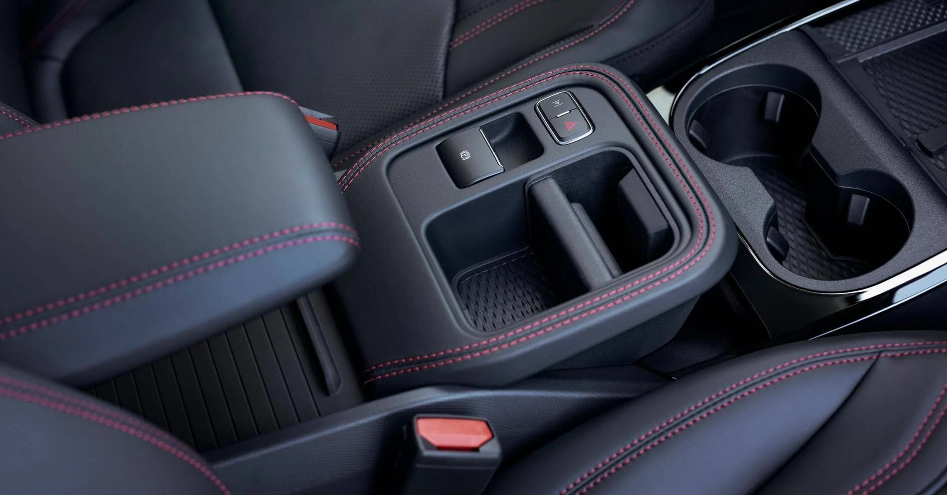

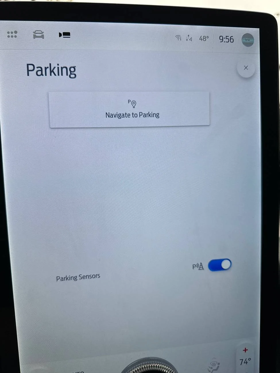

That’s what it does in my 2024 MME. I didn’t realize that this was previously a park assist function. I thought it was dumb that they dedicated a full physical button to opening parking lot options in the Ford Nav.
Honestly it is very frustrating. If they went to the trouble to re-map the button in software to do something else, why not make it actually helpful or configurable. I would love it if the button simply activated the front cameras/360 view.
the auto cameras work pretty well but yeah an easy physical button to turn them on on-demand would be infinitely more useful than parking spots on the nav which usually tell me to go to a Wendy’s or something.

Has anyone gone down the useless park assist button In a while? Wondering if anyone has done any forscan mods to remap that button do something remotely useful
It would be ideal for Ford to make this a shortcut to bring up the cameras - for....parking.
