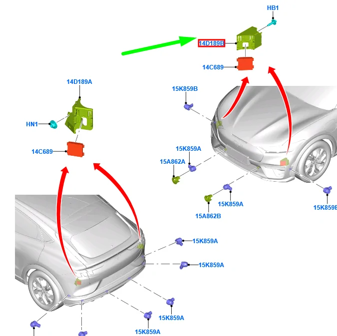

What side sensors? All the sensors are active at all times.
The APA delete cars are missing the linbus chip that drives the 4 side facing ultrasonics. That's why it's missing as the side sensors have no communication. It's a $1 little chip that's missing.
Those are blis radars and NOT used for APA. These are the dead sensors in non-APA cars
