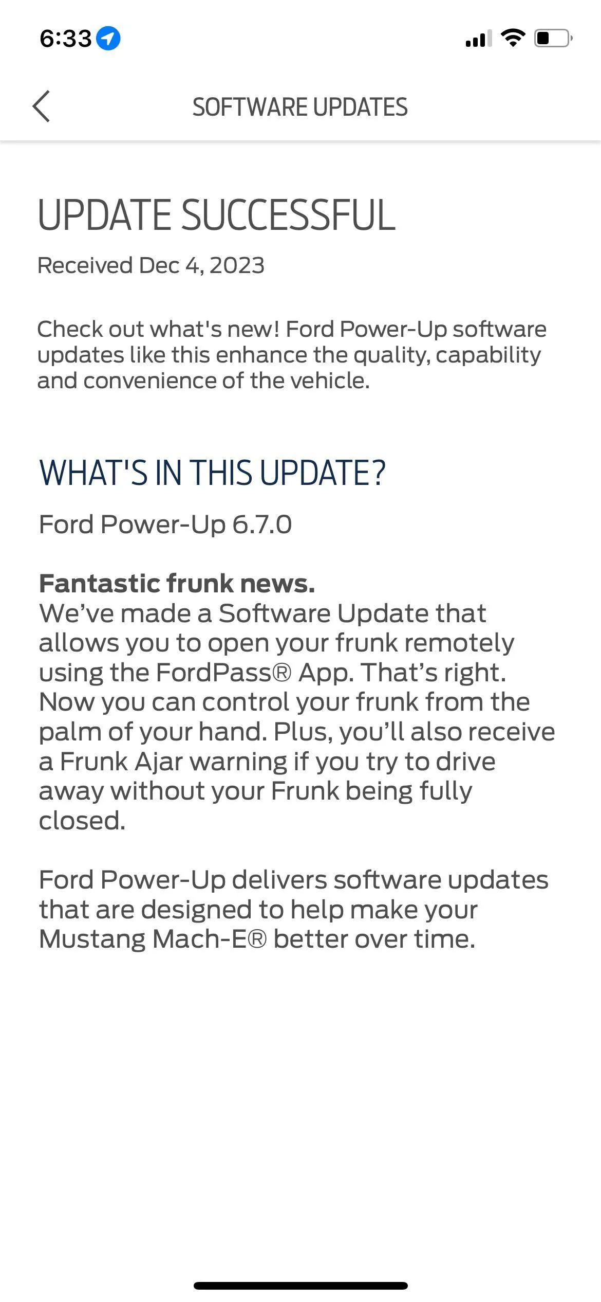

Just received 6.7 as well
Ford Mustang Mach-E Power-Up 6.7.0 IMG_3221
505
14,330
28,706
We're expecting FordPass and Keypad functionality even without a BCM update? Presumably we should also be able to run the routine to enable the button in sync if feeling impatient.

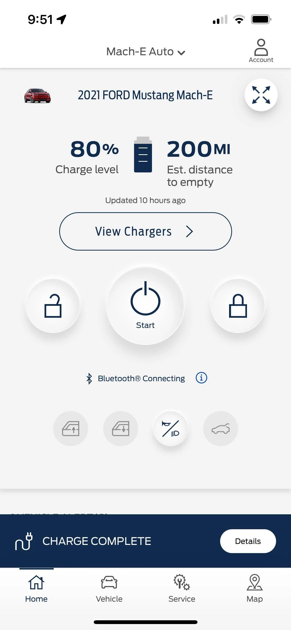

Update to 6.7.0 last night on the '21 First Edition.
But no Frunk button on the app. I did kill and re-launch FordPass. Does it take something on Ford's back-end before the app will show the button?
6.7 just added the functionality to the car. Now you have to wait for the Ford servers to re-inventory your car before the button will get added to FordPass. The next update will probably push that along.
