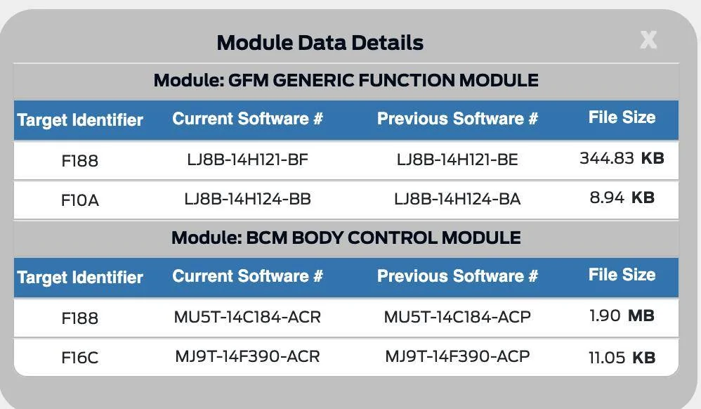

So I missed this earlier, but on some vehicles 6.7.0 also updates the BCM (Body Control Module), which is significant because this is the first time I've ever seen a BCM OTA! That took a little while (3 yrs).
Ford Mustang Mach-E Power-Up 6.7.0 Screenshot 2023-12-08 at 9.53.07 PM
The BCM is important because it communicates with the 12V battery BMS while the car is off, and determines when it will wake up to recharge the 12V battery. I believe the minimum recharge threshold was increased from 30% to 40%. This will hopefully improve 12V stability for those vehicles running original BCM software. A step in the right direction. This means further 12V charging improvements can be easily deployed in the future, no longer being a taboo module to OTA.
This is the same BCM software I flashed back in February.
