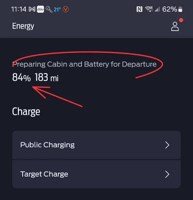

It's 21F and when the car reached 84% SOC, FordPass reported that it no longer was charging, but rather it switched to "Preparing Cabin and Battery for departure"
Ford Mustang Mach-E Preparation needed for extreme cold weather Screenshot_20250121_231412_FordPass
Note that 84% is just short of 85, AND it's 11 hours before departure!
I checked the EVSE, and sure enough it was pumping out 6.7KW (28A/240).
So my question is, because the battery was so cold-soaked, and the car is plugged in, is the BMS heating up the HVB even though technically it has ample time before it had to before 10:am?

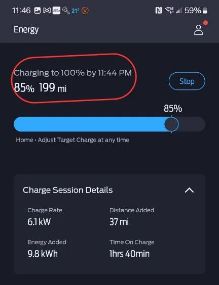

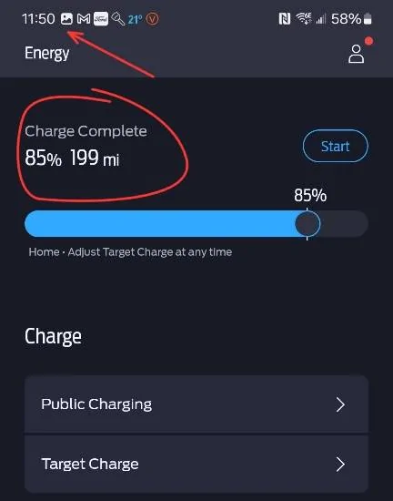

Also note, about 45 minutes of drawing current for "Preparing Cabin and battery for departure", FordPass switched back to Charging mode, but erroneously stated the target was 100%. However, it stopped charging five minutes later after hitting the real target of 85%

It's so cold outside that I'm not going out there to do an OBD check on the battery temperature, but I believe the battery was in fact being warmed and the GOM increased as a result.
But it was interesting to see the BMS and thermal management switch from charging the battery, to heating the battery, and then back to finishing the charge session.

Yes that's normal battery heating. You've probably never seen that before outside of departure times. I have a hair dryer for when things get frozen shut. You need to run remote start to defrost things before you try to move the car if it snowed. We also like to park in garages instead of outside for obvious reasons.
It was -20ÂşF yesterday so 21ÂşF isn't bad.
