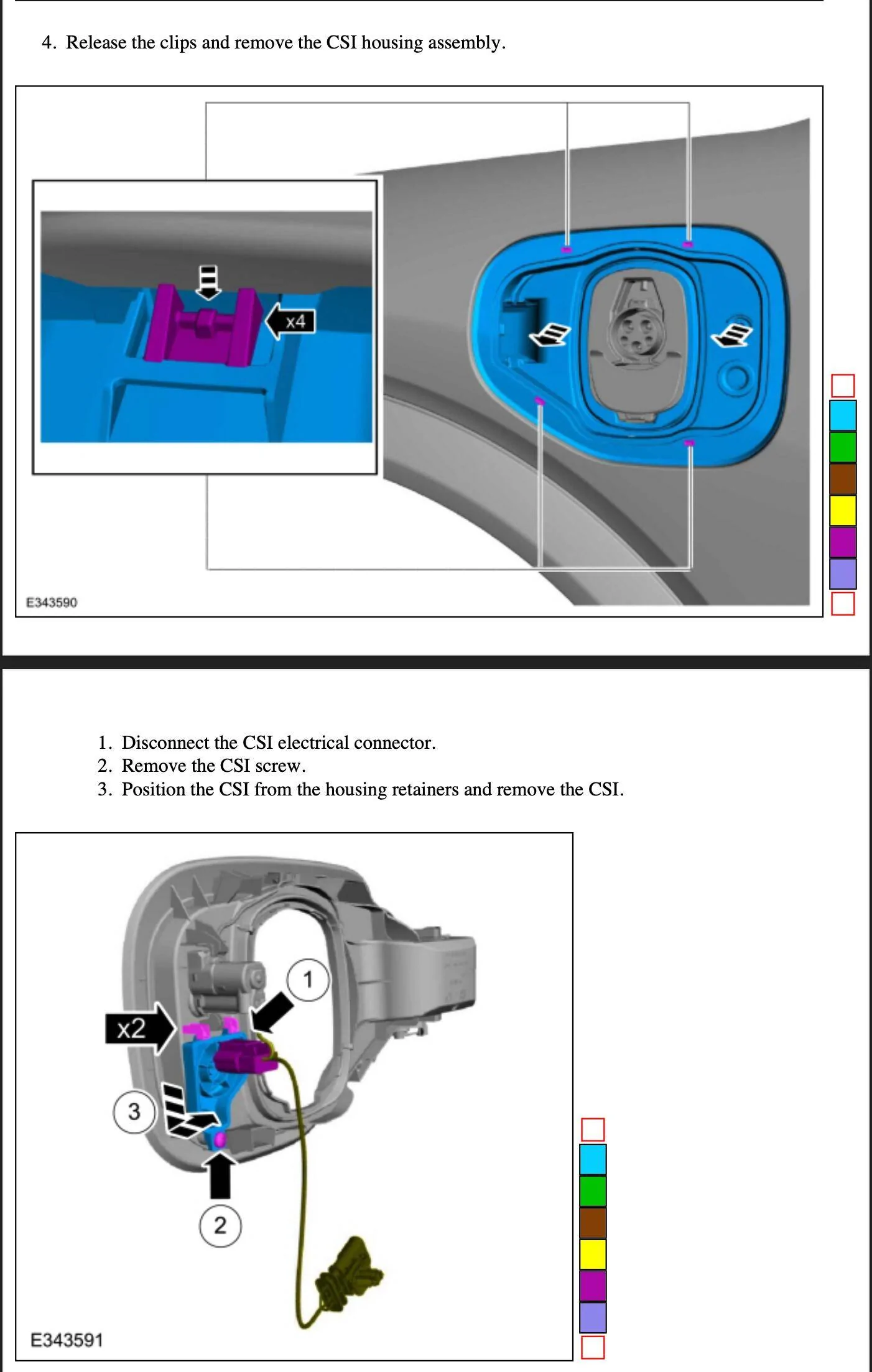

The door assembly clips in. I'm assuming the way the hinge is it's just a pin that slides in a track. The door pin it's self doesn't look like it could be adjusted unless you slightly worble the hole out and move the door pin it's self.
Does anyone managed to to release the 4 clips on step 4 from picture above? Any tips?
There is one detent clip. There are four feet that ride in a channel. The channel holds the cosmetic door on the hinge. The detent clip prevents the cosmetic cover from sliding out of the channel. ??
EDIT: Still thinking of the door cosmetic cover in the title. My bad. The clips can be accessed with the frunk tub and beauty panels removed. I haven’t done it myself but from what I remember of having everything else out, a small plastic pry tool should work on them. I will have to experiment, but it won’t be soon. ?‍♂?
The 4 clips im mentioning is the internal one that holds the charging door hinge not the one the ones that holds the external cover.
