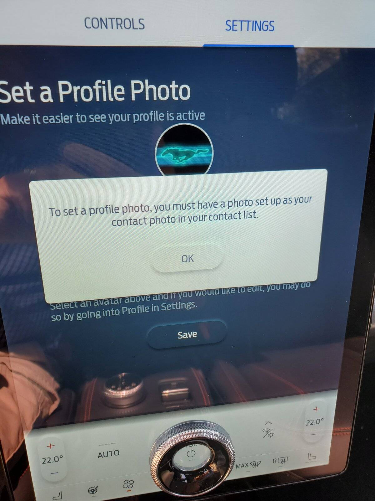

In earlier (last year) video reviews, the display showed a picture and name for the profile user at the top of the central display.
I've tried to change the standard avatar icon to a picture and the instructions say to use my picture from my contact list. Which list? The ones (I have 2) on my phone (Samsung 10+ Android) don't show up. Is there a contact list internal to Sync?
Any suggestions or experience in changing the photo in the avatar setup?

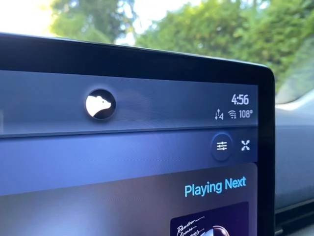

I set up my profile initially from my computer, logged in to my Ford account. It allowed me to load a photo from my computer.
8,580
15,988
I used the Remote Vehicle Setup option in FordPass to upload my photo. After many failed attempts, that eventually worked for me. ;)
Others have been successful getting the car to load the photo from their phone's contact list. They might just be iPhone users though, I'm not sure. I'd recommend verifying a few things:
  • Your contact for yourself on your phone is assigned the same email address as the one you use with FordPass.
  • You've given the vehicle permission to read your phone's contact list.
  • You're connecting to the vehicle via Bluetooth and not Android Auto.
This worked perfectly on two Android phones for me.
