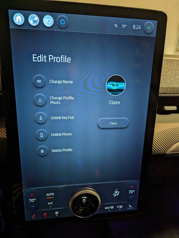

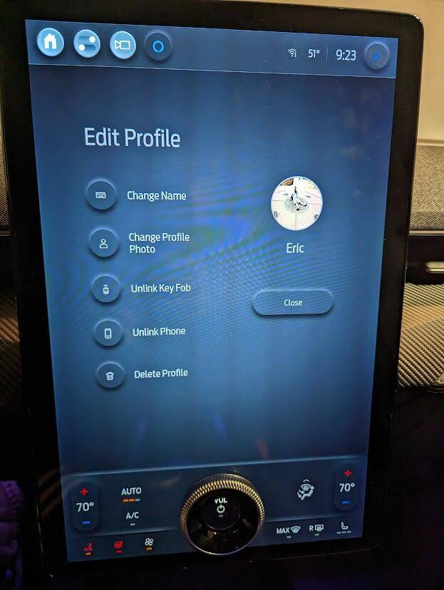

Regarding first step: The buttons on the door work as expected without any key in the car (side note: I did trigger the car's alarm).
Regarding second step: I turned my phone's BT off and used just the fob. The images below show that both profiles have fob and phone linked. I toggled back and forth between the profiles, and it adjusted the seats when I did so. I left it on my wife's profile, exited and locked the car, unlocked the car, got back in, and upon turning it on it changed to my profile and moved the seat to my position! Because BT was off (and I don't currently have access to my wife's phone), I couldn't test if it would have switched from CarPlay to Android Auto.
So is it something with the PaaK?
