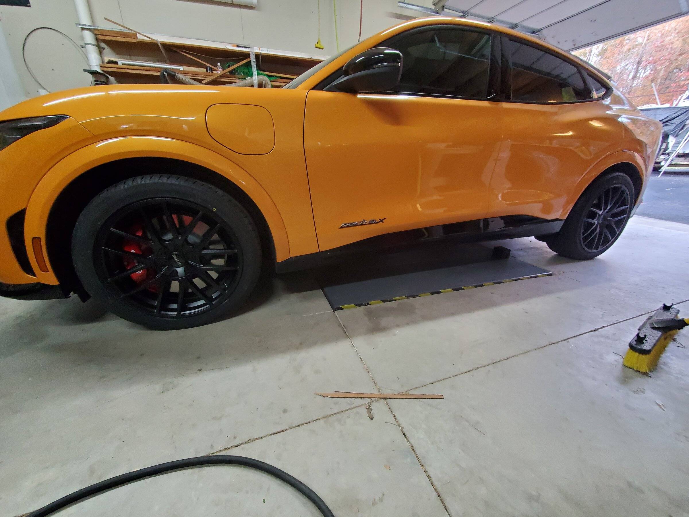

I have something similar and lifted with no issues - sorry no pictures of it actually in the air.
Ford Mustang Mach-E QuickJack with MME 20211111_161115
