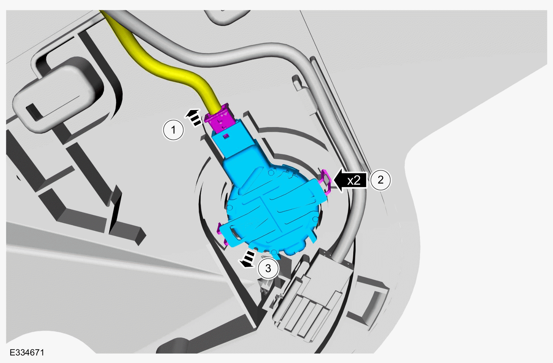

I have an appointment Thursday to have them look at this, as well as to review my cas for my charging fault. How does this look to you?
That's your problem, no glass contact. Sensor needs a new gel layer or replacement.

GM used to sell the gel pad separate from the sensor. No idea if they still do, or if Ford does.
