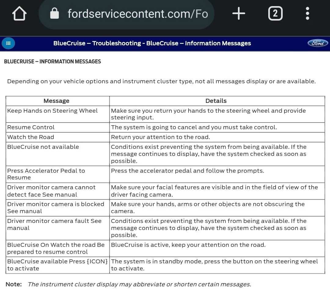

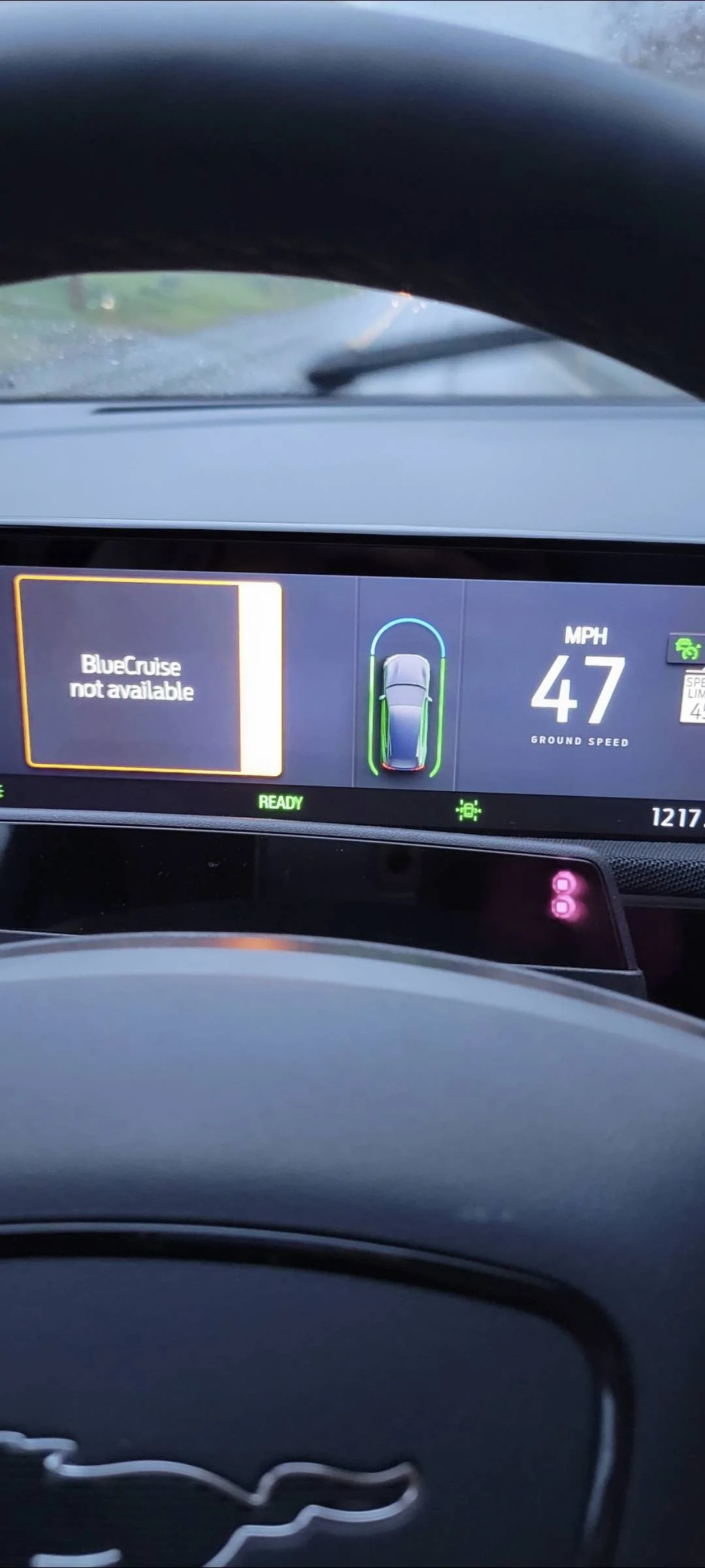

I had my dealer install bluecruise after the 1.7.1 debacle and all updates were applied. Test drove the vehicle on I-95, set cruise control and activated lane keep and received the below message on my dash - anyone have experience with this?
Went back to service and they scanned my vehicle, received a couple non-communication error codes that "come up all the time on other vehicles" so they weren't convinced it was related
Ford Mustang Mach-E BlueCruise Not Available message - anyone else? Screenshot_20220503-161420_Gallery
Ford Mustang Mach-E BlueCruise Not Available message - anyone else? Screenshot_20220503-174015_Chrom

How hard is it raining? BC can be disabled if the primary camera can't see well enough.
Good to know. Light drizzle when I was trying in the picture - after a moderate downpour.
