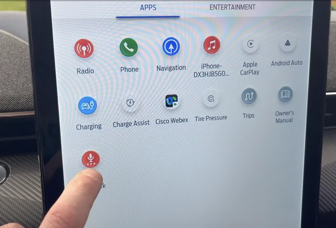

I just got the low 12v message. Where is that feedback app? Is it in the fordpass app or in the car itself? If it's not on the fordpass app, there really should be one there.
That reminds me, I swear I got an email about ford creating an online forum for feedback...
The feedback app was part of the 6.2 update . The app is on the app screen . Has a microphone icon
