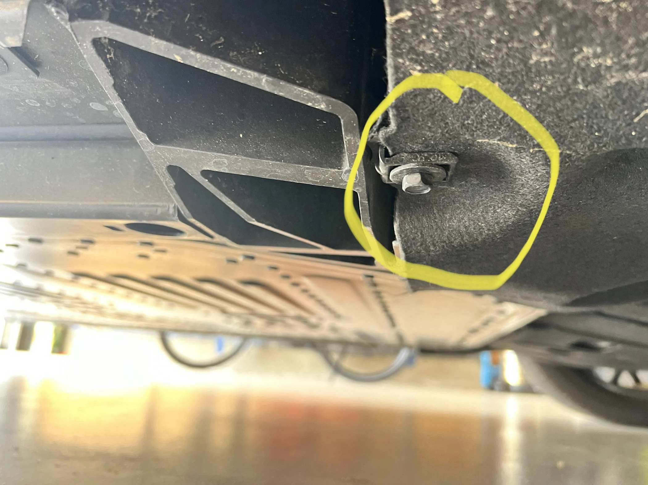

I’ve found out what causes the rattle! Can post some pictures or videos tomorrow if anybody is still interested…

I’ll keep you updated tomorrow when I’ve tried to fix it. It’s definitely coming from the underbody of the car. Just didn’t had my phone/camera with me when I was checking this afternoon.

This is the area causing the rattle:
Important: it’s not the bolt itself being lose.
They seem to be to long. The rattle comes from underneath the panel.
Ford Mustang Mach-E Cross wind rattle ... Anyone else? 0BE340E2-6DFD-4D27-9D15-C5E8B9263497
It’s on the right side underbody behind the front wheel. By tapping on it, it clearly was rattling while the same part on the left side wasn’t. Tightened it just a little bit and knocked a few times all around that area and guess what… the rattle is gone. I think my „solution“ will be temporarily and the bolts need to be replaced with shorter ones.
I will take it to the dealership to get that bolt replaced. Maybe it just wasn’t tightened enough or the bolt is to long or has some kind of defect. Or it’s a misaligned part underneath the underbody panel that’s know „back in place“.
Anyone with that issue…try it yourself by tapping on it or let you’re dealership check it and tell them to check that exact spot.

This is the area/bolt causing the rattle:
Anyway… will take it to the dealership to get that bolt replaced. Maybe it just wasn’t tightened enough or the bolt is to long or has some kind of defect. Or it’s a misaligned part underneath the underbody panel that’s know „back in place“.
Let me know how things were going.
So glad that this is gone ?
That bolt is not loose on mine.. sad day! I was hoping for an easy fix. For me, the noise only occurs at higher speeds which makes some of the earlier theories about wind causing the noise seem plausible. It's almost like a piece of metal flapping/clanking/rattling. The noise on my car is on the driver's side under the steering wheel and somewhere near the door. The bolt was close to that area so I was hoping that was it ?

Sad to hear. But don’t give up too soon ?. The noise on mine was coming from the passenger side only and also only when going higher speeds with wind hitting the car from the side. If I were you I would let the dealership check it anyway.
The bolt on mine wasn’t loose too, but somehow caused the rattle underneath. So I would say that the bolt not being „visibly“ lose, may not mean that the cause of the rattle isn’t in that spot.
What happened to the passenger side could have happened on the drivers side too. Did you check if any rattling occurs when tapping around that part on the drivers side? I’m pretty sure Problem is the same as mine, only on the opposite side.
End of Story: The pictures shows more like the area you could search in on both sides as the both bolts on my GT seemed very well tightened.
I’ll keep you updated when I’ve visited the dealership. Maybe I can take some pictures from underneath. I guess that is where the metal is, which really causes the rattle
I tried to tighten it just in case. Mine doesn't tighten and just spins. It seems like it's in a piece of plastic not metal.. ?

It definitely shouldn’t be spinning.
If it’s spinning it means it or something is not tightened properly. Looks more and more like wrong bolts have been used. I’m sure it’ll be gone if you have the bolts replaced.

I went and checked the bolts on mine and they are tight as can be. So definitely not the same issue for me.

Trust me. Has nothing to with the bolts being tightened or lose. It’s underneath. They’re to long and due to that seem to can’t provide enough pressure to give hold to what’s underneath it. Can’t lose if you give it a try. Will try to get some pictures as soon as it’s fixed by the dealership.
My description was a bit misleading by referring it to the bolts.

Interesting. I noticed a periodic rattle in the same general area on my GT and (the plot thickens), it first showed up after my front air dam was replaced by the dealership (the car was originally delivered with a badly scratched air dam). I wondered how a replaced air dam might cause the rattle, but I think I now know! ???

In your original post you said twice that it needed to be tightened. Now you say it has nothing to do with tightening? I'm confused. The bolt is too short? It's purpose is to attach the liner, I don't think length matters.
If you are simply stating that it's because you tap it and you can hear the same type of noise, well there's a million places that myself and @Scooby24 have tapped and found the same noise and figured "aha this has to be it" only to be disappointed in the long run.
It could very well be where you are saying, I'm not trying to discredit that. But you have to provide a way to fix it, which you said was by tightening it. You said that tightening it fixed it. I can't tighten mine as it's all the way tightened. So, I'm not sure what you're instructing everyone with this issue to do. If it's "Bring it to the dealer" I'm afraid we'll have a lot of dissatisfied people because the dealers are about as smart as a box of rocks.

I’ve said a tightened it a little bit. And I’ve said that only once. I also said I’ve knocked around that area a couple of times. Didn’t meant that the tightening part is the actual solution. I already said in my original post that it comes from the area underneath the bolt.
Maybe it’s s little more difficult for me in English as it’s not my native language.
Just trying to help you guys.
