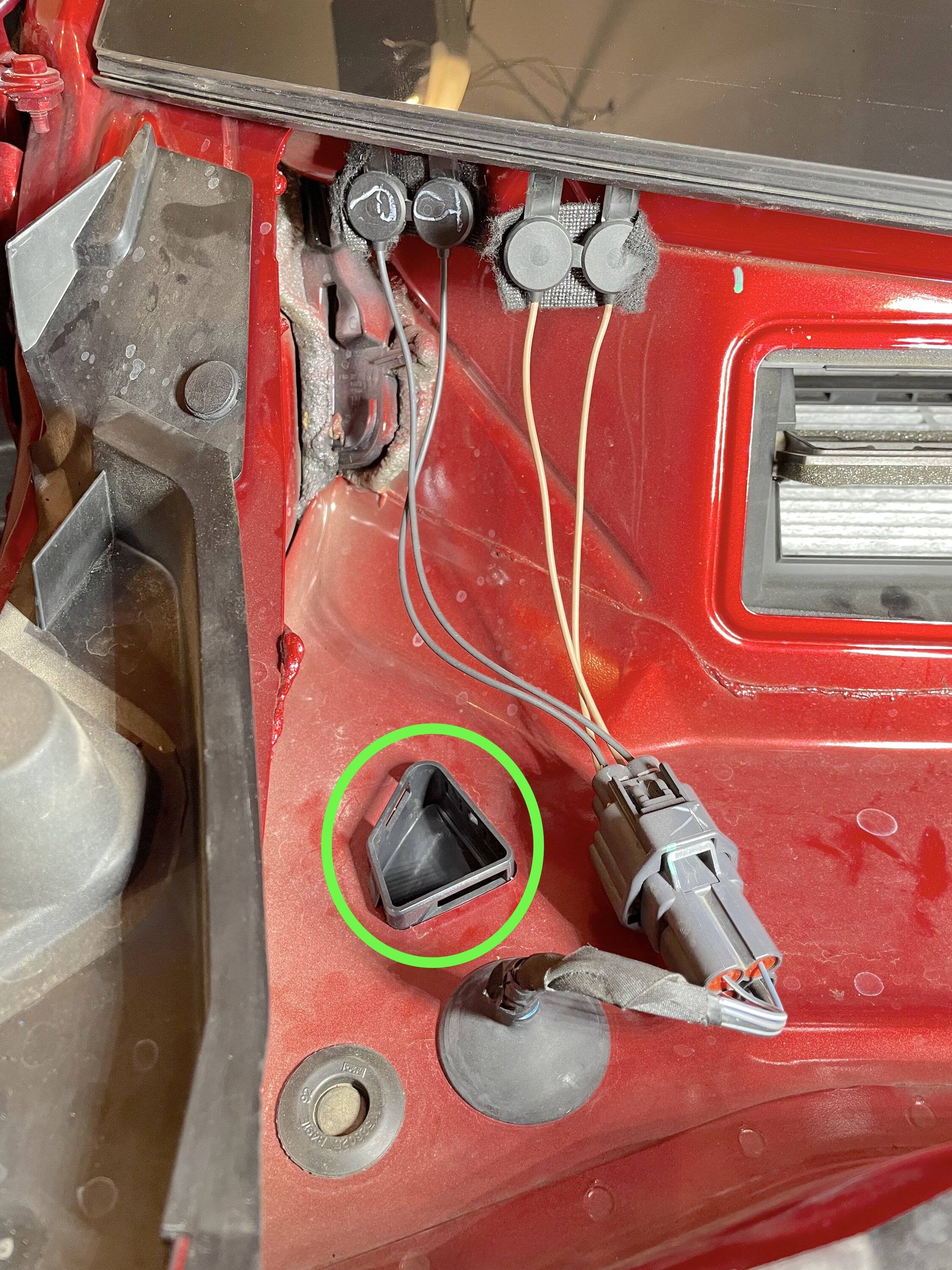

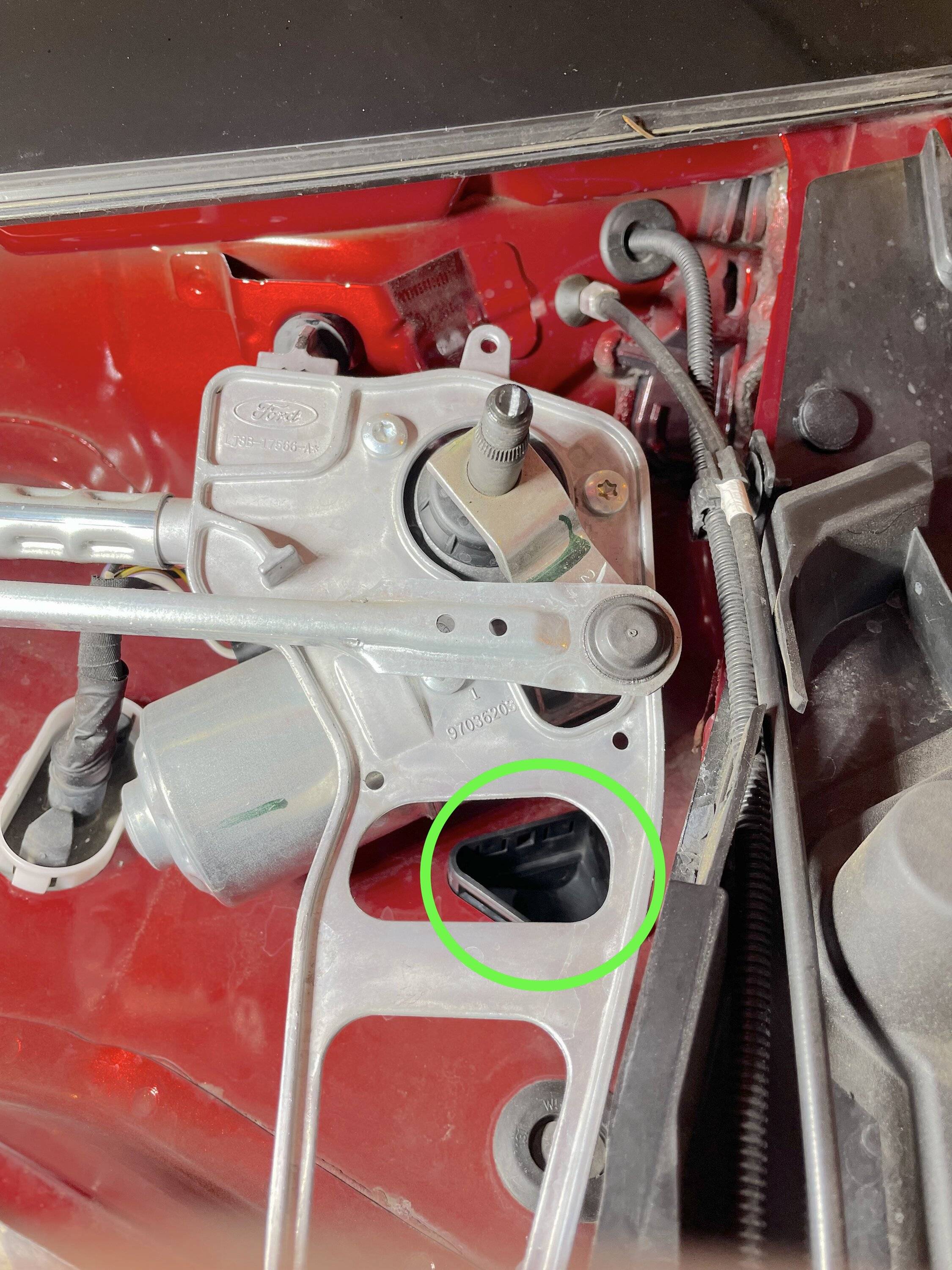

Well I think I may have come across the source of the crosswind rattle, it's probably the cowl drains (see video). There's one on each side:
Ford Mustang Mach-E Cross wind rattle ... Anyone else? IMG_2044
Ford Mustang Mach-E Cross wind rattle ... Anyone else? IMG_2045
They allow water to drain out of the cowl. They have a a check flap, likely to minimize the amount of air that gets sucked into the HVAC from the wheel well. But in a crosswind situation, I could see the downwind flap getting blown open and the upwind flap getting blown closed.

YES I think that's probably it. I also haven't heard it anymore and it would make sense to me that as the part gets dirty the tolerances probably tighten up a hair to the point it doesn't rattle anymore.
