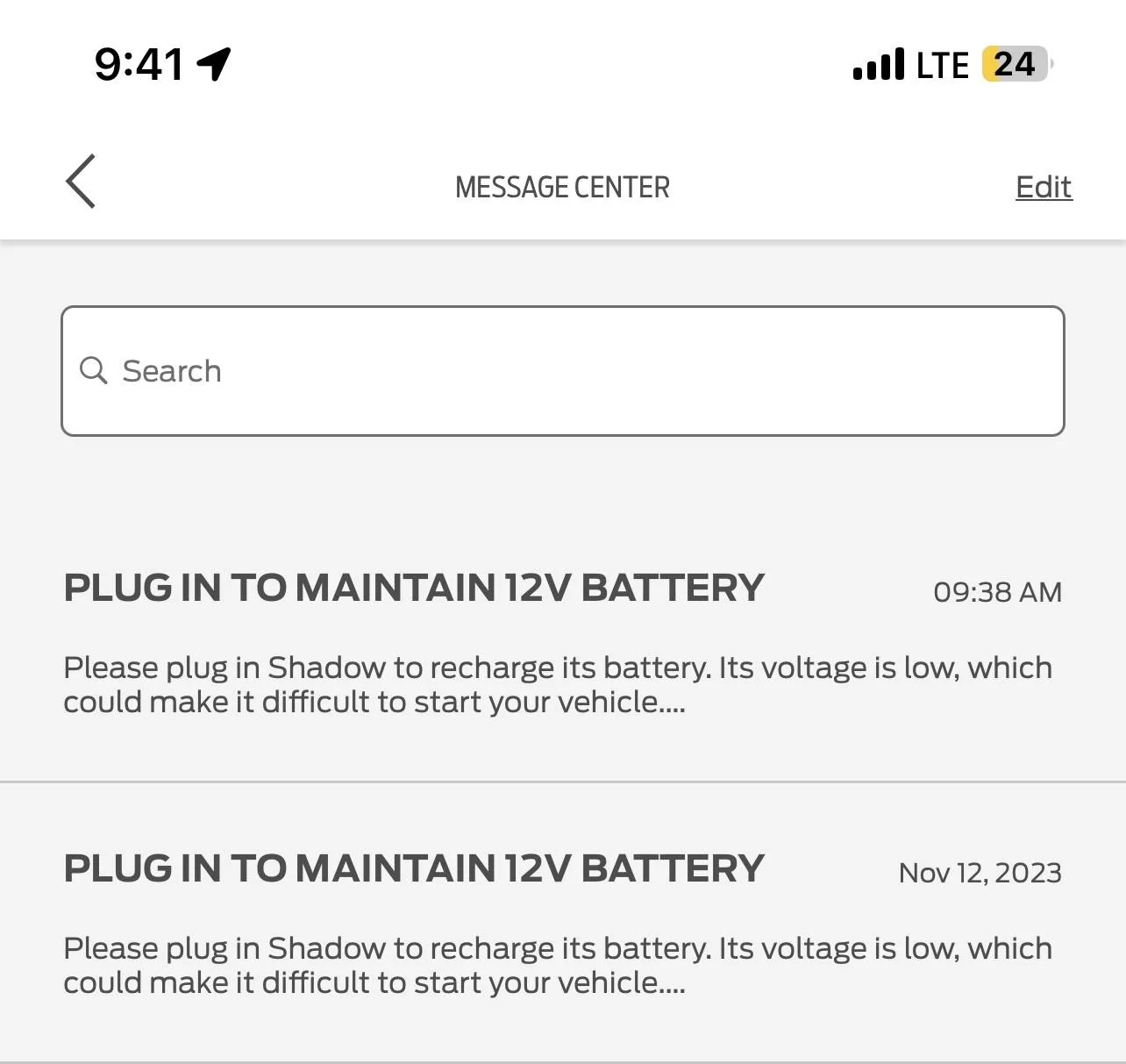

I don’t think it’s just a coincidence that the 12v batteries are now 2-3 years old and we have a ton of these threads popping up.
I don’t remember this being an issue in the last few years.
My guess is a lot of people have 12v batteries “on their way out.” And the car is just warning you that you have to charge it more often.
It matters because a dead 12v can leave you stranded and in need of a tow. Not just a simple “get a jump start from a friend” and keep driving situation.
That doesn’t seem right. @Ford Motor Company was quite confident that the 12v battery would never need to be replaced, which is why they made it so hard to access.
I have also gotten the System Off To Save Battery message several times in the past month. Also one instance of audio amp freak out.
My car is at about 32 months and 40k miles. I drive it almost every day. Usually only for 15-20 minutes at a time a few times a day (commuting and errands and stuff) but a longer road trip once a month or so. I have no accessories plugged into my car and I’m not leaving lights on. It is parked overnight in a garage. I charge it twice a week, keeping the HVB between 30 and 80%.
