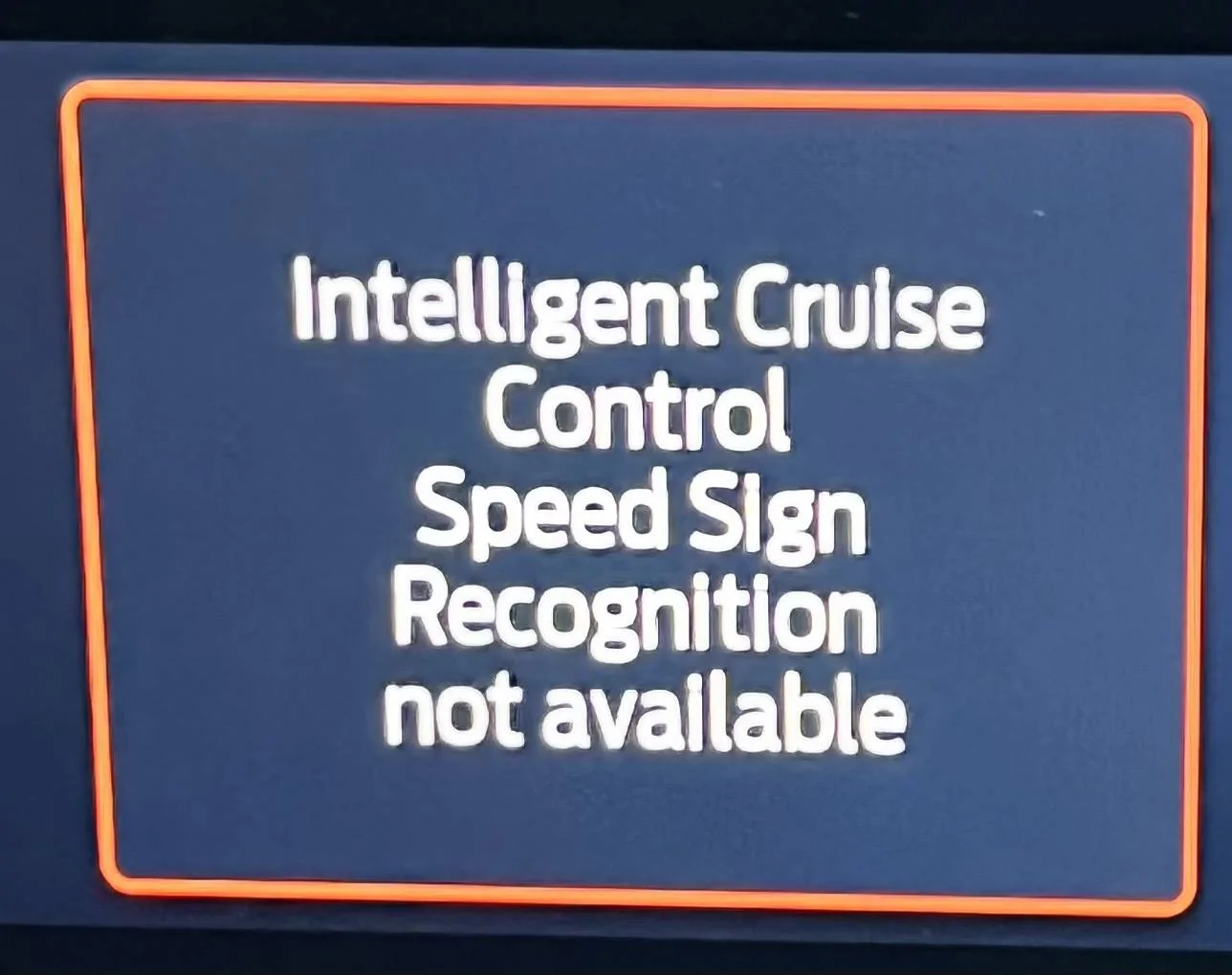

Speed Sign Recognition Not Available, anyone else?

I’m sure they won’t have a problem doing the TSB install. But I’m not sure if that includes updating the whole thing to 1.7.1 or not. We’ll see. ?
The only update included in 1.7.1 is for Sync (APIM module). That TSB will bring Sync to the same version, but you won't see any reference to 1.7.1 because that's just the numbering scheme for delivering it OTA.
Rod, If you get down to the Utica area, you can use my FDRS rig, but the whole update including sync 4 takes at least an hour. -Joe
@louibluey You assume I have way more talent than I do. But Thank You for the vote of confidence.
Sounds like you are all set with the dealer, but if you need anything MME programmed, and get down this way, I can show you how. The bigger problem is probably the two hour drive, and time to do the update. Some take 5 minutes, others like Sync 4 over an hour.
I can tell you that it does not ;)
