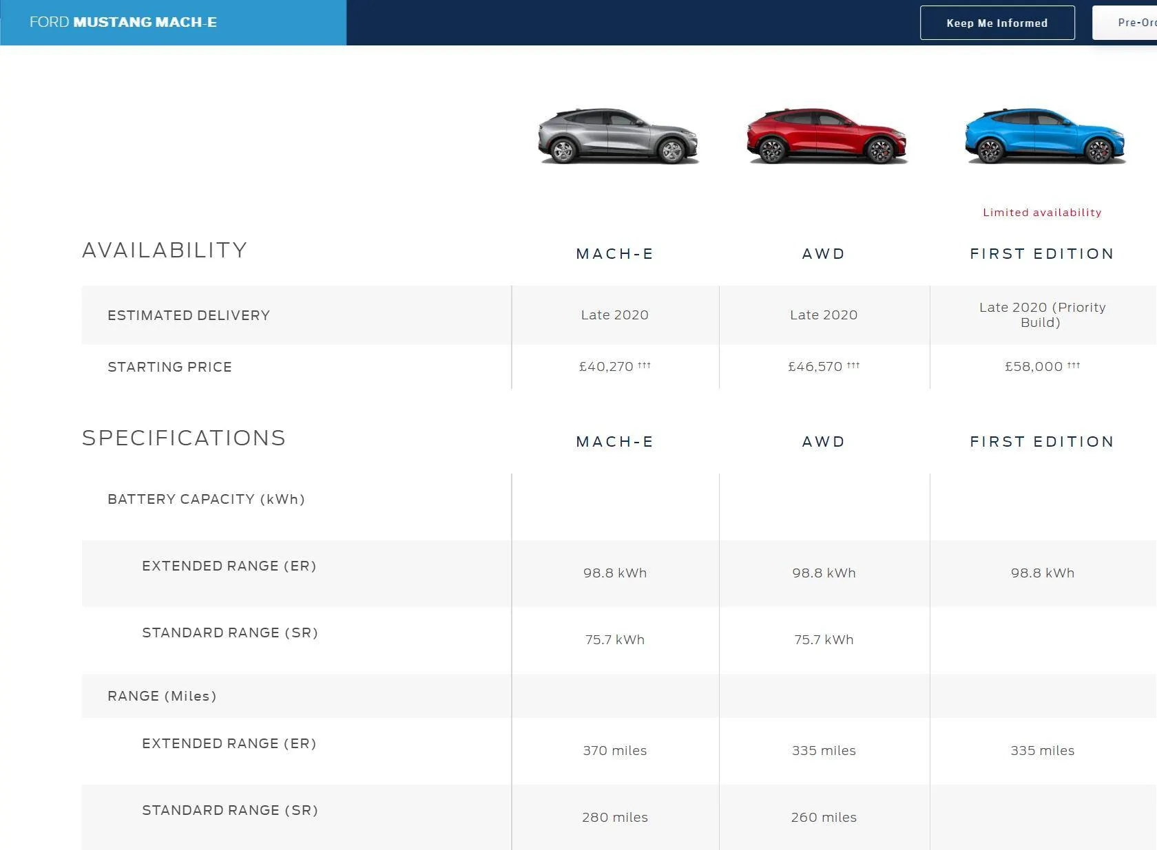

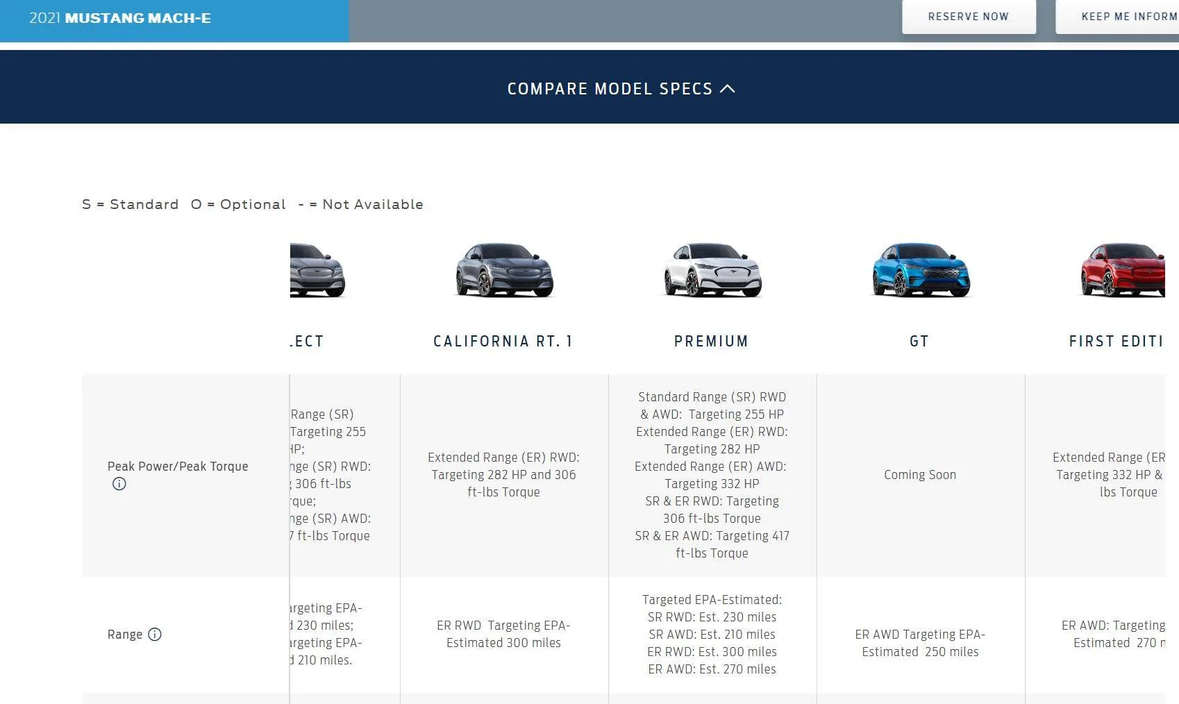

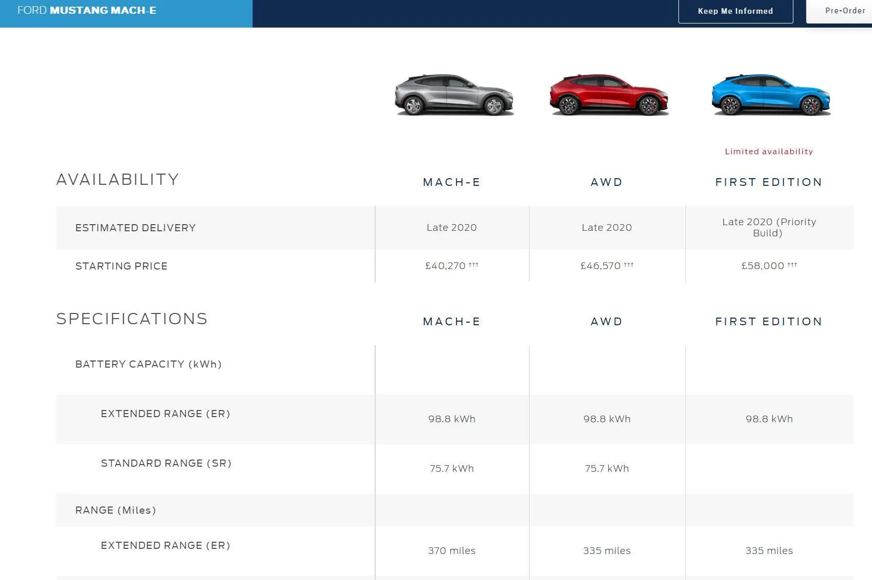

Not sure if this has been brought up by anyone else.
It looks to me that the UK Ford site has posted different range capabilities than the US site. Screen grabs are included, but in summary: First Edition = 270miles on the US site vs. 335miles on the UK site. This translates through to the other models too. Maybe I'm missing something - if so, let me know. Or maybe the range will be much better than anticipated!
(I apologize for the crude screen grabs. )
UK: https://www.ford.co.uk/cars/mustang-mach-e
Ford Mustang Mach-E Range better in the UK?! UK Mach E
US: https://www.ford.com/suvs/mach-e/2021/
Ford Mustang Mach-E Range better in the UK?! US Mach E

Probably goofy WLTP numbers.

And here I thought I was onto something special.
Not sure if I understand WLTP, outside of it being a different conditions to conduct range test.

The EPA test contains a larger component of freeway\motorway driving than the WLTP test which is less efficient than city driving. The difference between the two values seems larger than usual however so I hope the EPA figure is an underestimate.

Don't know about WLTP, but EPA highway ratings for passenger vehicles use are already based on a too-low speed. I read that they're based on a 55 MPH average. That's too slow for US highways, especially for BEVs where the efficiency drops precipitously as you go higher.
But for city driving it could very well be pessimistic. For the "300 mile" Mach-e ER RWD, my guess is it'll be more like 340 for slow speed city (@favorable temps), but more like 220 on the interstate at 70+ MPH.

It is. Even says that in the footnotes. (Well, not the "goofy" part, but it might as well.)

I am in the UK and I tell anyone interested in buying an EV to check the same vehicle if available in the US as the published numbers are much nearer the likely range.
Our numbers are an EU specified test and it is pretty unrealistic.

Yes, I’m also a UK Mach-e owner with over 56,000 miles on the clock so with significant experience of performance, range etc so I can share with you that the WLTP figures can be put through the cross-cut shredder. Optimistic is too charitable a word for WLTP, they are woefully inaccurate and unachievable. My experience is in the best conditions possible c270miles range is about as good as it gets. Sure, you’ll see photos of dashes displaying ranges around 370 which is only possible after driving history is cleared or came be better than 270 range where A/C, heating etc is all turned off but that’s not representative of ā€œdrivingā€ a car. I can’t imagine any climate or part of the world where range is anywhere near the ā€œpossibleā€ 379 miles, it’s a lie just like ICE mpg figures have always been. So, in short US Mach-e users, you’re missing out on nothing in terms of the range of Mach-e cars in EU or UK. And winter knocks off another c50miles!!
