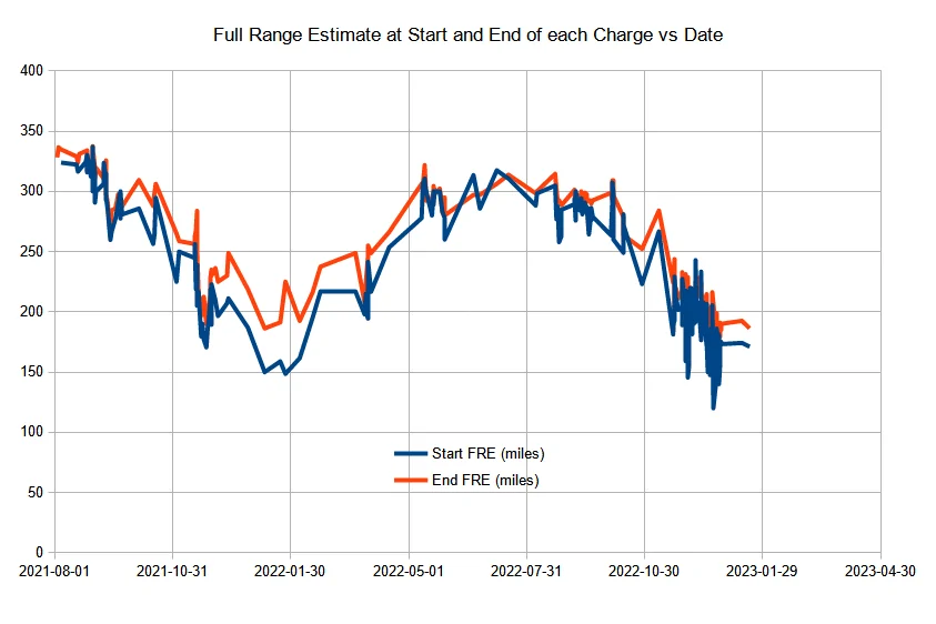

To get a sense of the battery capacity change over both winter/summer cycles and vehicle lifetime, I devised a variable called 'Full Range Estimate'. FRE can be calculated at any time (while driving or charging) by dividing the Range indicated on the Mach-E instrument display by the 'State of Charge' percentage on the same display. For example, if Range is 150 miles and SOC is 50%, then FRE is 300 miles.
From late August 2021 until late December 2022, I have driven over 22,300 miles and charged 225 times. I recorded Range and SOC at the start and end of each charge, and so have two FRE measurements for each charge. FRE, at each charge start and end, is plotted against calendar date in the chart below.
Ford Mustang Mach-E Range decrease due to cold weather / winter! -- Explanation & how to calculate actual range 1674579710902
A seasonal decline in range is evident, with up to 50% FRE lost in winter. Some range loss from battery aging may be indicated by the lower peak FRE in summer 2022 compared to summer 2021. There is also a small but consistent difference with FRE typically higher at the end of a charge compared to the start of a charge. This may an indication of improved (indicated) battery performance due to battery heating during a charge. The higher frequency of charging with time in September 2022 was during a 2,800 mile road trip to the eastern US, and in December 2022 a 7,900 mile road trip from Windsor, Ontario to the west coast of the US.

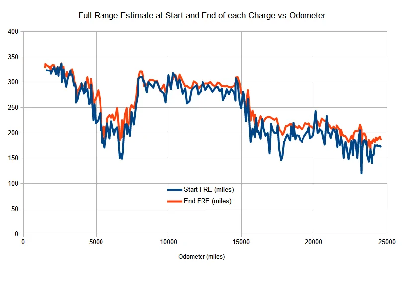

The chart below plots the same data against distance traveled.
Ford Mustang Mach-E Range decrease due to cold weather / winter! -- Explanation & how to calculate actual range 1674579793594
A significant range loss is again evident. The loss is not explained by the distance data alone, but can be explained by independently comparing odometer to calendar date from my charging records. For example, I reached 5,000 miles traveled in mid-November 2021 and 7,500 miles in early April 2022. My road trip in September 2022 ran from 11,600 miles to 14,500 miles. My road trip in December 2022 ran from 16,500 miles to 24,400 miles.
The gradual loss of FRE is also evident in this chart, if one considers separately the summer driving from 10,000 to 15,000 miles and the winter driving from 16,000 to 24,000 miles. The higher FRE at the end of each charge compared to the start is also evident.

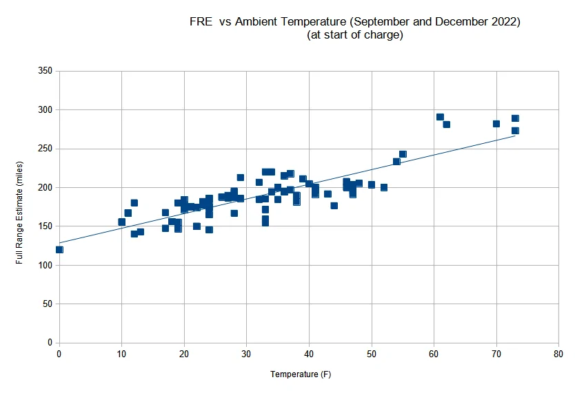

To more clearly define the temperature effect on FRE, the chart below shows FRE at the start of about 80 charges during the December road trip and a few charges during the September road trip. The overlapping cluster of 5 points with temperatures near 70 F are September data. The linear trend-line and its slope were calculated by the spreadsheet.
Ford Mustang Mach-E Range decrease due to cold weather / winter! -- Explanation & how to calculate actual range 1674579888408
The temperature effect can be quantified as the trend-line slope of 1.9 miles FRE increase per each degree Fahrenheit increase. So, if your FRE at 70 F is 300 miles, and you plan to drive in 20 F weather, you can expect to lose about 95 miles FRE ((70F -20F)*1.9 = 95) or about 32% of summer range. That is not an exact value, since there is some scattering in the data.

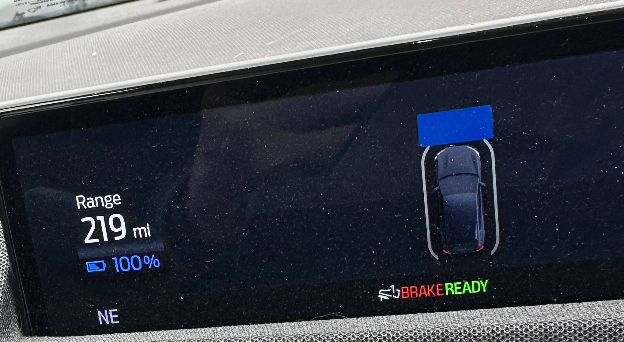

I took delivery of my mach2 on March 17, of 2021 and was one of those newbies that couldn't understand while my standard range was supposed to be 210 miles yet was only getting 156 miles.
I soon learned thru this forum about the GOM and cold weather issues. So to my surprise two years later on March 19th I got 219 miles of range on my last charge.
