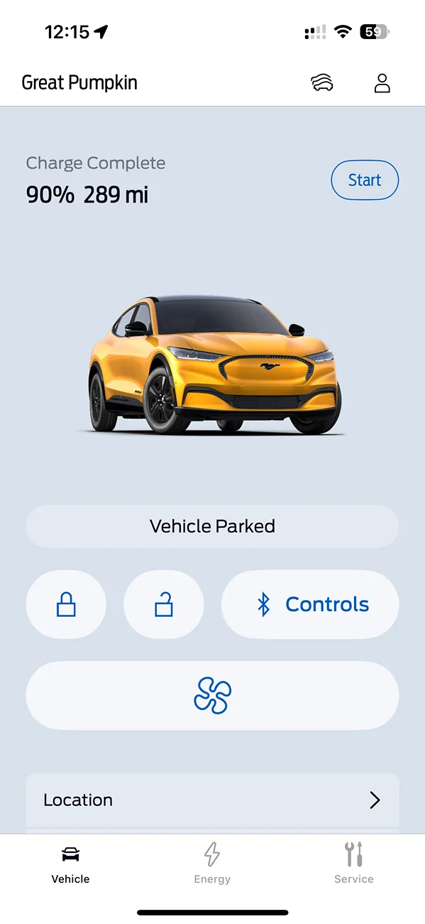

leehinde
Feb 12, 2023
61
825
1,030
Mach-E California Route 1
Just to give you hope. 2022 Rt 1, with 19,000 miles
Ford Mustang Mach-E Range indicator on California Route 1 1719861608780-l6
