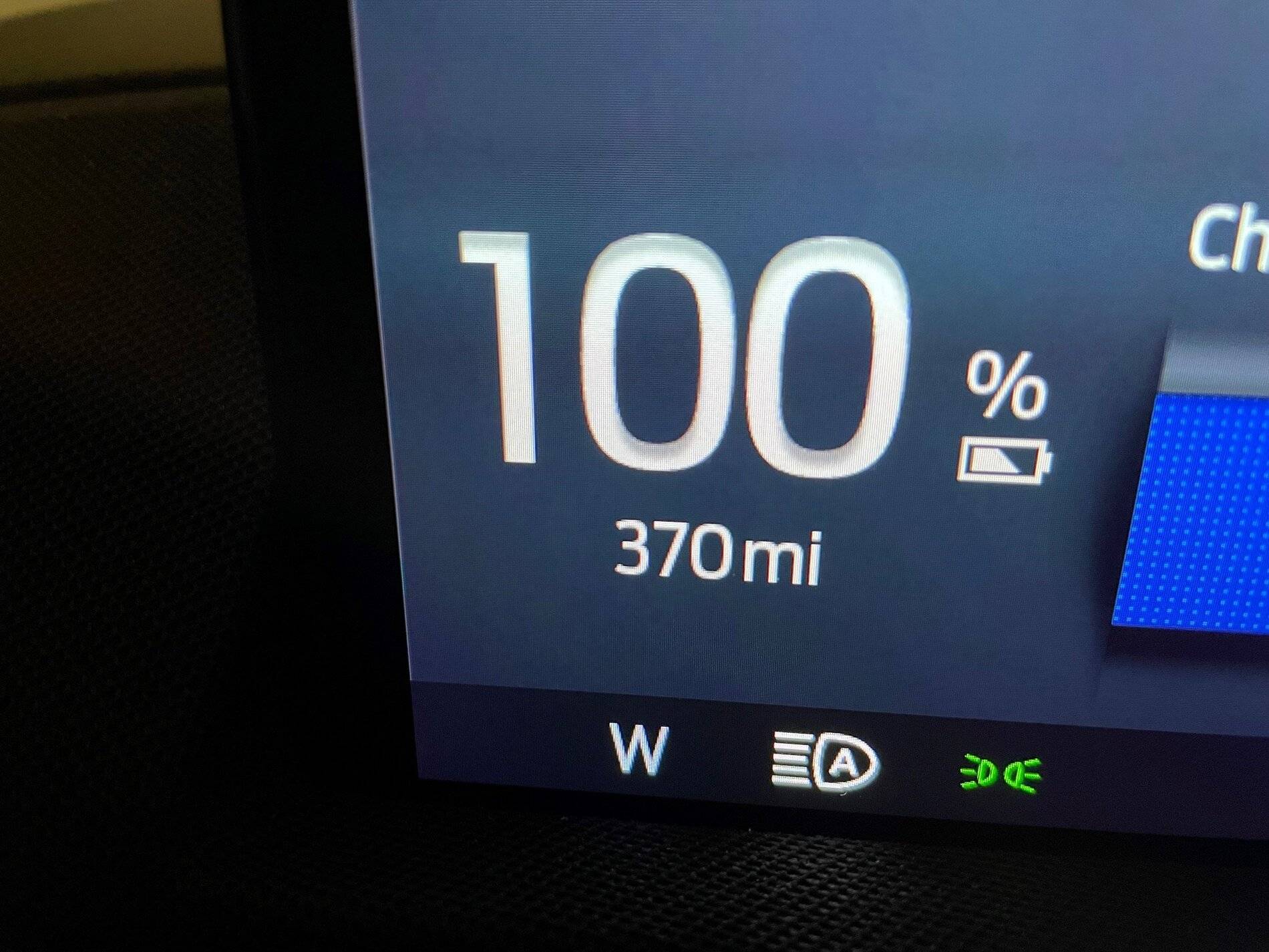

To be clear, when I got the GOM to read 370, I had been doing gentle driving around town. I charged it to 100% to take a trip from Phoenix to Grand Canyon, just under 250 miles. I drove at 75 mph up a 6000 ft elevation change. I reached a charger in Williams Arizona 183 miles away with 33% battery. I had 105 miles range remaining. So the GOM had adjusted for my driving conditions and reduced to 288 miles.
I would have easily made it to the Grand Canyon on a single charge, but there were no DFDCs near the park, that is why I charged up to 80% at Williams. While at the canyon, my hotel had a level 2 and I did top it off, then made it all the way home without any charging stop.
The Mach E did much better than I actually expected on that climb. I had made a trip from Phoenix to Flagstaff in my Bolt, and it would not have made the extra 35 miles to Williams, had to charge in Flagstaff in that case.
As a side note, the Ford Nav told me I could make it all the way with no charging stop. The ABRP app told me I needed to charge in Flagstaff and would only have 20% battery at that point, then it calculated if I charged in Williams I would be down to 13%. It was way off. I have tried ABRP with my Bolt and it is also way off.
