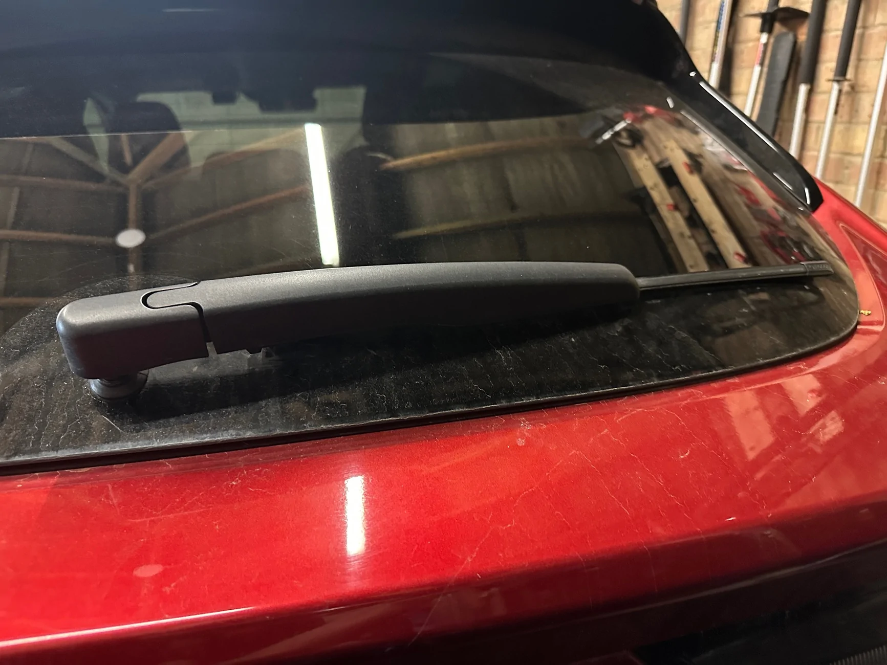

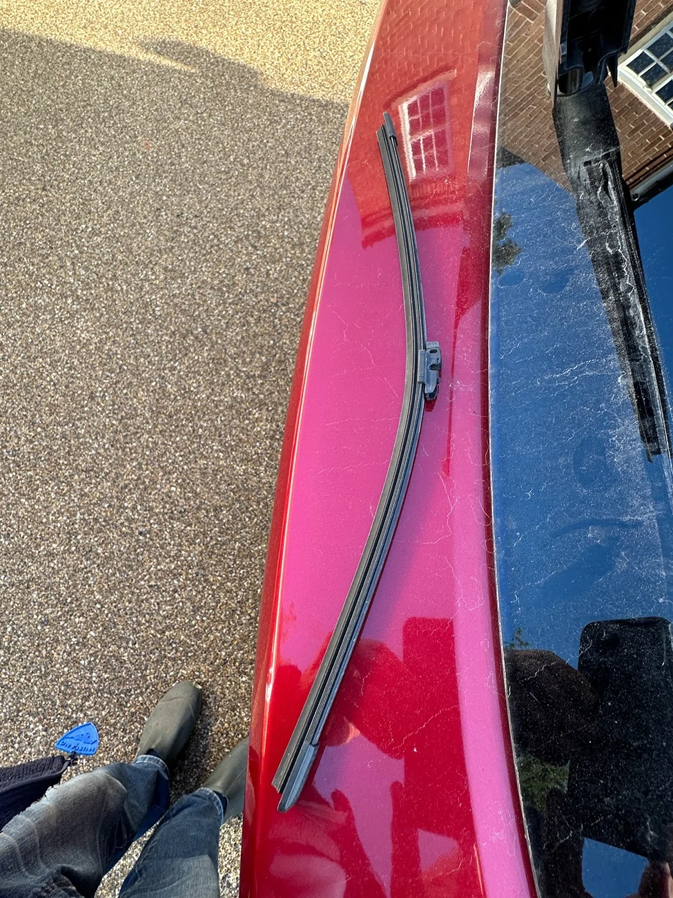

If yours looks like my ‘21 Premium in first photograph, blade assembly just unclips pulling directly away from the arm per video. Second photo shows the open ended clip on blade which fits into the bar inside arm.

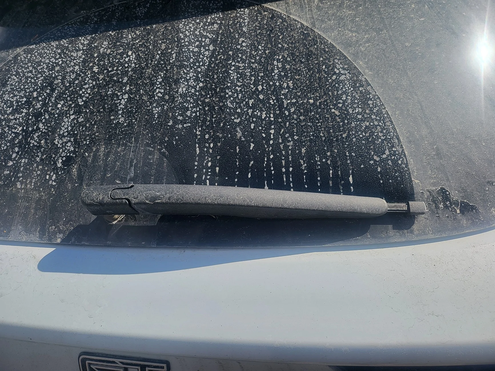

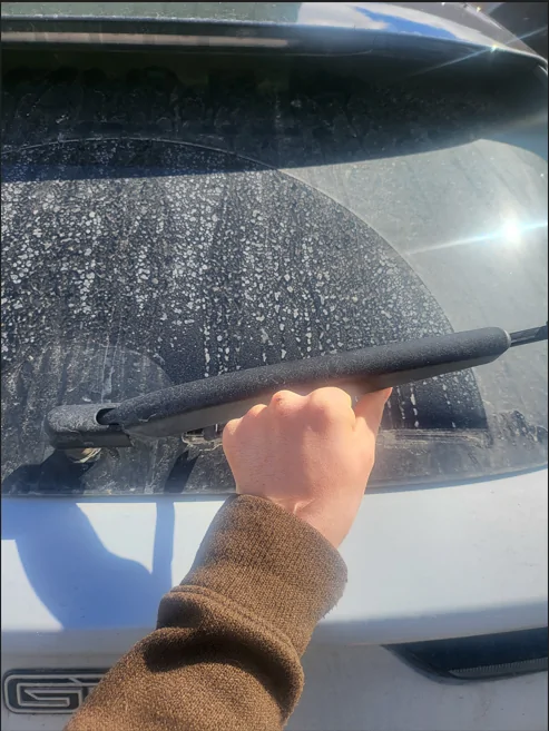

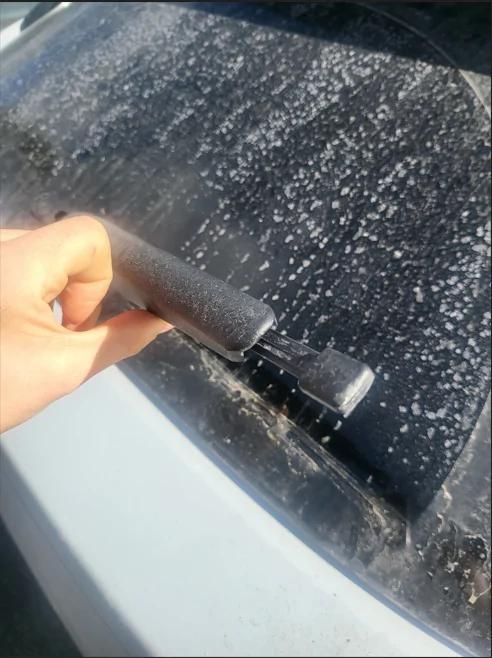

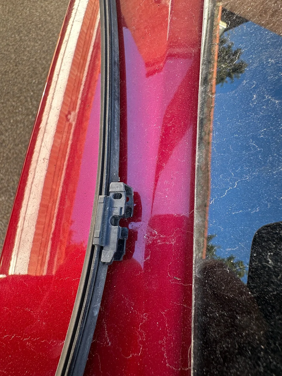

So mine seems different MY2023.
The end of my arm seems a bit different? Also I don't think I can raise the arm as high as you can. It seems yours is totally perpendicular to the glass. Mine seems to only lift maybe 35 degrees off the glass.

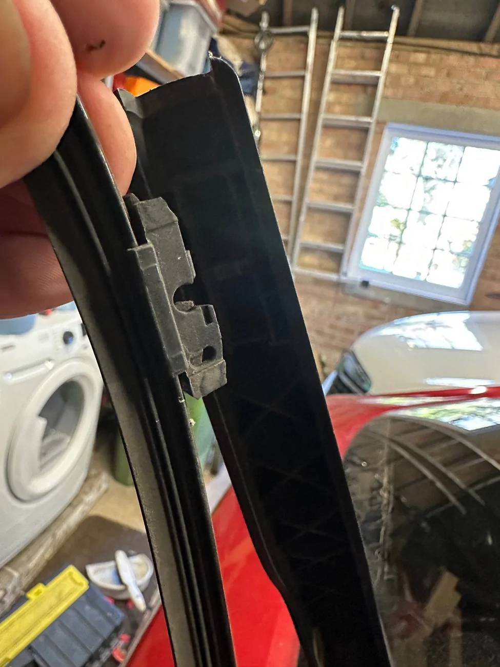

Look at a new blade which will give you an idea of the fixing, is it same as this?

The owners manual for your year shows it comes out in two stages, the clip area is "L" shaped. First, slide out toward the end, then second, like @Teslaeata pull it away.

Did you remove the blade's hinge cover? Then you can lift the blade 90⁰.
