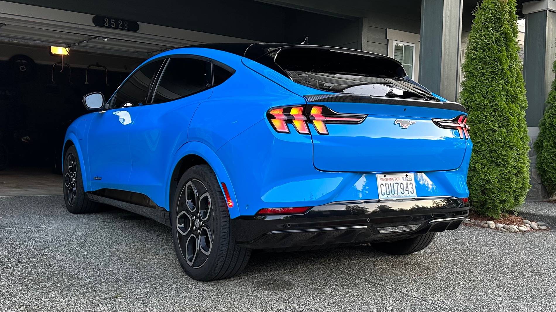

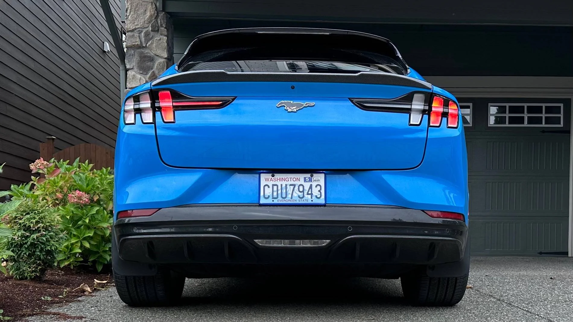

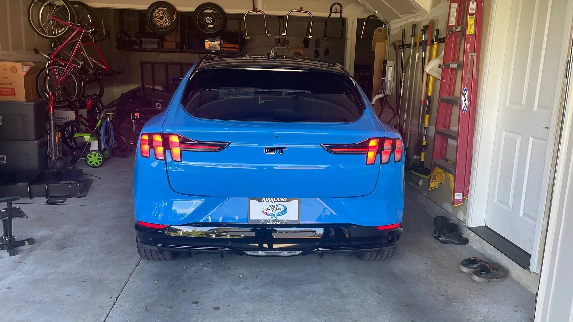

No need to use Photoshop. I used Photos on my iPhone (default photo app) to erase the rear wiper. The car does look much cleaner without it. Looks like I may have another project to work on down the road...

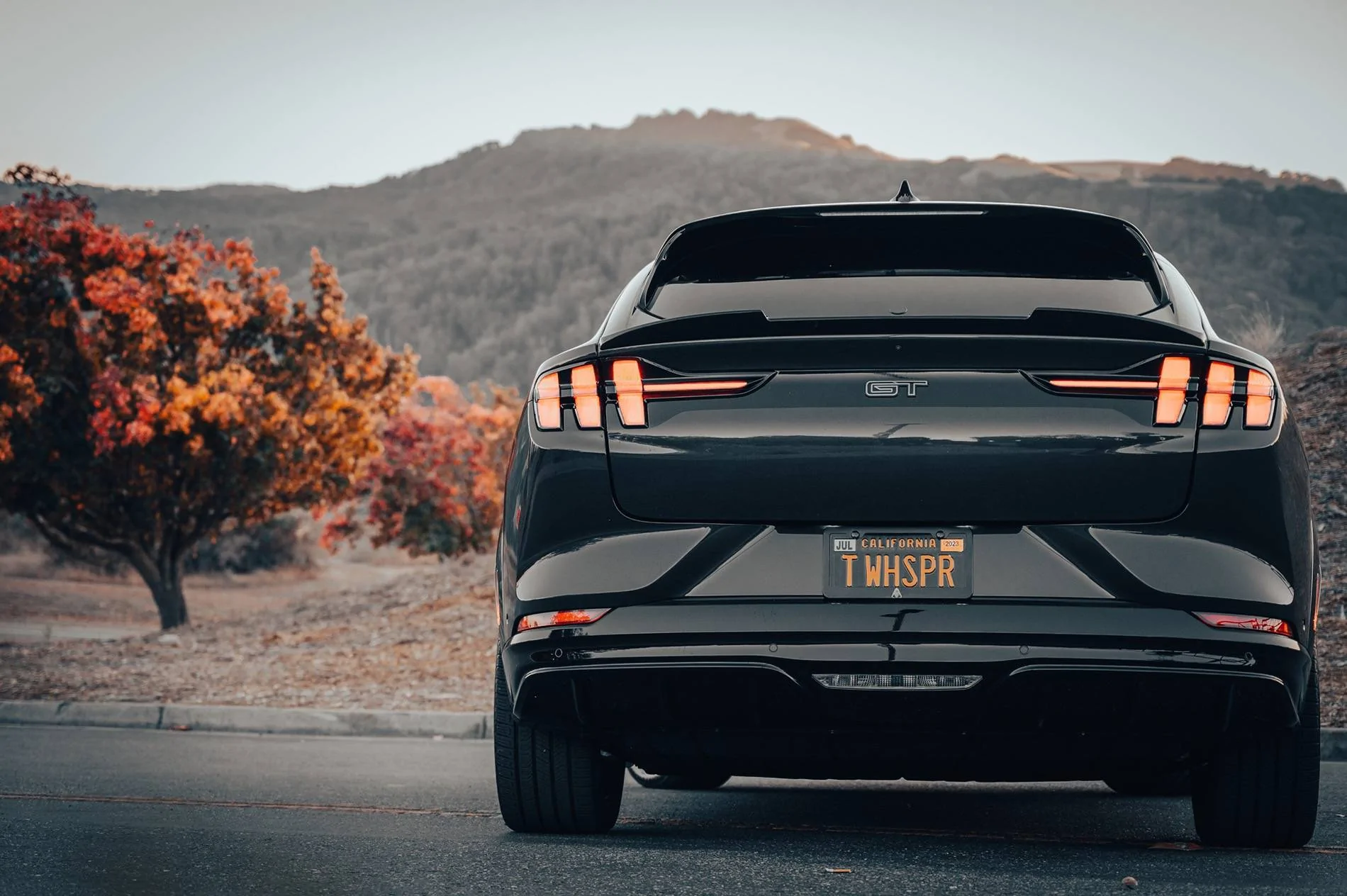

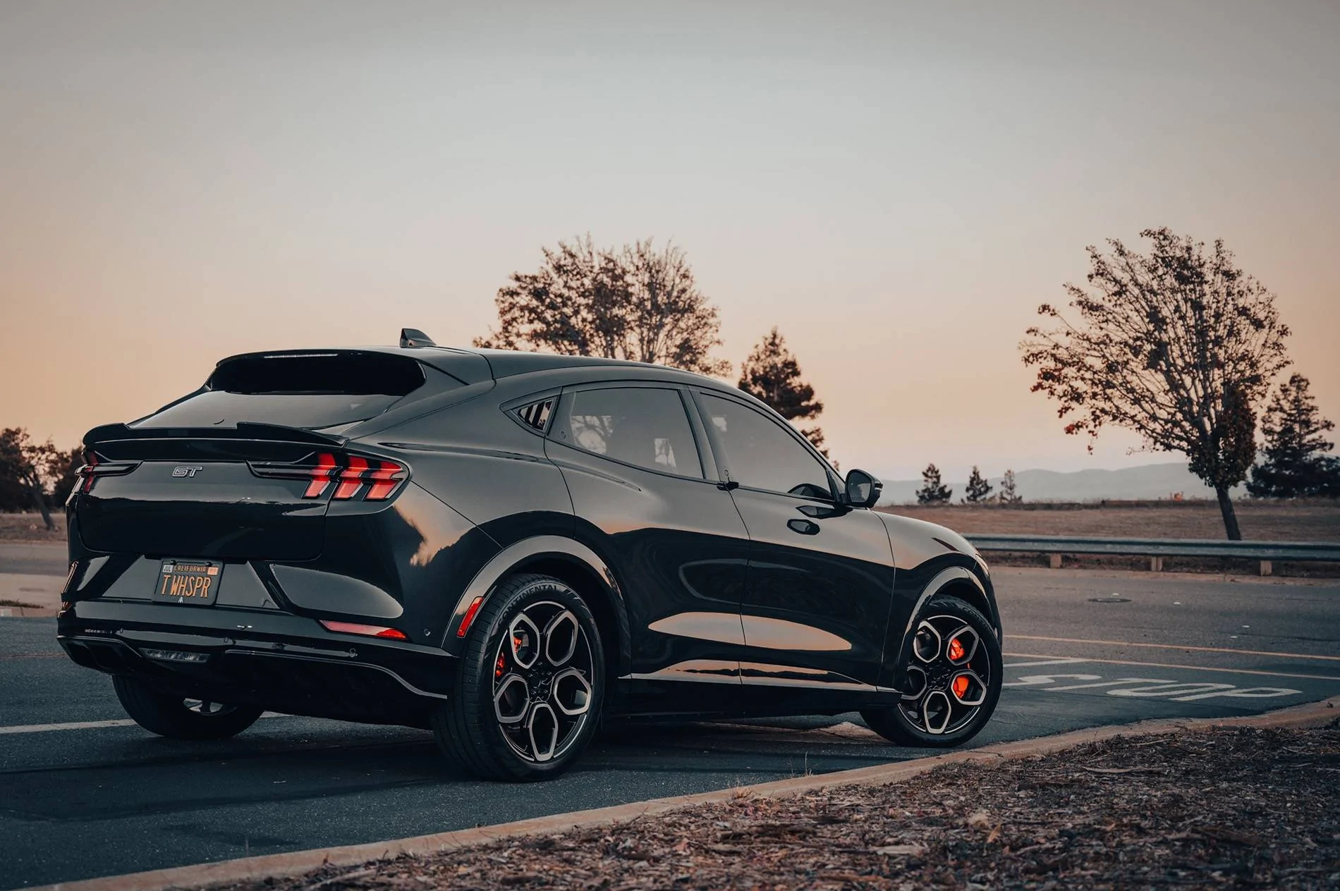

I deleted the rear wiper as soon as I bought the GT back in '22. No issues at all without it all these years — and it looks so much cleaner!

Dmitry, you really take great photos and there is just something about a black Mach-E that looks like no other. Thanks for posting.

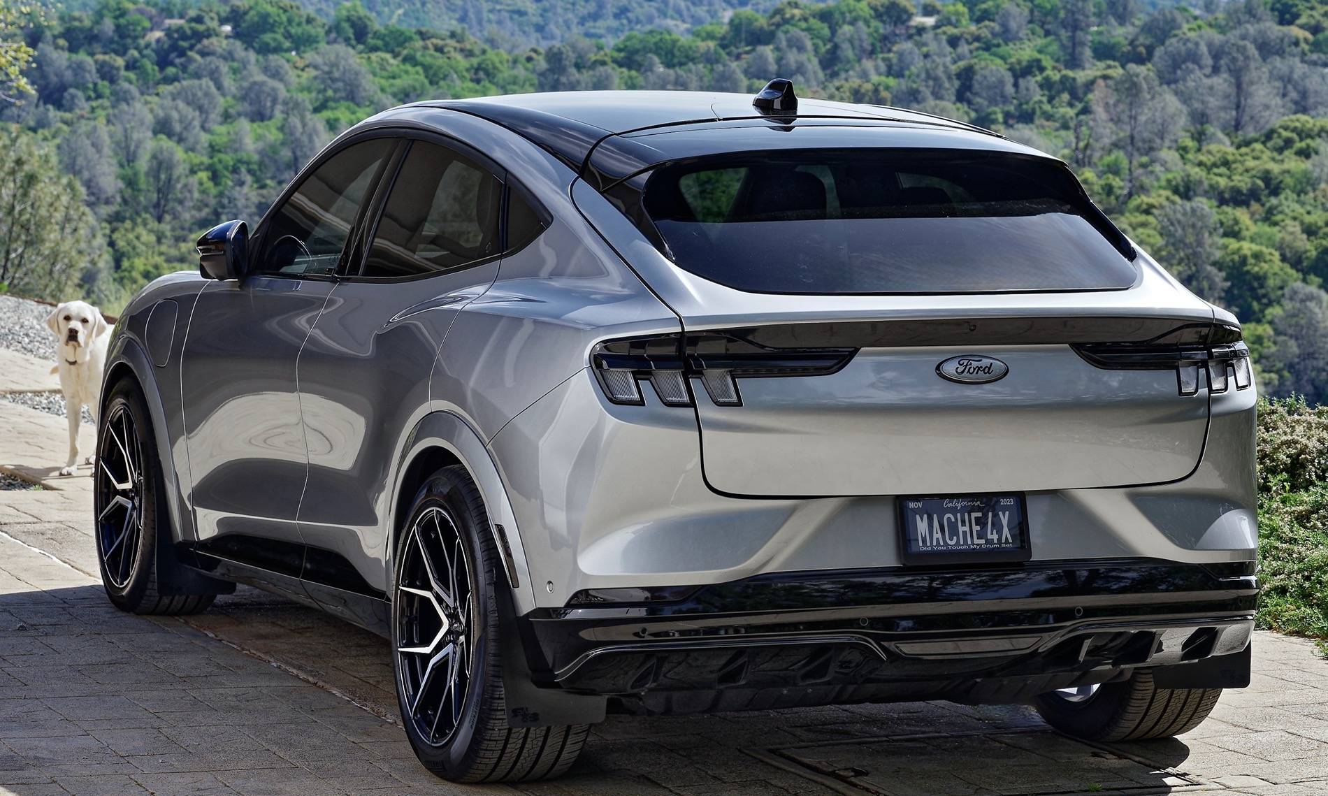

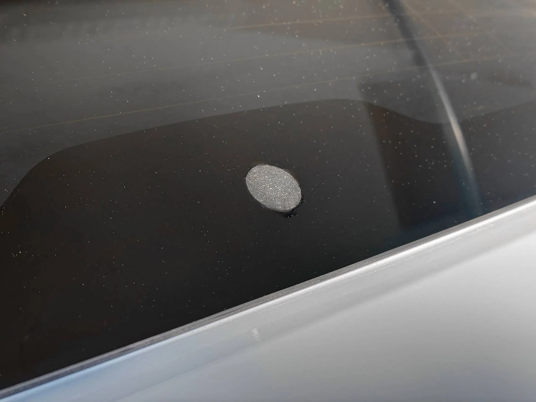

Dmitry, like you, finally got around to removing that rear wiper, although three years later! However, instead of using a plastic cap to cover the hole, spent some time trying to figure out the best way to make the hole disappear.
This post is NOT about having or not having a rear wiper. Some people need it and some don't and that has been discussed. It is about what I did to make the hole disappear.
I used heavy foil tape on the back side of the hole to block it off. Then slightly over filled the hole with Gorilla Ultimate Epoxy. This epoxy is not your typical runny type but more of a thick paste after mixing. It is also a charcoal color when dry.
After the 24 hours of curing, it was hard enough to start wet sanding it flat with the glass. I taped around the hole leaving about 1/4" of glass showing. Using a one inch square flat piece of metal I had laying around as a flat sander, I started with 600 grit. Then went to 800, 1000, 2000 and finished with 3000. In order to get the epoxy perfectly smooth and flat, you end up scratching a little bit of glass around the edge of the hole.
Unfortunately, I didn't take any photos during the process of filling or sanding. I then took a large black magic marker with a wide tip and went over the smooth flat epoxied hole. For some people, that might have been enough but I wanted that hole to completely disappear. The only way to do this was to cover the entire rear window with tint. I tested all level of tints between 5% and 70% and settled on 35%. That was the lightest tint I could use that would completely mask the the hole.
After tinting the glass, when looking at that area up very close, you can see there is a very slight impression on the tint around the edge of where the hole is but there is. It is so slight that it does not show up when I take photos. You can only see it in a certain light and when up very close.
I am very happy with the results. I have not taken photos with the car outside but will next week after I return from a trip and add them to this post. What I really like after doing this is how much better the rear window looks with the rest of the car. With my black wrapped roof and the black spoiler the dark window continues that look.

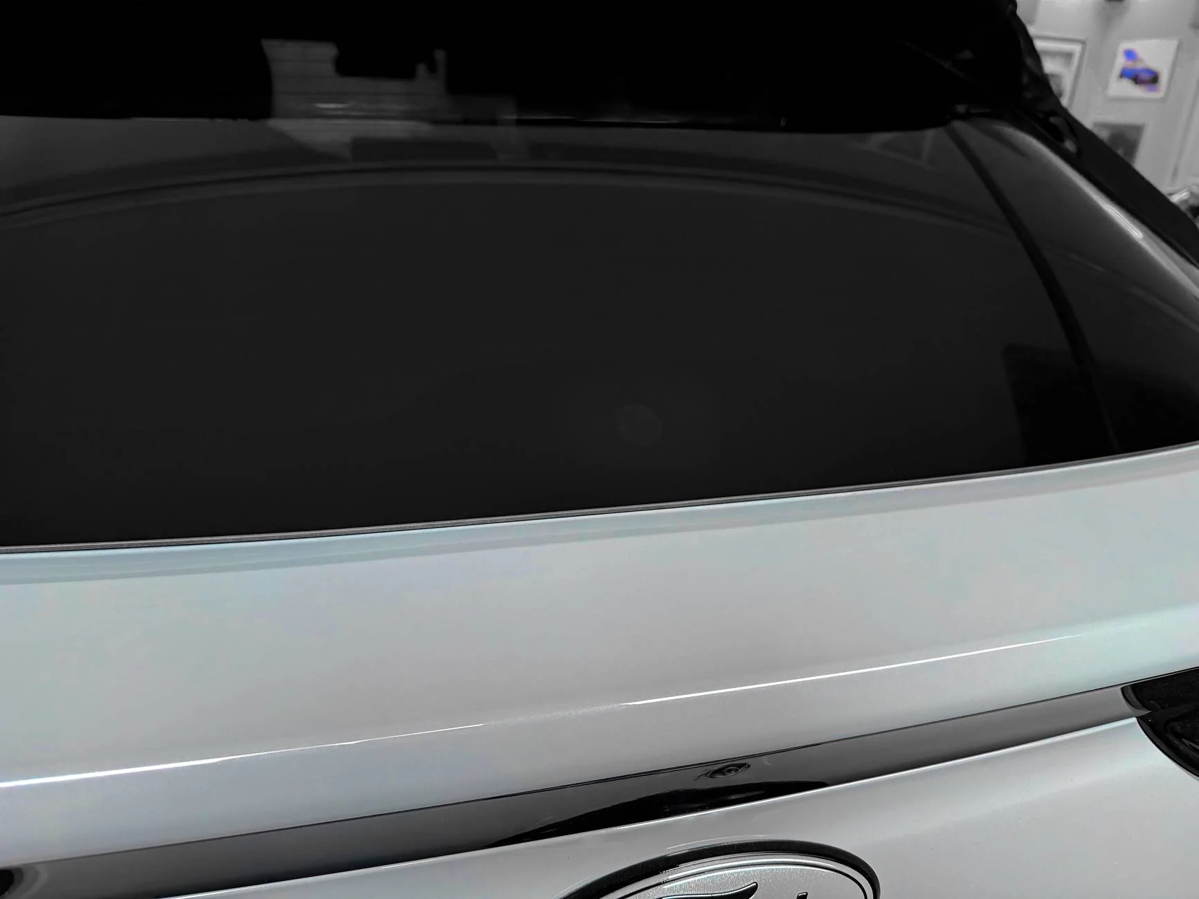

After sanding but before coloring it black with magic marker (window was dirty).
Ford Mustang Mach-E Rear wiper delete? IMG_5098
After coloring with black magic marker. You can still see the epoxy but just barely.
Ford Mustang Mach-E Rear wiper delete? IMG_5140

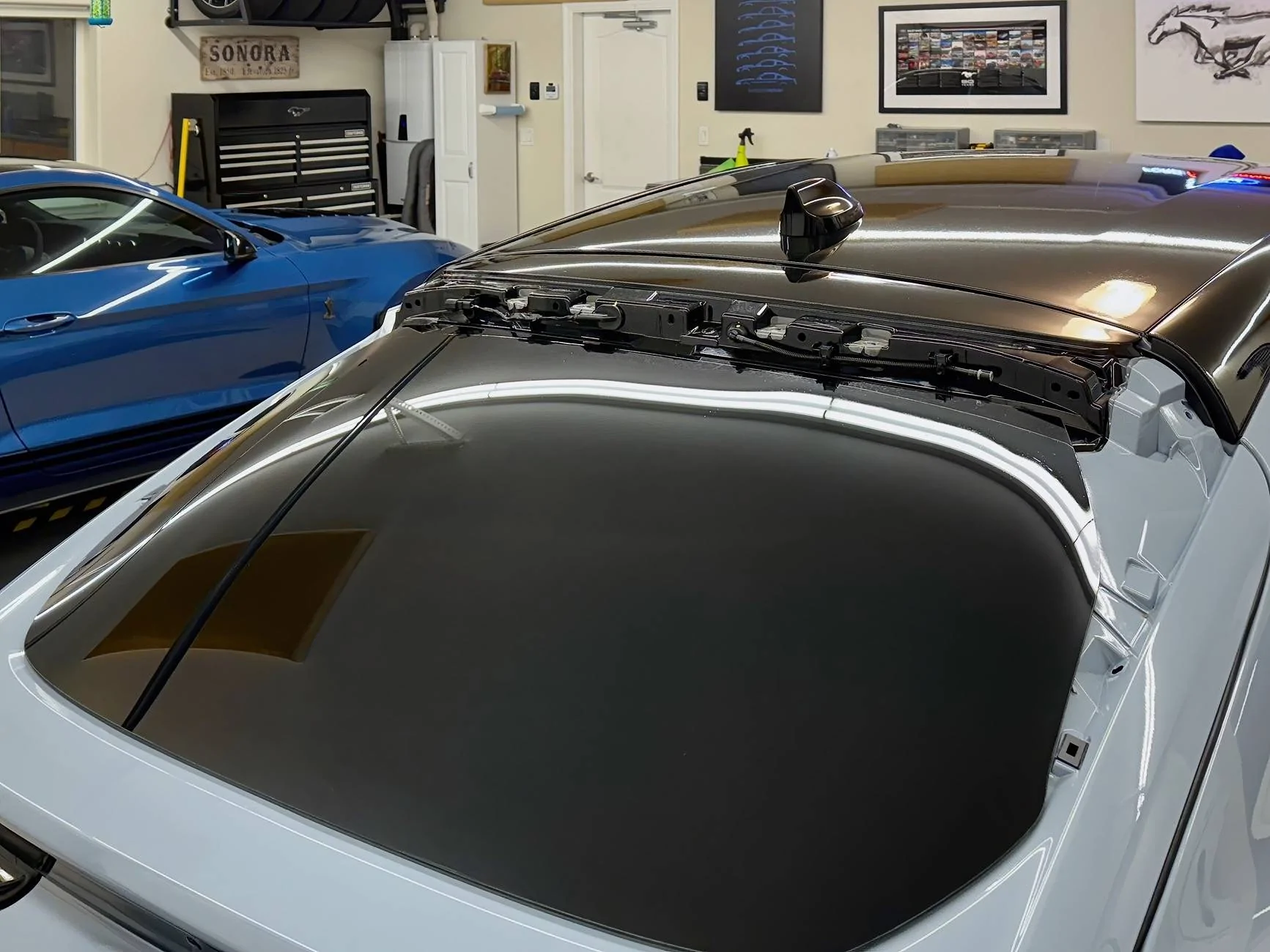

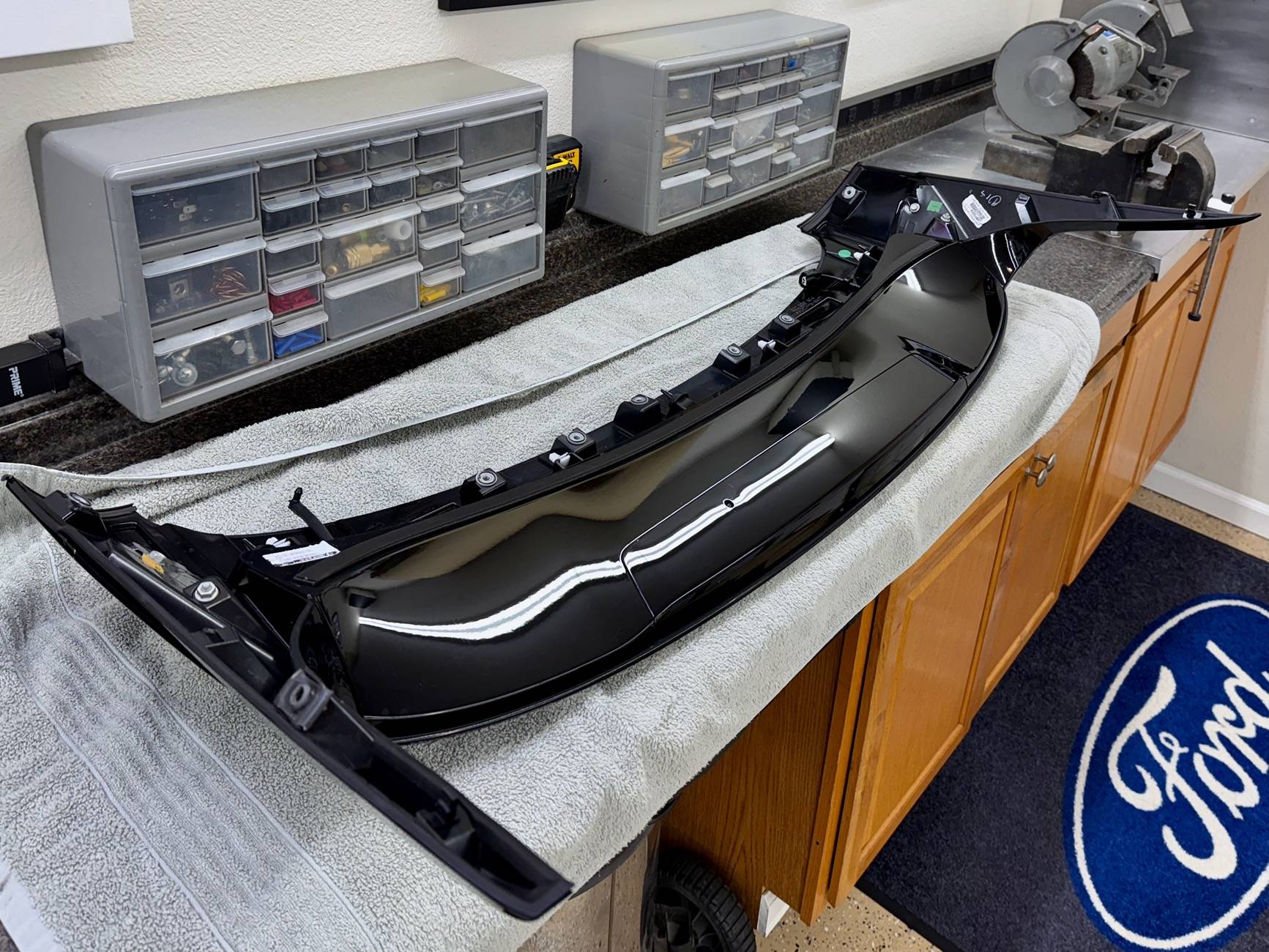

Had to remove spoiler in order to be able to tint the entire window
Ford Mustang Mach-E Rear wiper delete? IMG_5343
Ford Mustang Mach-E Rear wiper delete? IMG_5342

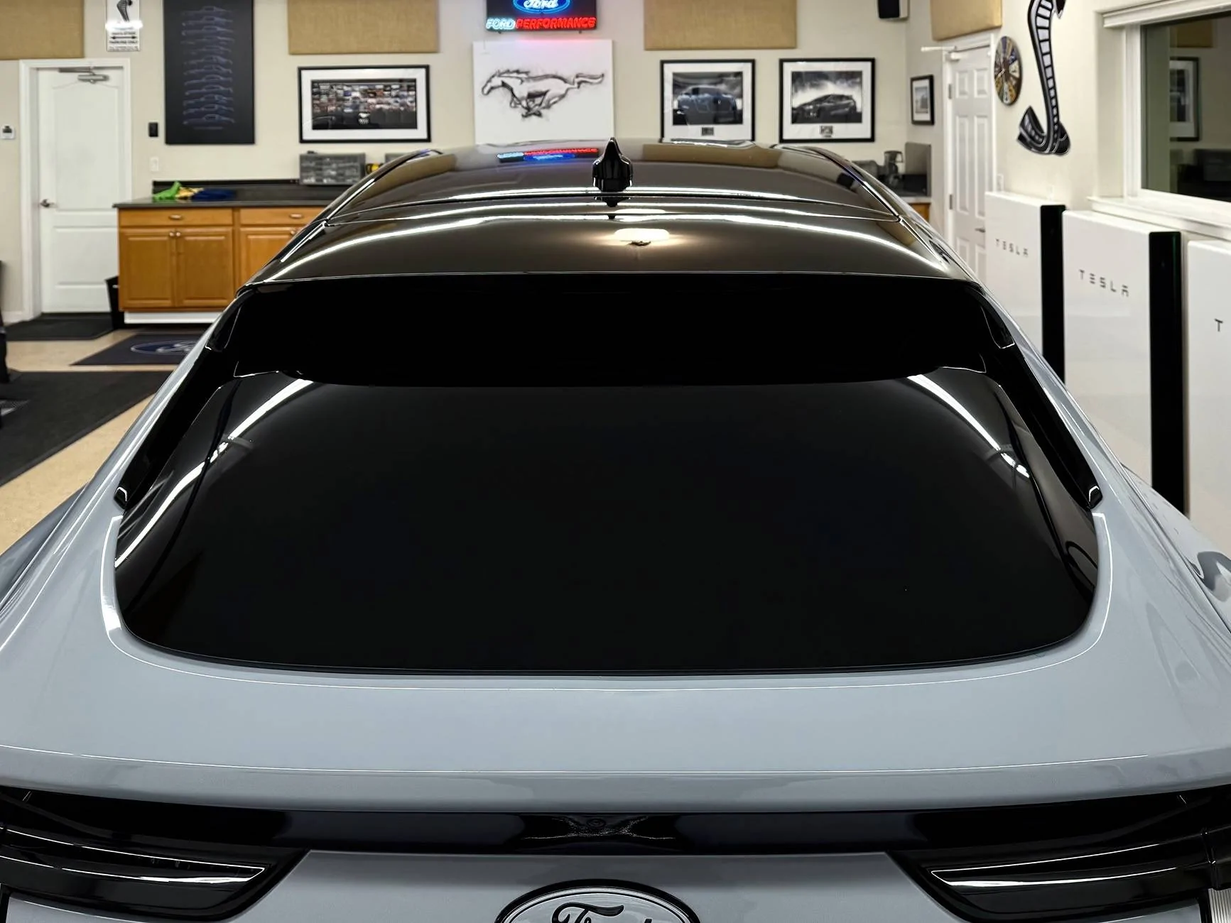

Finished
Ford Mustang Mach-E Rear wiper delete? IMG_5346
