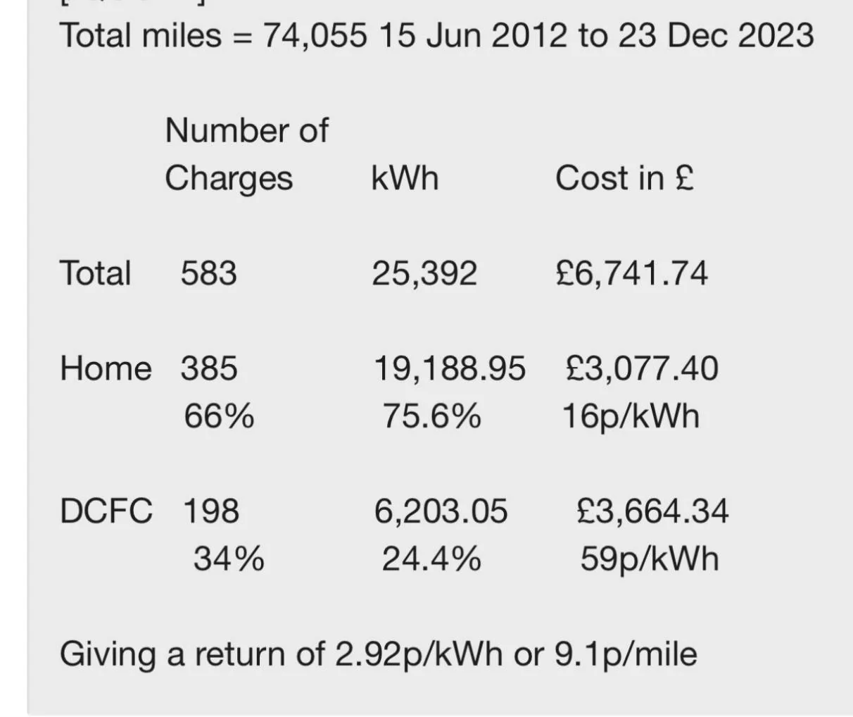

Sounds good?
I spreadsheet all energy I buy at home or at public charge points, and attached costs, with business & private mileages so I can calculate pro-rata how much power is used for business so I can pay myself back the business element avoiding any tax liability.
That way I know precisely how Stangy’s performing.
Ford Mustang Mach-E Recording kWh's used IMG_3431
