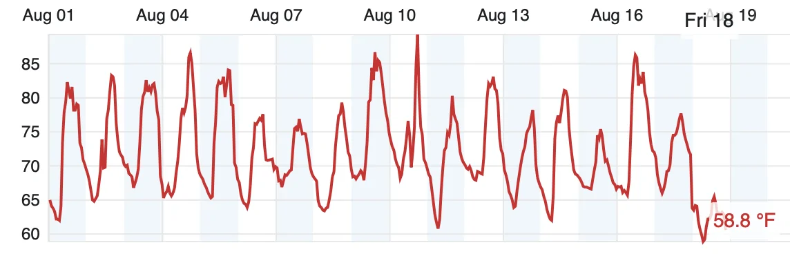

Pretty sure it's not the updates. Overnight temps dipped to 58ÂşF last night, so the pack was probably cold. That will reduce power output. I think you're just gotten used to the summer power level.

I'm talking about middle of the day in 25c weather (77f). I have been driving this vehicle for over 2 years, and yes I'm well aware of temperature impact on battery performance, but here where I live we're still in the midst of summer temps, and I'm not just basing it on one day of driving. I'm basing this on driving after car has been sitting overnight, as well as after driving for an hour on the highway, and also in the middle of the day in summer. Overall it just feels sluggish compared to my past couple years of driving it.

If the car is parked outside at night, it's going to take most of the day for the battery to warm up. It's a large thermal mass that lags behind current temps. Not sure if you know, but the battery doesn't warm up while driving.
One way you can test the battery temperature theory is to precondition by navigating to a DC charger and drive around for like 20 minutes which will heat up the pack if it's cold. I've noticed the pack really needs to be above 20ÂşC for full performance.
If you're concerned, make sure the pack is warm, then charge it up to 90% and do a timed 0-100 run in Unbridle.
