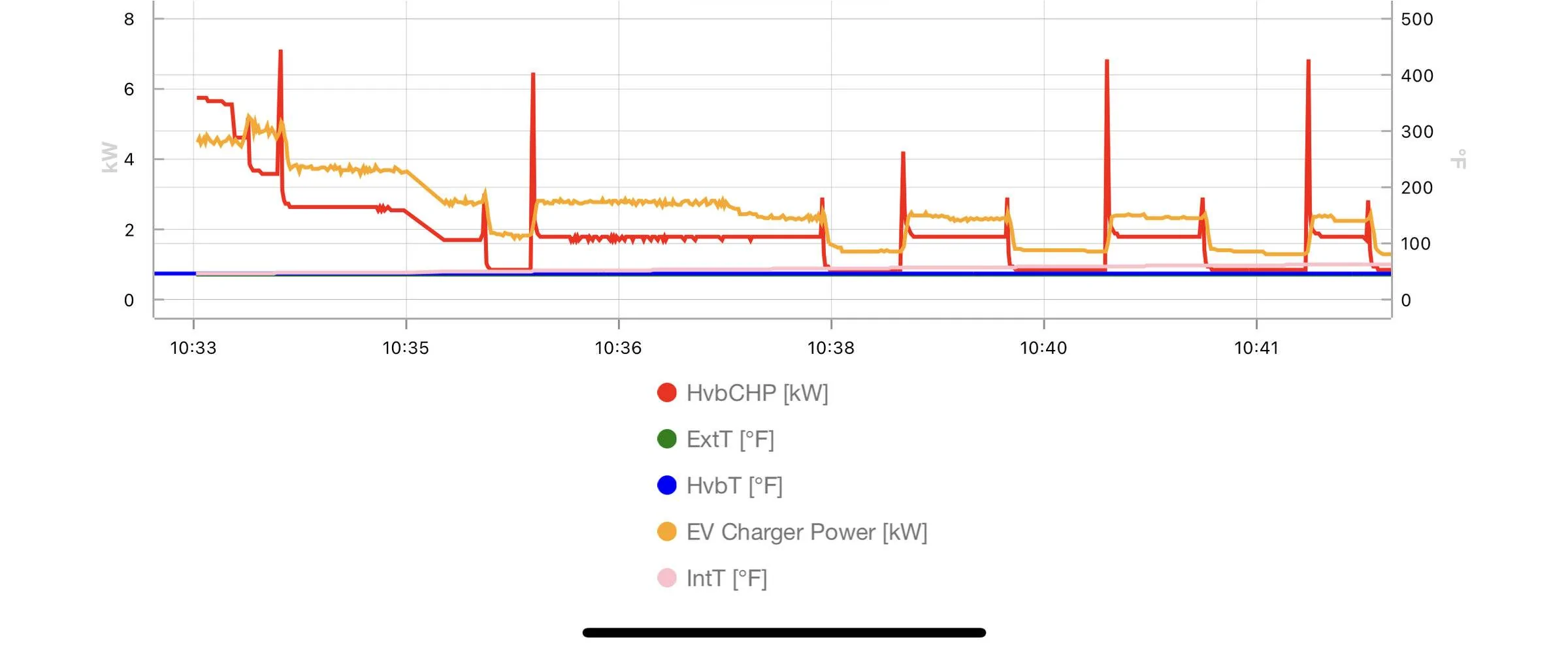

Ok here’s the chart. Sorry the scale is messed up. When the car shut off after the 15 min remote start period, the temp values defaulted to like 400F since the ECU was no longer providing data.
Summary:
- HVB temp, external temp, and interior temp were all 46F to start.
- Coolant heater power seemed to spike on and off.
- HVB temp after 15 min was 48F, interior temp was approx 65F.
I ran the same data feed yesterday while the car preconditioned for 30 min before my scheduled departure. At that time, the HVB temp increased to over 65F, and the coolant heater power was at a continuous 6 kw.
My Remaining questions:
1) Would this hold true even if outdoor temps were significantly colder, or was 46F in my garage deemed “warm enough”. I.E, what happens if you remote start a car that’s been sitting in 0F or colder?
2) What exactly is the “HVB coolant heater power” sensor measuring? From discussions here I was under the impression that the cabin heater and HVB heater shared the same resistive heating elements. However, I’m pretty sure when I tested it yesterday, this sensor only reported data when the actual battery was preconditioning. It dropped to 0 kW even though the cabin heat was still running. I’ll go try another test to see what it reports when I have cabin heat on max but nothing else running.
3) Does the car actually keep the battery warm while driving after preconditioning? I glanced at the live data feed yesterday while driving after my scheduled departure, and the battery temp started to drop pretty much instantly. It started at 65F, then dropped down closer to 50F, implying that the car heated it before I left but didn’t actively continue to warm it while I drove. This still needs to be investigated further.
Interesting graphs, thanks for running the experiment. I can chime in with my observations, I’m actually not convinced that remote start climate control even necessarily runs off the plug. I have mine set to stop charging at 90% and have an EVSE with a light that indicates charging.
When I remote start and run the air conditioning the EVSE does not indicate that the car is pulling any current. But in this graph am I incorrect in interpreting that the EV Charger Power (orange) line shows that it is actually pulling power from the wall?
Yes, you are correct. The orange line is charger power and it is pulling power from the wall. You can also test this with a EVSE that allows you to chart power delivered and see it is definitely providing power when you remote start.
That said, if you are L1 charging it might not be pulling power from the EVSE. I have not tested it personally but I suspect L1 might not provide enough power for the car to utilize when remote started. I would need to test that to confirm, but it could explain what you are seeing.
My non-scientific anecdotal experience has led me to believe that remote start with L1 charging is nice for convenience, but it will drain the battery. You're probably right that it's smart enough to not even attempt getting L1 power from the wall.
