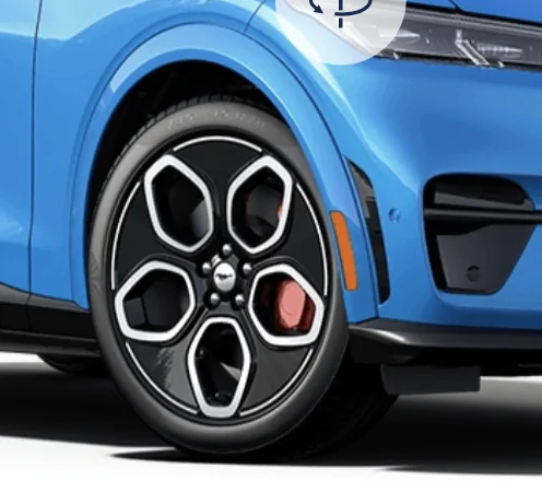

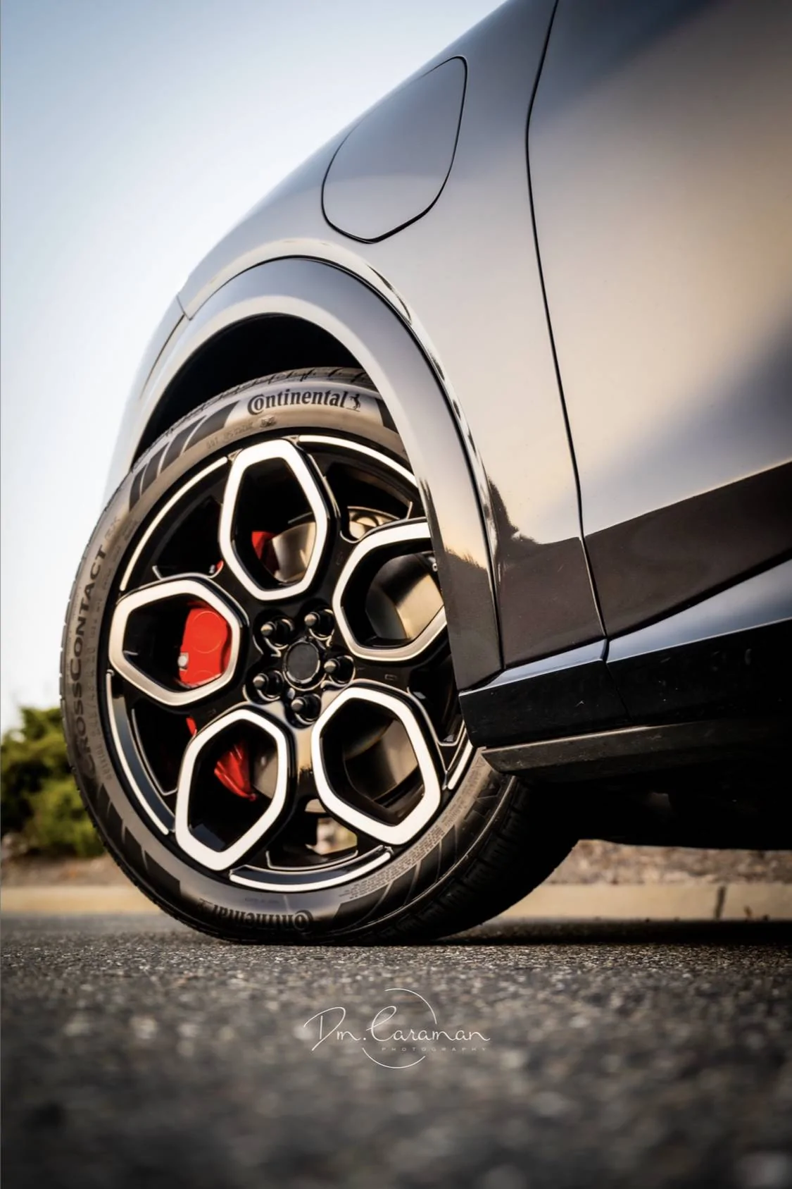

I do like that you can see more of the brake.......Worth it and no significant impact on the range

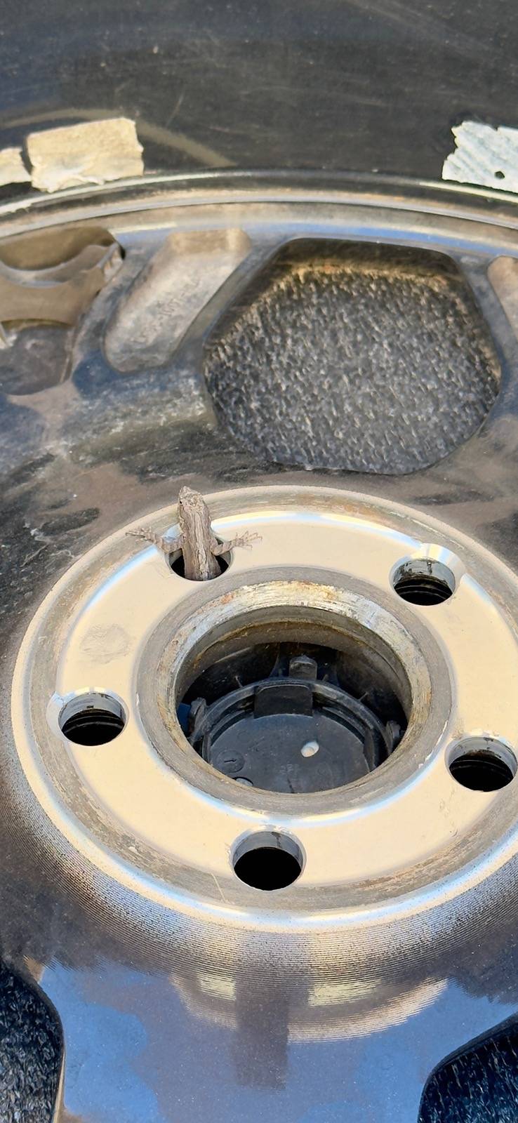

Loosen lug nuts. Jack car up. Support car on stands. Remove lug nuts. Remove wheels. Remove aero covers. Reinstall wheels. Install lug nuts finger-tight. Lower car. Tighten lug nuts. Torque lug nuts in star sequence to 150 lbs/ft. Re-torque after a week.how do you remove the plastic?
Loosen lug nuts. Jack car up. Support car on stands. Remove lug nuts. Remove wheels. Remove aero covers. Reinstall wheels. Install lug nuts finger-tight. Lower car to ground. Tighten lug nuts. Torque lug nuts in star sequence to 150 lbs/ft. Re-torque after a week.
