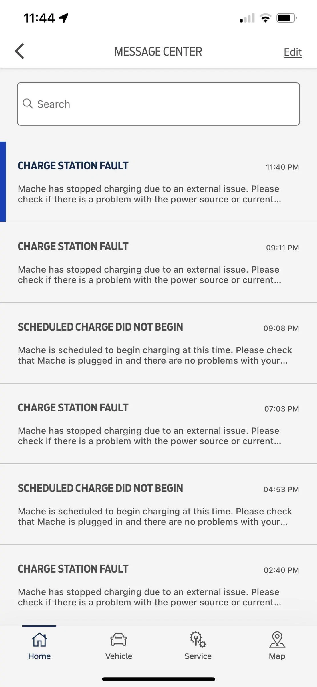

I’m having the same issue for two nights now, charges for an hour then faults. Re-plug and it starts going again. Anyone with a resolution yet?
I’ve been charging at home since 11/1 with no issues prior to last couple days. Ford Mobile Charger on 14-50.
That's very similar to me. Ford Mobile on a 14-50. Used to be fine. 2 weeks ago started throwing the fault if I charge for over an hour.
