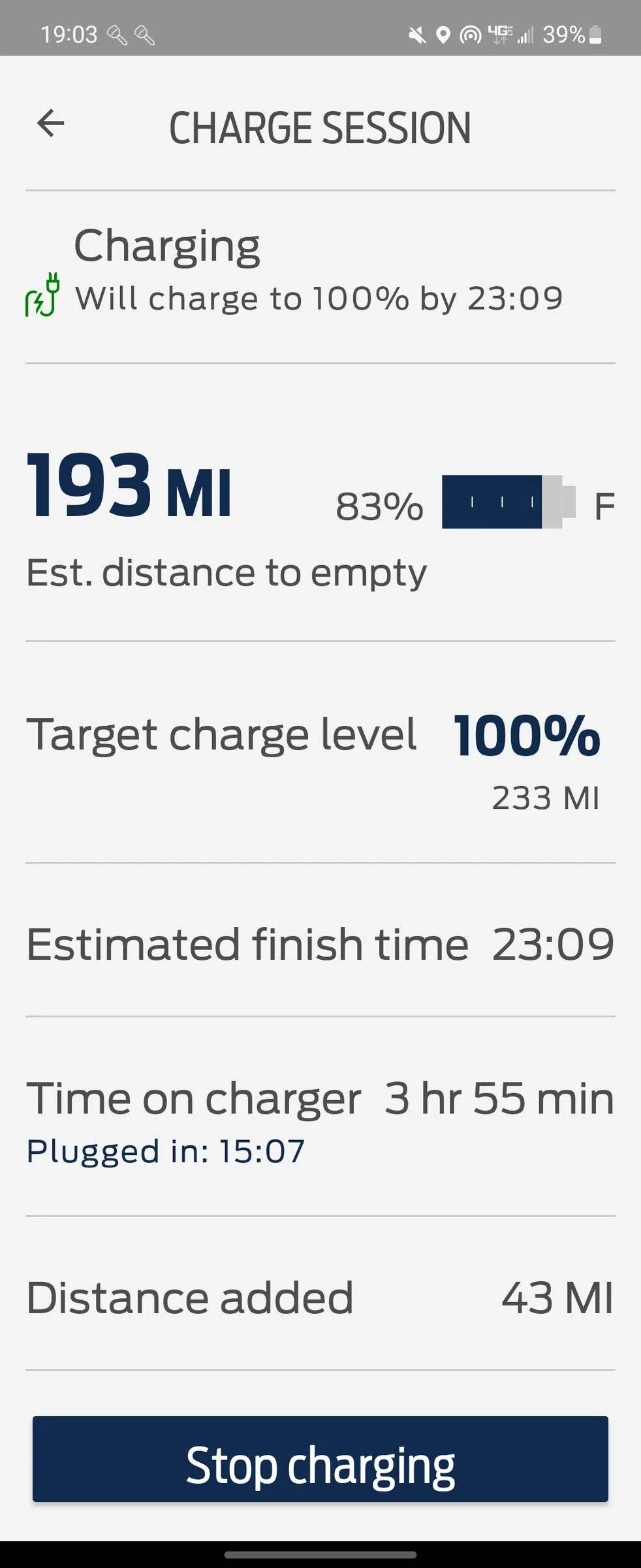

Update for me. Took a few weeks, but got into the dealer. Explained the problem, showed him the charge faults on the app. He took pics from his phone. Told him the tech on phone said I had 4 updates. Appointment was at 10 yesterday, called at 445 to say it was done. Said all updates were completed. App doesn't show any notifications that it has been done yet.
Picked it up today, they were very short staffed. Didn't have the receipt to show work done, guy who took it was off and office locked. But it has been on charger at home for far longer than it has been in 2 months. It typically charge faults anywhere between 10 minutes to 30 minutes.
HUGE difference from a year ago with my First Edition, where they literally told me they had no clue what ti do and have not been trained on it. Bought my FE last February, PaaK never worked, they could not fix it.
So it appears the updates have worked. Not sure what the other updates were, might go back to see what they were. Bought this GT September 6th last year. I absolutely love it, hopefully the issue is fixed. It appears it is.
Pic from today charging
