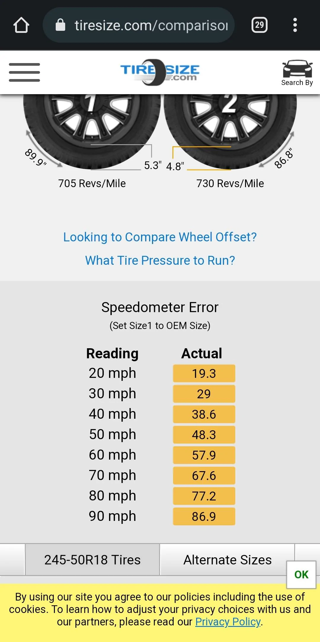

I expect to need new tires toward the end of this summer on my Select... It's looking like I'll be lucky to get 20k miles on them before replacement is required.
I have the stock 225/60r18 all-seasons mounted on Enkie TS-V wheels and would like go with +1 width and summer tire compound for 'spirited' driving since I have snow tires (Vredestien Wintrac Pro) mounted on the stock wheels for when it snows.
I'm not looking for track tires, but am looking for performance summer tires with a little better traction than all-seasons, without giving up too much efficiency if possible....

Stock Michelin barely made it 18,000 miles..... I decided to go with
Continental ExtremeContact DWS 06 Plus -
245/55ZR18

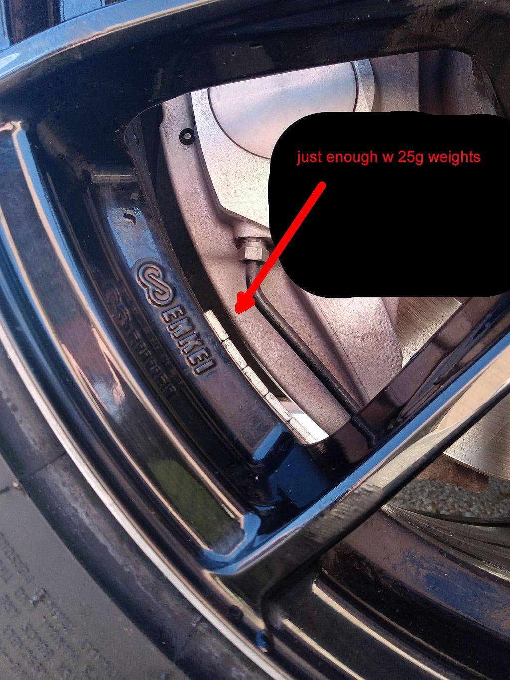

one thing to note with the Enkie TSV-5 wheels is that there was NO clearance between wheel and front caliper with standard 50g weights, so I had the shop use 25g.
