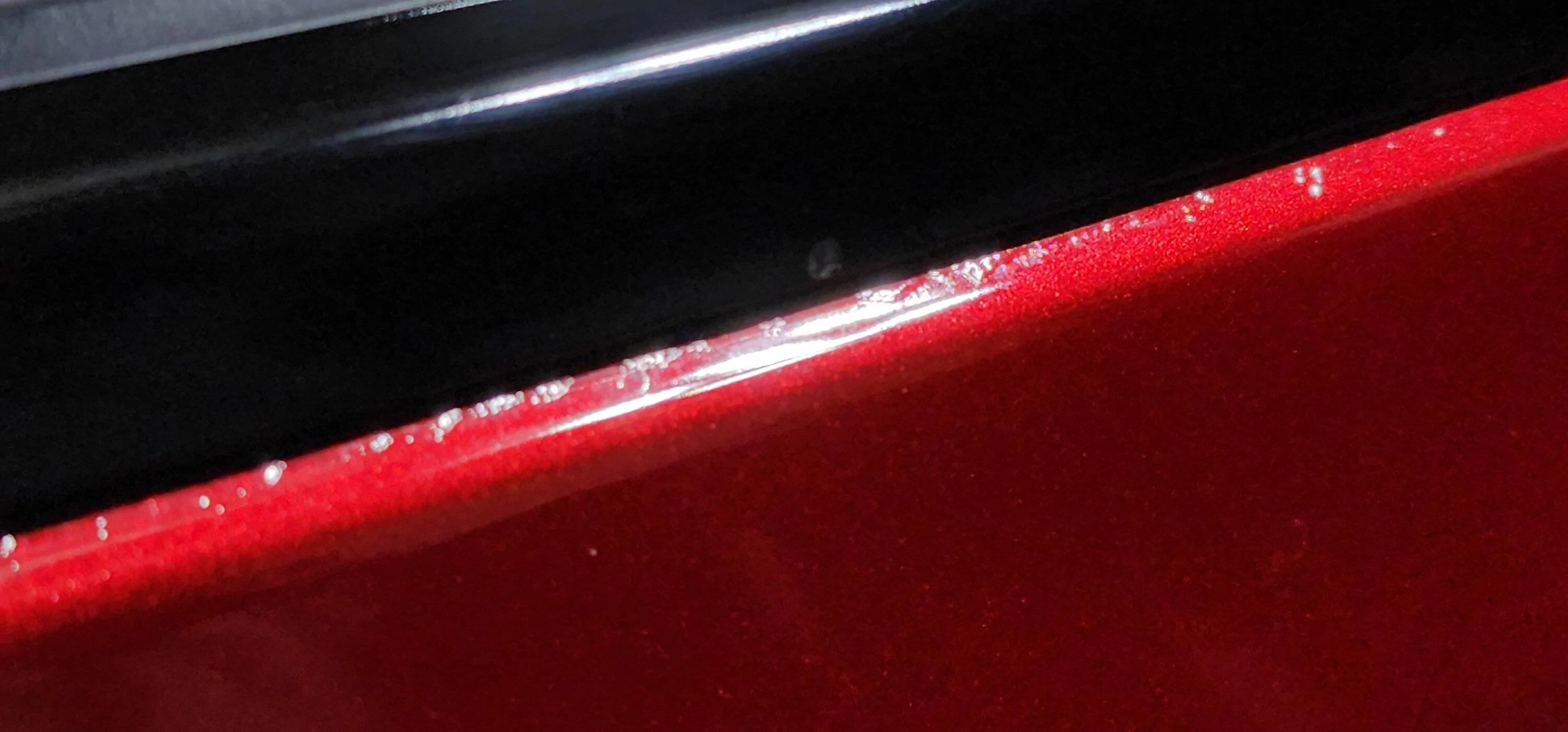

After reading this thread, I decided I should check over my own MME since I'm in the Midwest. I keep my baby garaged, clean and well maintained. I have 25k miles. I just noticed this below the rear passenger window trim.
This is the best picture I could get. Looks like the paint is bubbling. Is this covered in the bumper to bumper warranty?
This would have to be under warranty. I would also guess that this would be under the category of "improper preparation" for the metal before priming/painting.
Unless this is an anomaly, this is a disaster for Ford IMO.
To fix this correctly, I would guess the whole car would need to be repainted.

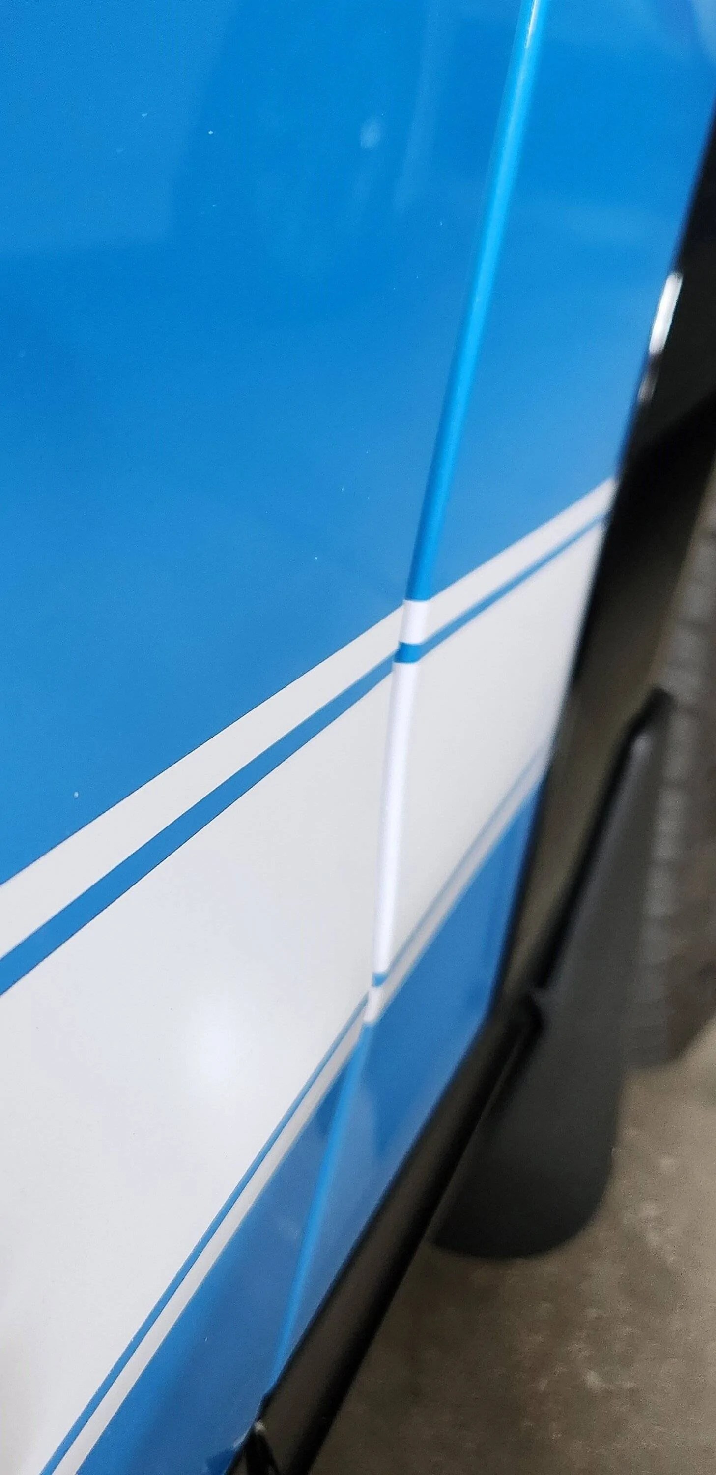

It could also be the clear coat? In any case, I would guess this would not be an easy fix. From the pic below, when I placed the decals on my MME last week, I noticed that the panel fitment was quite poor as well. The front fender sticks out further than the door. I never noticed this w/o the stripes but now it sticks our like a sore thumb. I looked on all of my other cars in the garage and they were laser straight so to speak. The alignment along with the reports of bubbling/rust on this thread doesn't set well with me at all. :mad:

If a body guy could reply to this thread, that would be great. ?

That is what I originally thought, it could be a "bad" delivery to the EU via cargo ship. In an early post, there was a man from Indiana that had bubbling around the window sill. Also, if the salt was so bad in shipping, his rotors and other exposed metal parts would have been visibly "bad" when getting delivery of said car so I don't think it is that.
I think the more likely culprit now would be poor paint preparation i.e. rusting from the inside out so to speak. You are correct, even in the saltiest regions of the world, this shouldn't be showing up so soon.
Also, if the paint preparation was poor in some places then one could assume that the entire metal part of the car would be needing repainted (doors, A-Pillars etc.).

And no, I'm not the only one to have that corrosion at the doors. I know about 5 in Germany now. Out of 10 that checked and posted back in a Forum. Not yet hundreds, but after a year for all of these cars to much for me to believe this is a anomaly. I knew rust would be an issue some day with any Ford. Say 5 years+ I wouldn't be surprised. But a year after delivery? No answer from Ford yet. The dealer said it could take a month for a response.

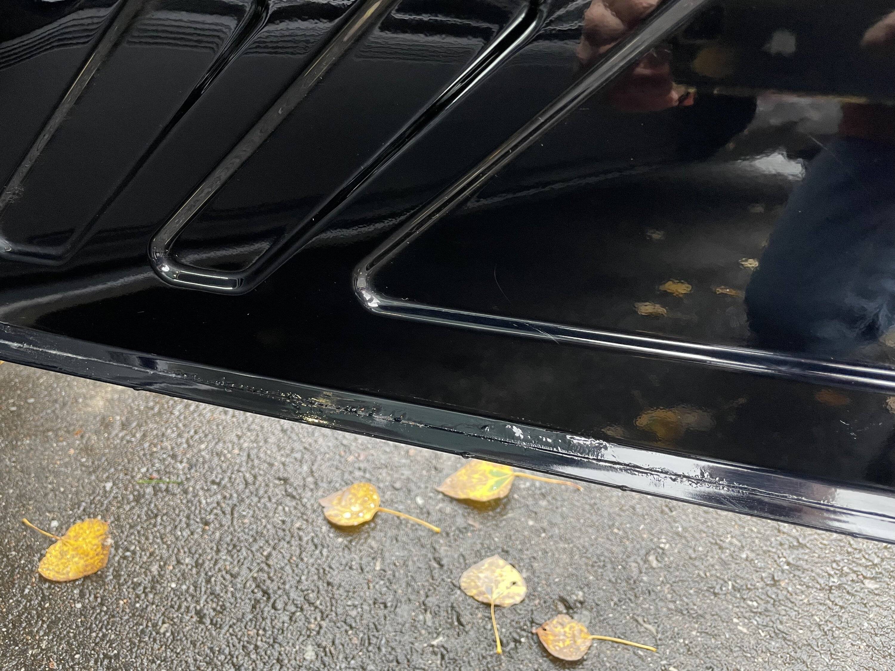

So I had my door checked at the dealer body shop this morning. He did scrape off the paint bubbles at the metal was clean/shiny underneath. This confirms this is not corrosion but poor surface prep before painting. It will be repaired in a few weeks.

Let's see what I'll here back from Ford. But your post is a relief to read.
