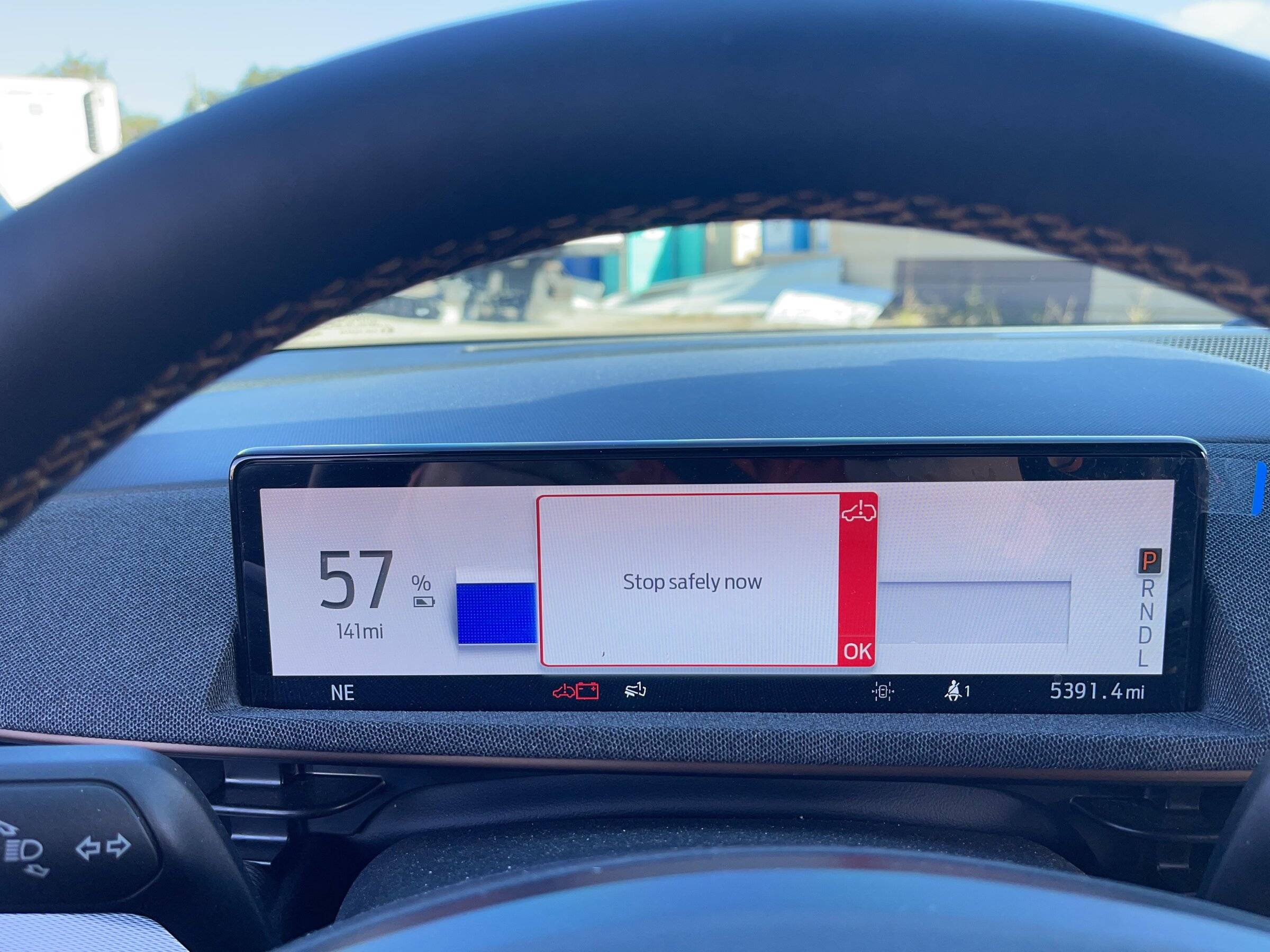

OK OK 2nd damn Mache NOT HAPPY!!!
What is it? What happened?
Drove it no problems no issues stopped did my thing got in now I have the safely stop alert won’t start
Goofballs in India are sending someone to jump start it LOTS OF VERY BAD WORDS CAN BE FILLED IN HERE
ANYONE have this issue?? I saw a small thread but no reason as to what happened

Yes, this has been an occasional issue. While your waiting on a tow, try turning the car off and kea I get it off … for quite awhile. After that, try turning it back in and see if the issue vanished.

Yeah I tried everything Just sucks my CA route one went down bought this GT and now this Just really aggravated right now lik

@Caliroute1 update? whatever happened with your car? I have a GTPE and the same issue.
Hey, the replaced the BECM or something, took over a month, then it went down again 02/14 for another month and they did the same thing.
I just got it back recently, and so far so good.
Yes it's the BECM that is frying. It's interesting that you went through 2 of them yikes!!!!
Yup Two...... Maybe I am driving it to hard? Love my speed from red lights and open road. WEEEEE
