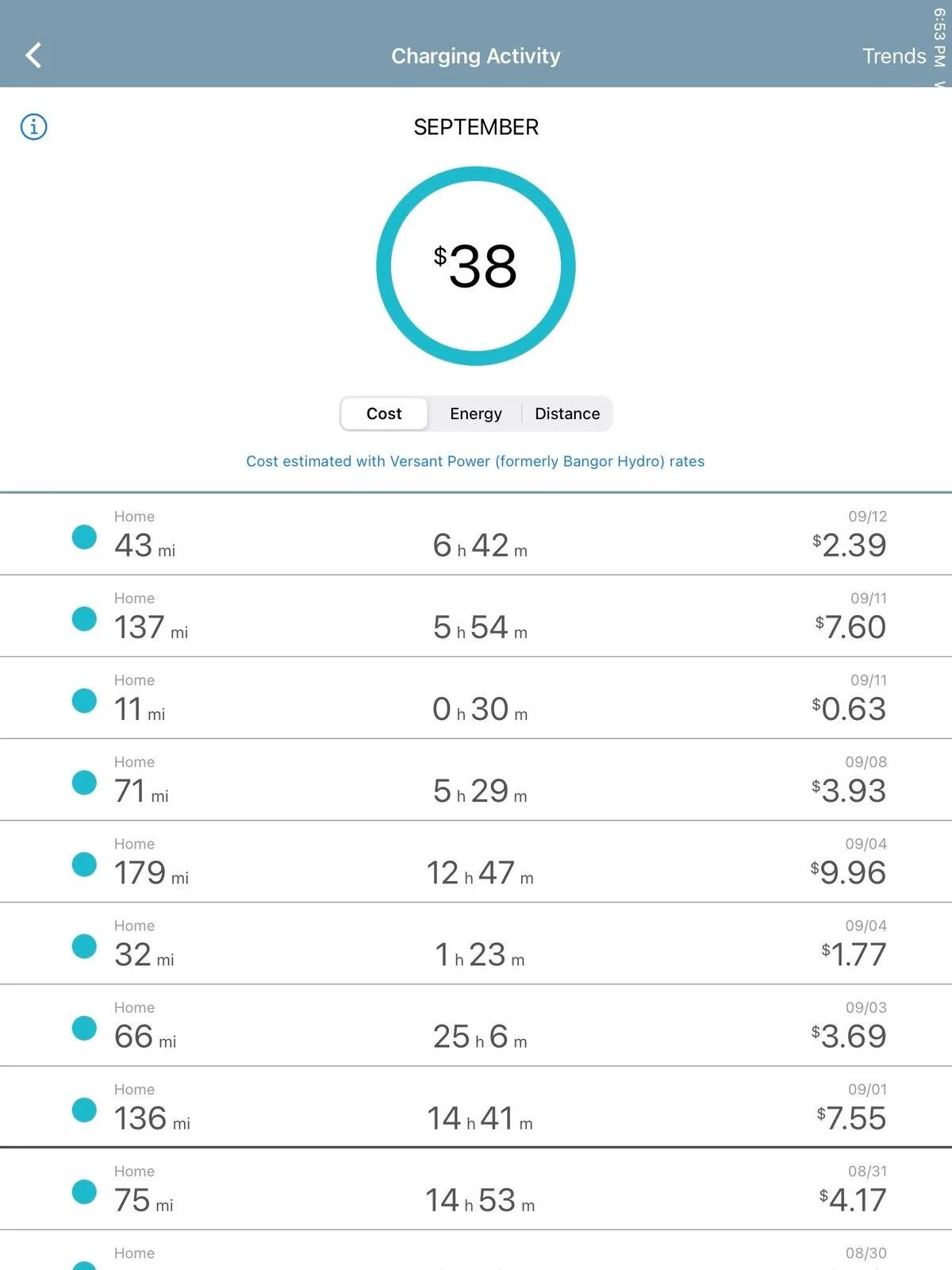

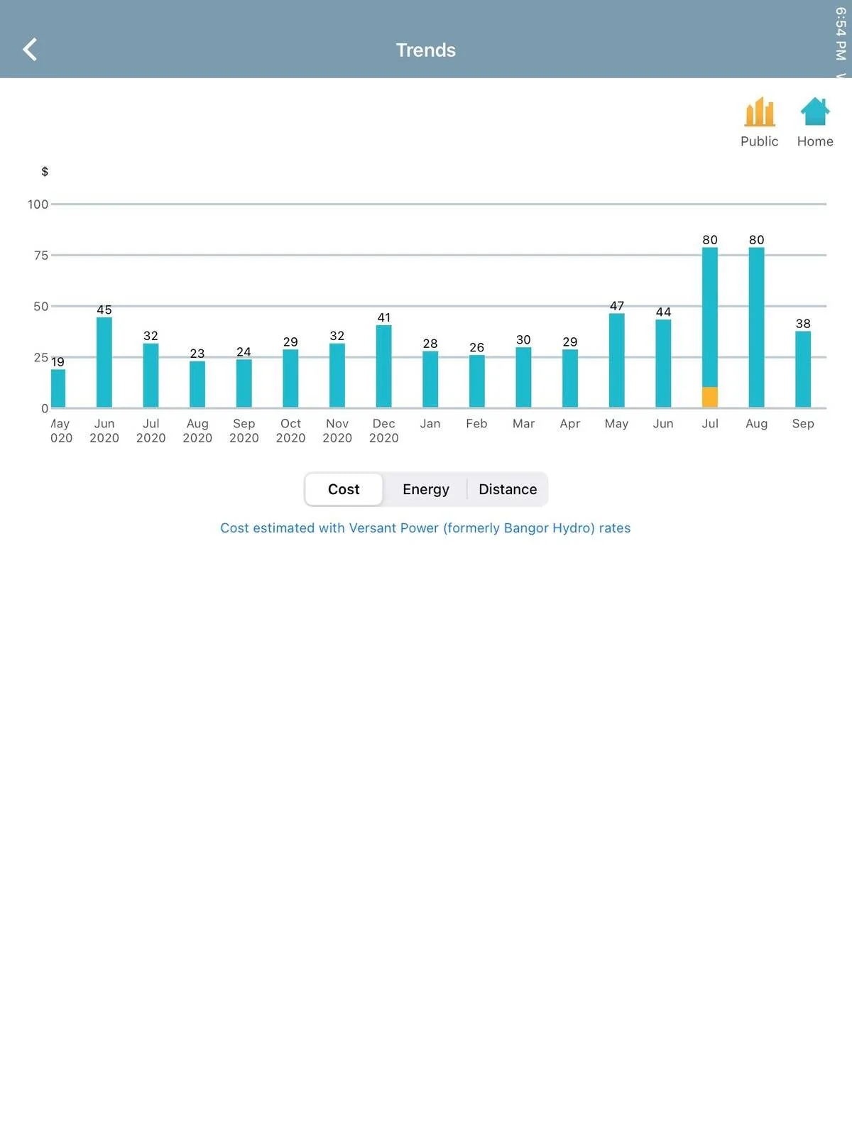

If TOU is critical for you, I would recommend a Chargepoint, Grizzle Networked, Juicebox or other "network connected" wall charger. That will control your schedule better, be very reliable, give you costs and reporting, and give you live updates through your home network. It will also give you a few more Amps of charging over the Ford portable unit.
Keep watching Ebay for a deal. I paid $250 for a Chargepoint Home new in the box without the Cord. A cord was $75.
OP is using 120v.
