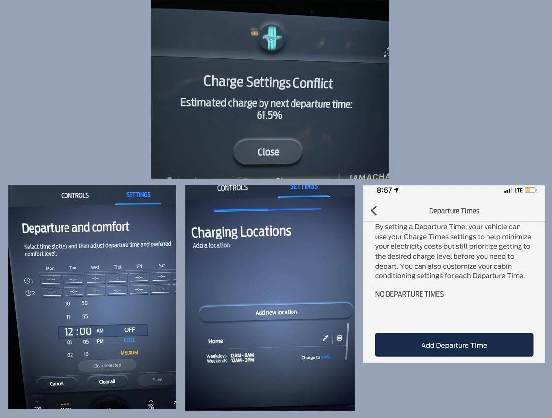

Anyone else having issues with SAVING their charge settings. Suddenly my Charge Level went from 70% to 100% and when I change it to 60% I can not save the change. The Save Button is not lite up like it use to be and I cannot apply the change.

In addition to what others have said, you should set the car to charge to 80-90% max instead of 100%. It's not good for the battery to go up to 100% every day, and it also might figure the last 10% goes a lot slower time-wise (charging rate slows down the closer you get to 100%, so keeping the battery lower charges faster). You should be able to charge 60 kW in 12 hours, which is 68%. If you set it to do 90%, that means if you get home with more than 22% it should charge in one day.
If it's still showing it won't finish, I would just extend the end time to 8-9AM and hope it finishes early.

The vehicle will ignore the charging times if it cannot achieve the set level by the end of the charging period.
I assumed that is what it was doing, but in my opinion it should not do it this way.
When you park it comes up and says "Hey I can't make it to your requested percentage", that should be your key to go to your app and start charging. If you don't manually go in and tell it to charge then it should not start till your schedule.
If you have departure times set then I could understand if the car took more drastic measures and turned on charging outside of your window. However it should pop up a message or alert you that your car will start charging outside of your designated times and give you the option to use your schedule instead.
For those of you NOT in CA, it might not be a big deal. But here in CA, during peak hours, my electricity is $0.60327 kWH which is absurd!!! Having the car go rogue and start charging outside of my set times would be costly... I'd much rather go pay .41 at a DC charger lol Even Super Off Peak hours is still $0.29881 kWh. I just changed to an EV Plan through SDGE and my Super Off Peak should be $0.09 now.

Totally agree. This has been an issue for years with Ford PHEV's, so not having a "don't charge outside the specified hours" setting is inexcusable.
With the 120v charger, using a WiFi outlet plug solved the problem for me with my PHEV. Now, with the Mach-E and 240v, I have both the car and the charger set to my off-peak hours, so it is not going to charge.
Just an interesting finding.
I came back from a trip around 3 pm, with less than 25% on the battery. My home charger is only 5kw (25 amps 220volt). When I plug it in, it said it could not charge within the schedule time (7 am to 7pm) and start charging. Using the Ford app, I stop charging. It restarted within a minute. So I unplug it and re-plug it around 8 pm. It then charged to 7 am and stop. It was at 74% and stated it would resume charging at 7 pm and be done around 2:30 am.
