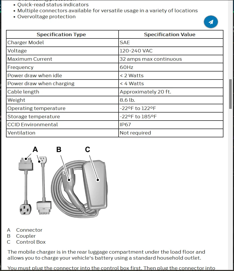

Isn't the car limited to 32A regardless of the setting on the wall box?

No, the Mach E has a 11.5kVA AC charger which means at 240V it can take 48A of current.
I'll echo WEC's reponse and confirm that the Mach-e has a 48 amp limit on Level 2 AC charging. I don't know where it started but there are threads all over reddit stating INCORRECTLY that the limit is 32 amps.
Not to necro, but the optionally included mobile charger is limited to 32A when using the 240V plug. Obviously, a more capable EVSE allows 48A but this must be how the reddit threads started.
