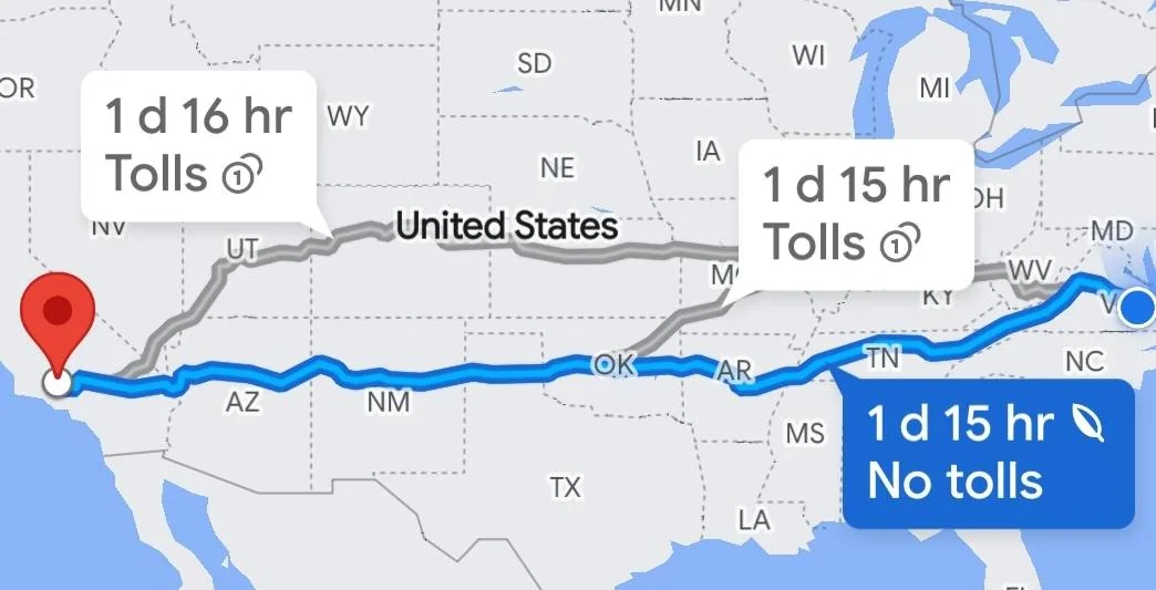

If I lived near the Grapevine I would break my self imposed (i.e. wife imposed) 80 mph speed limit and do multiple runs up and down it until I gave up or it broke. I have made a few weak attempts to kill my HVBJB without success. I WOT every day. Lame.
If only the Grapevine wasn't 3,000 miles away...
Edit: it is actually closer than I thought. Only 2,694 miles. I head out tomorrow.

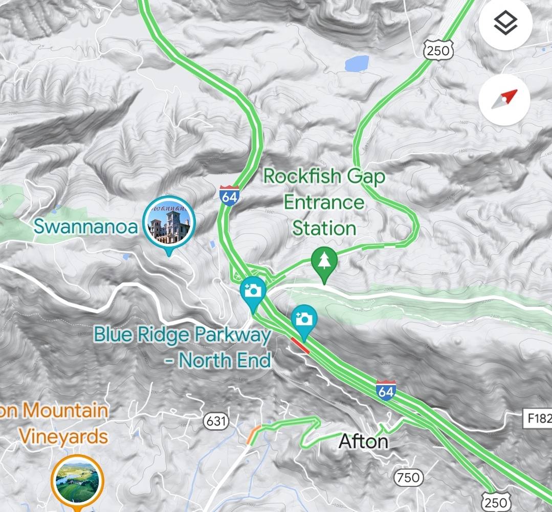

We need to find you an Appalachian grapevine Mike. I-24 west of Chattanooga, TN or I-40 near Iron Duff, NC might work.

I do this stretch on I64 every time I go to Roanoke, which over the past couple of years has been a lot of times due to my parents and their failing health. But I do not think it is long enough. I have to DCFC about 30 minutes before I hit the mountain on the way there. On the way back the DCFC is after I go over the mountain.
Ford Mustang Mach-E Should I try to force HVBJB to fail? 1000008157
One thing is it is hard to maintain 80 mph going up that mountain because there are so many trucks that are crawling along and people passing them slowly - and people in general going the speed limit or lower in the left lane.
