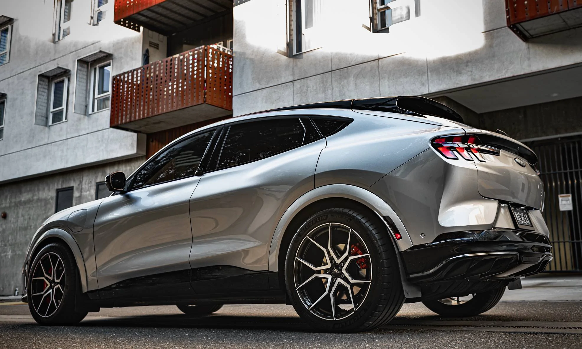

Wheels and tires are my favorite mod. It's the first thing I do when I get a car. Like all mods, it personalizes the car but in this case it also improves the performance and ride. This wheel/tire setup is the same diameter as OEM but much wider and 12 lbs lighter. Signature Wheels SV706 fully forged in gloss black with polished face. 20"x9" ET33 front, 20"x10.5" ET47 rear. Tires are Michelin Pilot Sport 4 N0 Acoustic. 275/40/20 front, 315/35/20 rear.
Do you think the ride would be even better on 19in wheels?

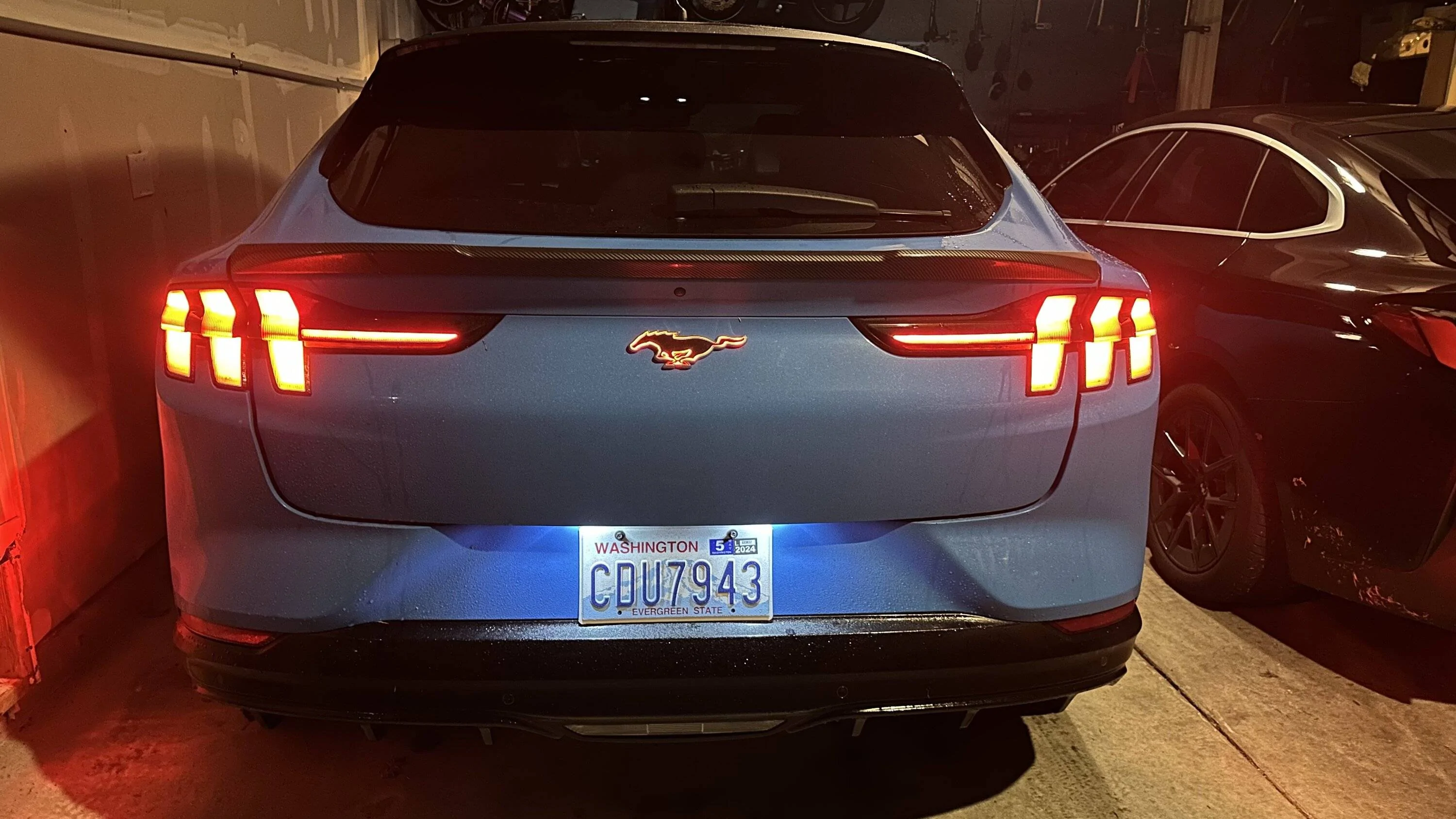

Is that lit up and if so, how is it connected? and where did you get it?
I have a lit rear pony like that, which I got from the ev-vida store, but unfortunately, their listing for it is gone, so either they discontinued it, or they can't get it from their supplier anymore. You might look around and see what you can find, though. I think there were maybe some others available.
In the case of mine, it pulls power from the brake lights, so it is only lit when you're braking, otherwise, it looks like the OEM pony. Installation was just a matter of removing the the covers from the inside of the liftgate, using an emblem removal tool for the OEM pony, putting the new one in, and putting its wiring clip in the original slot, and then plugging the brake lights wire into a pigtail coming off the new emblem, testing it, gluing the new one in place, and then zip tying, and putting everything back together. There was a youtube video from ev-vida that walked me through the steps.

I replaced my GT with the pony. I like the pony better than the letters G T. ?
I also got mine EV-vida. But mine is wired to the rear light instead of brake light. It’s just moving one of the pins to always be hot when the lights are on.
They have a light up GT too.
https://ev-vida.store/products/mustang-mach-e-gt-led-emblem

Whoa $300?
Yeah, yikes! If I remember correctly, the pony one was only about $100 (when it was available).
... mine is wired to the rear light instead of brake light. It’s just moving one of the pins to always be hot when the lights are on.
I am soon going to be installing an after market rear liftgate kick sensor, so I might take a look at doing that when I'm in there... Thanks for the hint!
