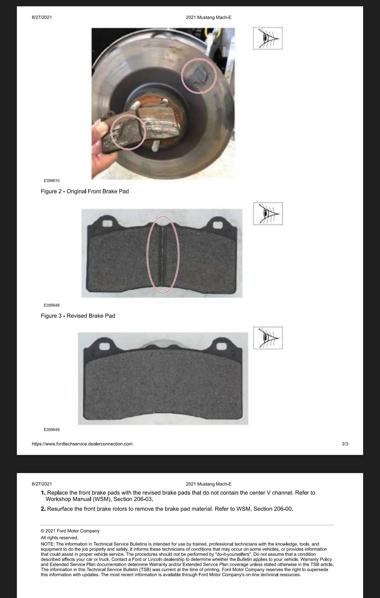

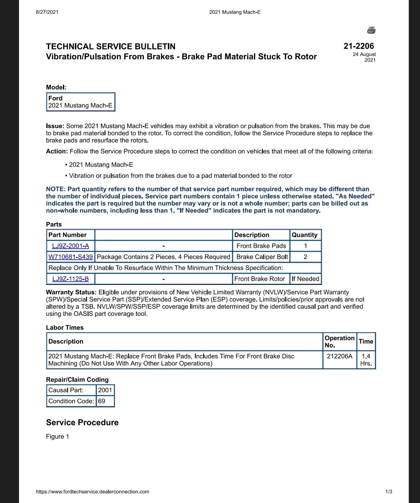

I just recently noticed this since I changed the max charge to 100% for a trip I took. (Normally set to 85%) Using 1PD and when I lift my feet to slow down or stop, the brakes seems to 'shudder'. Not sure how best to describe it but like someone tapping on the brakes. It is not a smooth deceleration. Also, seems to happen only when the battery is at or near 100%. Like the software is setup to not use regen and op for the friction brakes. Once I drive a few miles and get it down a little, its okay. Tested it a few times and seems to behave the same. Anyone else experience this?
It's possible that because your at 100% the vehicle is not using regen as it has nowhere to store that energy, as a result It's very likely your braking almost exclusively with traditional friction brakes and your front rotors are either warped or have bits of pad stuck to them. You might not normally feel this since you usually drive with 1PD, so the sensation of using only friction brakes would likely be quite different and noticeable, particularly if rotors are warped or not smooth.
My MME gets steering shutter like that when I break hard and I'm using friction brakes. There was a TSB released early on that some vehicles may run into this situation as a result of pad material sticking to the rotors. I haven't take my vehicle in yet to address this, but will do so soon. You may want to as well.

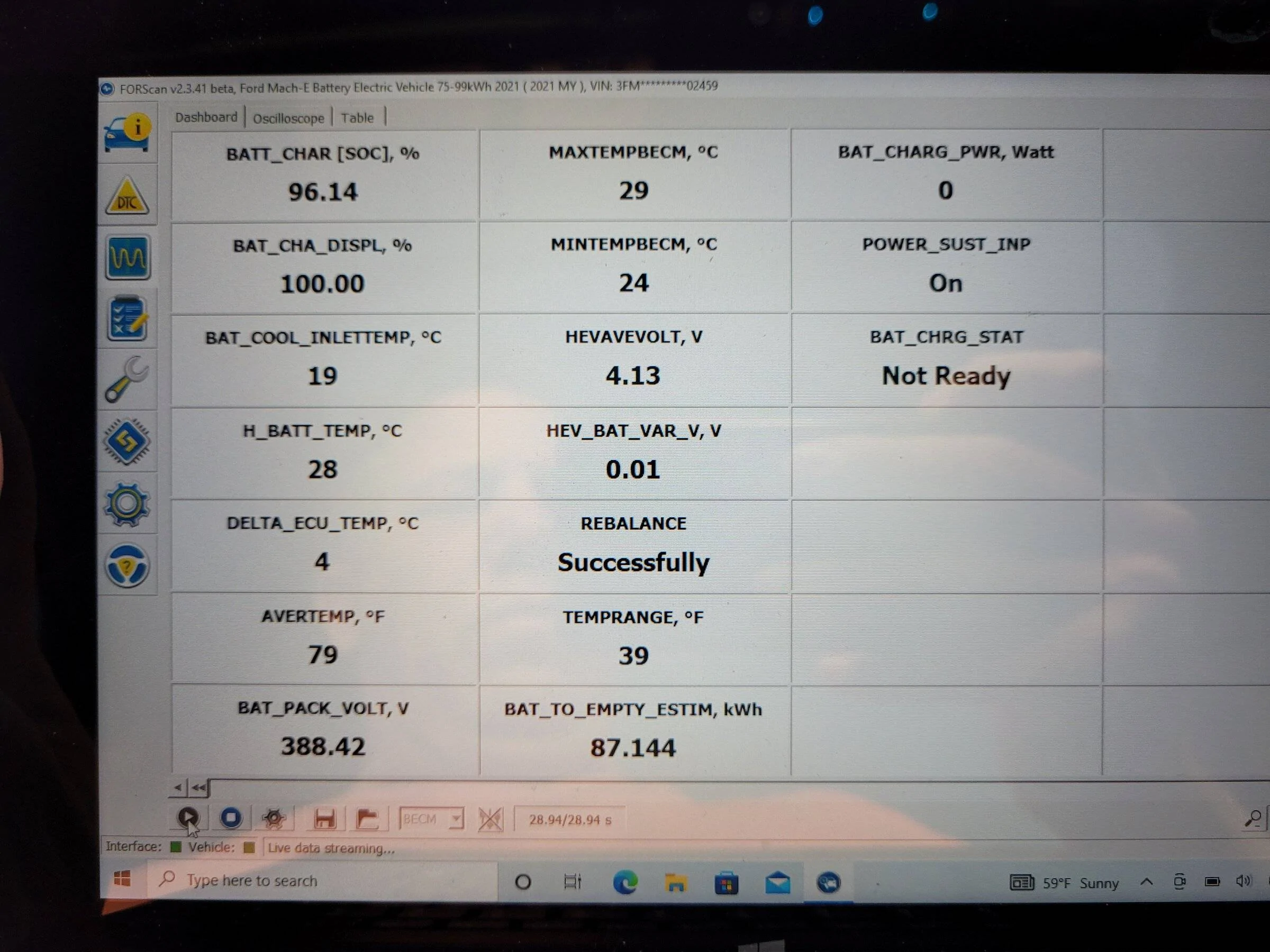

Where is “kWh to empty” presented? I thought the car only displayed an estimated range (the beloved GOM)
SnBGC
Greg
Apr 20, 2020
46
5,962
9,778
Phoenix
Manager
You will need a scan tool to access the PIDs.

Took the car back in to the dealership and it was the rotors that needed rework just like the service bulletin. Only thing now is they are not sure what will be covered since the normal warranty for the brakes are 12 months and I'm at the 14 month mark.
