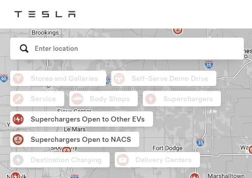

I went to try out the Tesla Supercharger adapter today. I have Blue Oval charging network setup as prescribed and successfully used it on Electrify America chargers. I went into the Charging app on the infotainmant center and, sadly none of the Superchargers near me are compatible. So, I chose one about 10 miles away in another city.

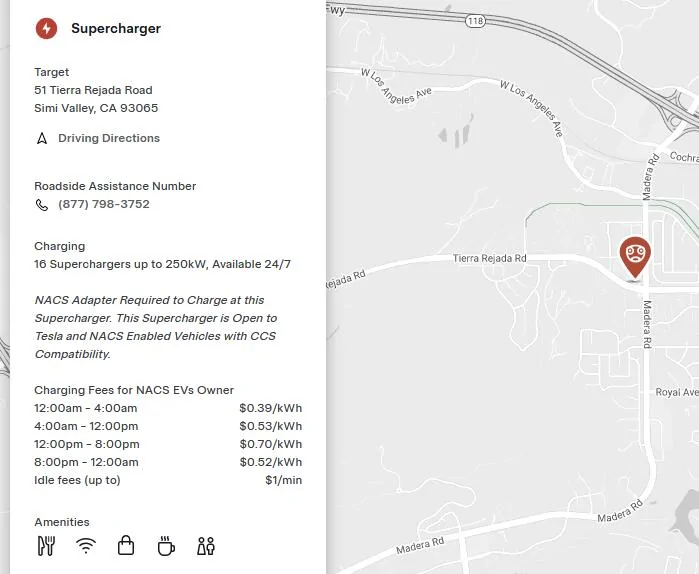

I'm using a Ford adapter and charging at the Supercharger in the map below.
