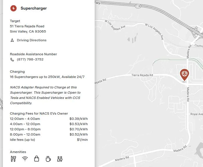

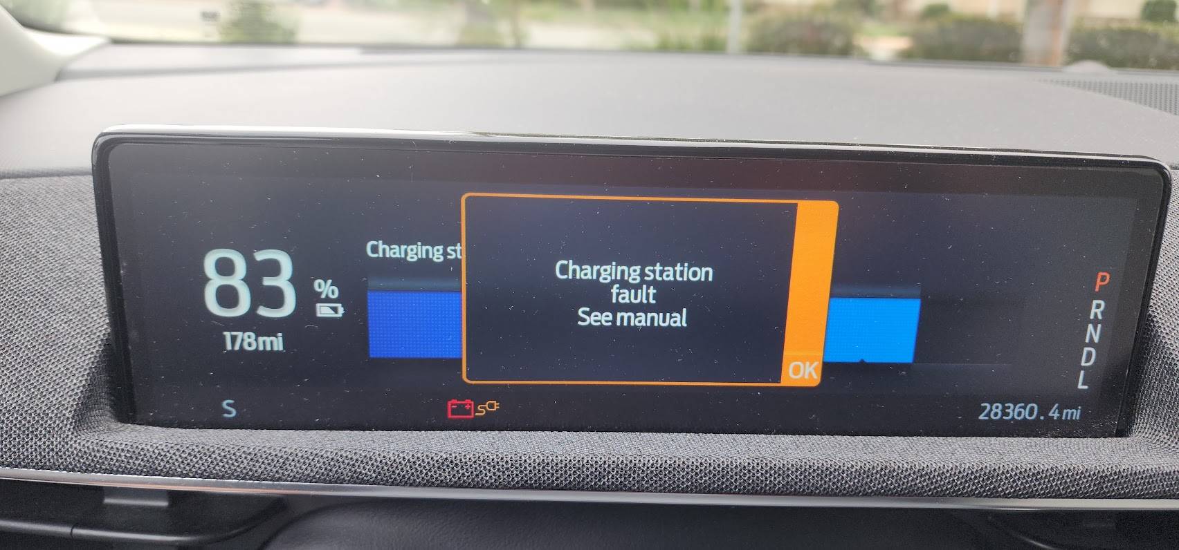

I went to try out the Tesla Supercharger adapter today. I have Blue Oval charging network setup as prescribed and successfully used it on Electrify America chargers. I went into the Charging app on the infotainmant center and, sadly none of the Superchargers near me are compatible. So, I chose one about 10 miles away in another city.
I connected the adapter to the Supercharger cable as prescribed and then plugged it into the car. The white spinning buttons turned solid blue. So, I get into the car and it says, "Charger starting" on both the big screen and in Ford Pass. It stays that way for about 5 minutes and I get a "Charging Station Fault". Bummer. I do some shopping and come back to a different charger at the same location. Same result.
I'm using a Ford adapter and charging at the Supercharger in the map below.
What do I do to diagnose this?
Most likely a credit card issue. Been there and done that?

Welk, I tried again with the Ford method after changing the payment info but it still didn't work.
The good news is that the Tesla app works. I just wanted to see if the adapter was functioning, I'll probably never use it but it's a good backup.

The Tesla Supercharger cables with the silver ring are V2, which are older 150kW stations. V2 Superchargers do not have the hardware needed to communicate using the CCS protocol, so they cannot communicate to non-Tesla cars.
V3 Superchargers have a black ring, a thinner liquid cooled cable, and have the hardware to communicate to non-Teslas. But, Tesla has not made every V3 site available to non-Teslas, likely due to them already being too busy just servicing Teslas.
So, silver ring = not for you. Black ring = maybe.
