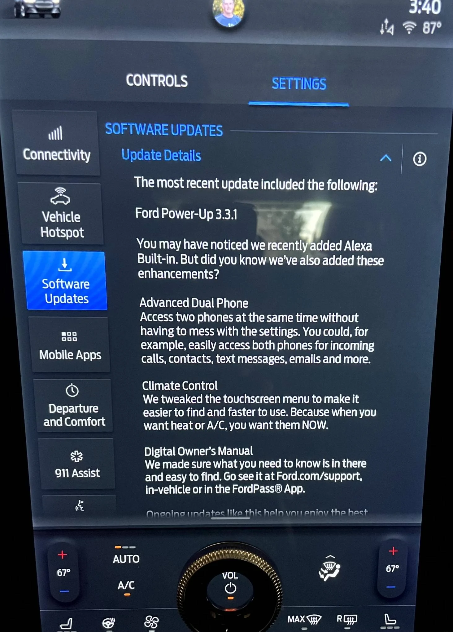

Not the OP but my 22 CA RT1 has Software Updates as well. I don't believe I have ever had the options mentioned in the manual or on the Fordpass app to Turn on or off automatic updates or to set a schedule.
February 4th build date, delivered in late March.
I thought perhaps those settings missing would prevent me from getting OTA updates but I was able to get 3.1.1, 3.2.1, and 3.3.1.
On July 28th I used FDRS to update all outstanding modules. I don't have any memory of what update options were present before I ran the updates.
Thanks for including the image @kdonnel. That is exactly what I am seeing in my car. Good to know I am not alone. Still not clear if this is an issue with the system, or a future update for all.

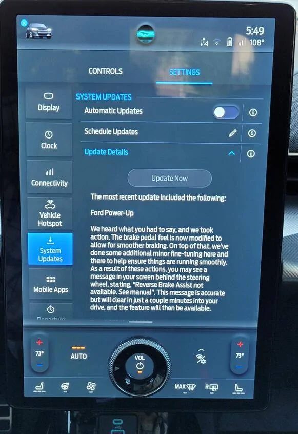

Here is what mine looks like.
I would hope it isn't a future update. Meaning.....I am hoping that Ford isn't planning on removing the option to turn off Auto OTA and the scheduler. From looking at @kdonnel's screen....it appears that 3.3.1 removes both of those features and changes the name from System Update to Software Update? :oops:
Really glad I saw this thread so I'll know NOT to allow the PowerUp 3 series to install.
