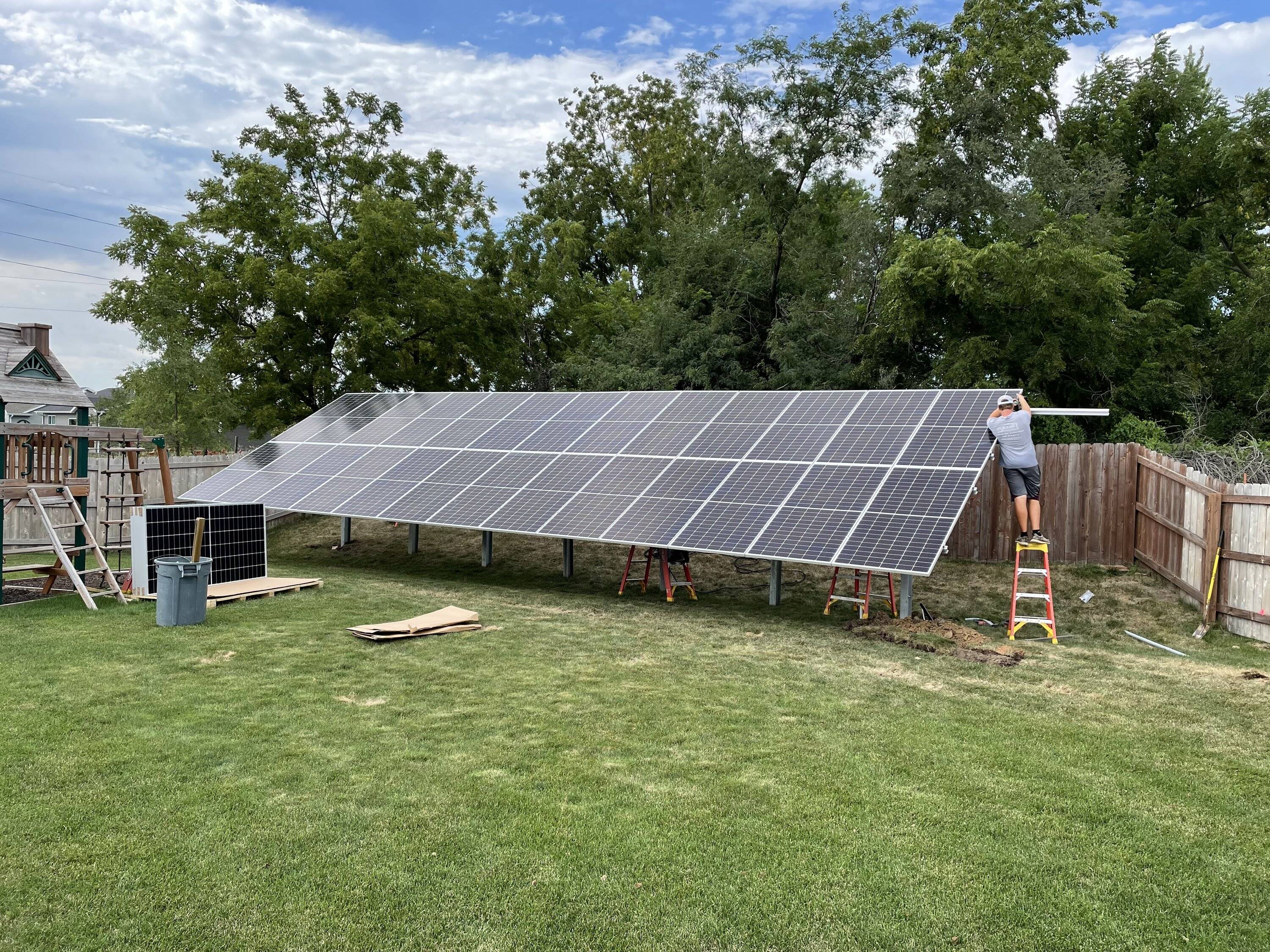

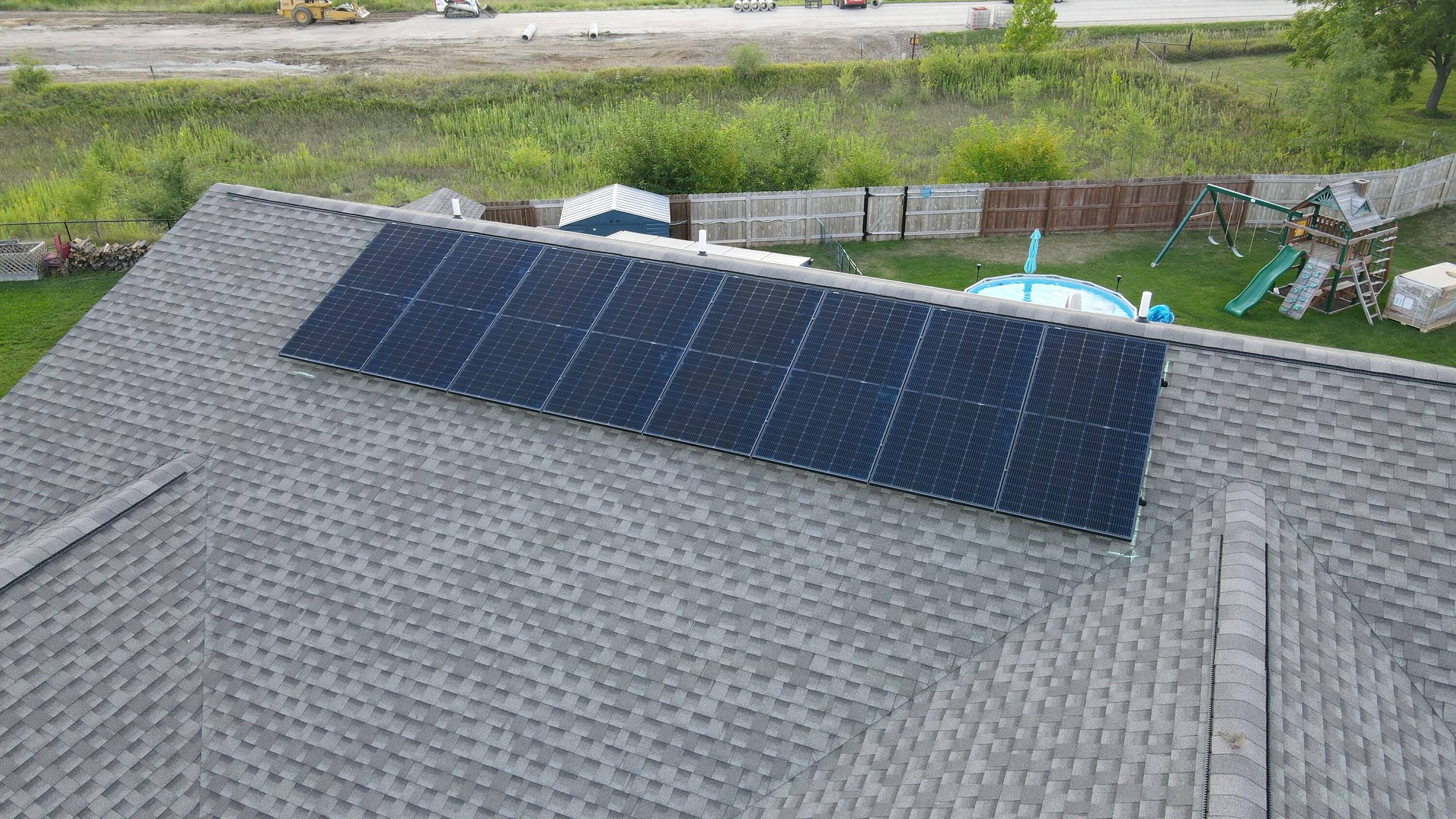

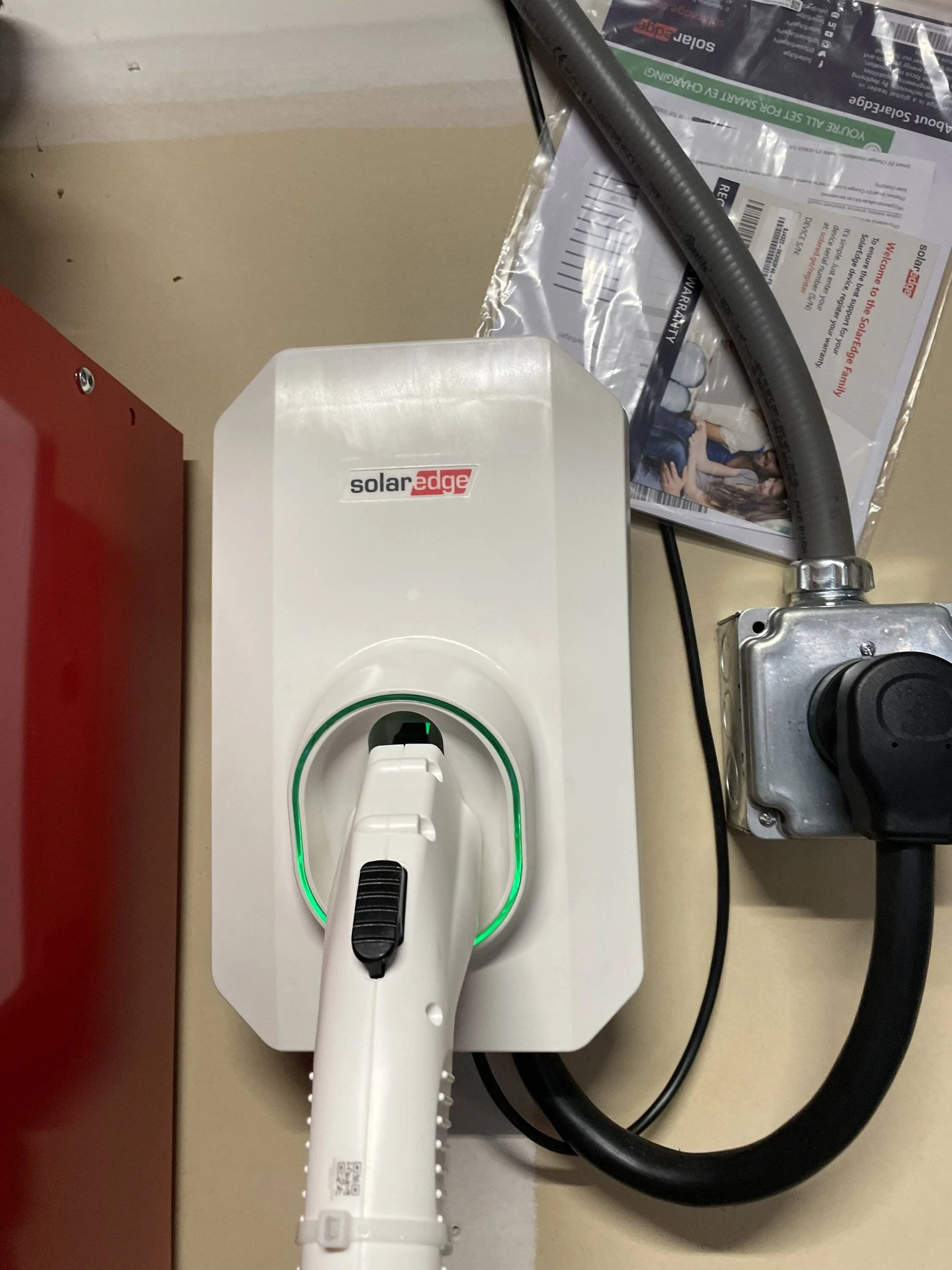

I did! But for the whole house, not just the car. 34 panels totalling about 15kW. 10 kWh battery whole home backup + solar connected EV charger that pumps any solar overproduction into the car before selling to the grid.

Those ground panels are perfect candidates for bifacial!
