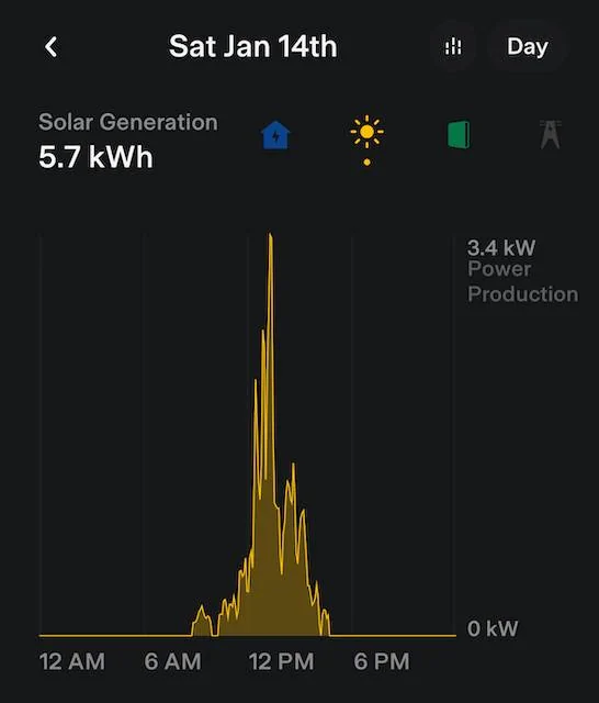

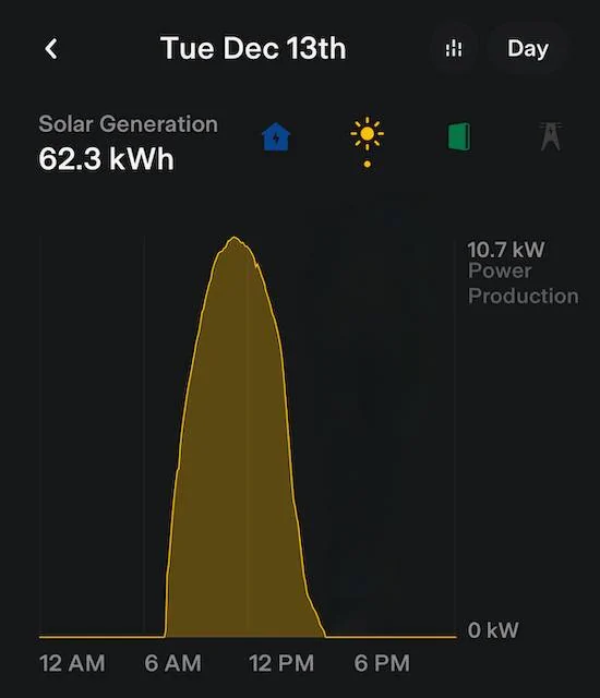

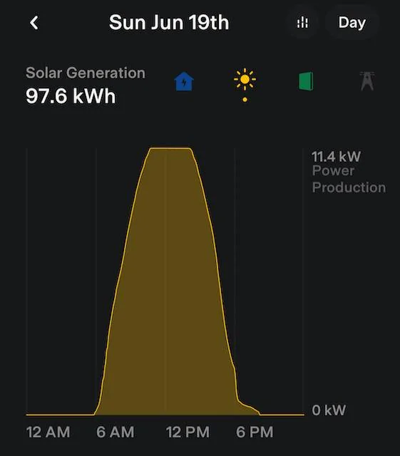

markboris
Nov 13, 2019
5,803
16,621
Sonora, CA
Would be curious to know what kind of generation you are averaging during the dreary winter months? I'm also in the PNW and am considering going solar within the next year or two.
I'm in NorCal at the foothills of the Sierra Nevada mountains. We get about 6 months with days of mostly full sun and the other 6 months about half the time with full sun. Then there are the days, like we have had the last few weeks, of dark clouds and rain/snow. My production can vary quite a bit as all homes with solar can.
Typical summer day (full sun) close to summer solstice:
Ford Mustang Mach-E First Month Owner Experience Charging with Solar Panels IMG_4282 (1)
Typical winter day (full sun) close to winter solstice:
Ford Mustang Mach-E First Month Owner Experience Charging with Solar Panels IMG_4284 (1)
Typical winter day cloudy, rain/snow:
Ford Mustang Mach-E First Month Owner Experience Charging with Solar Panels IMG_4285 (1)
Just Lurking
Paul
Dec 31, 2022
635
599
Washington
2022 Mach-E GT
Thanks for those examples! Pretty amazing how much solar power decreases on a rainy / cloudy / snowy day. That's great information to know that it can be less than 10% of the power generated on a sunny day.
