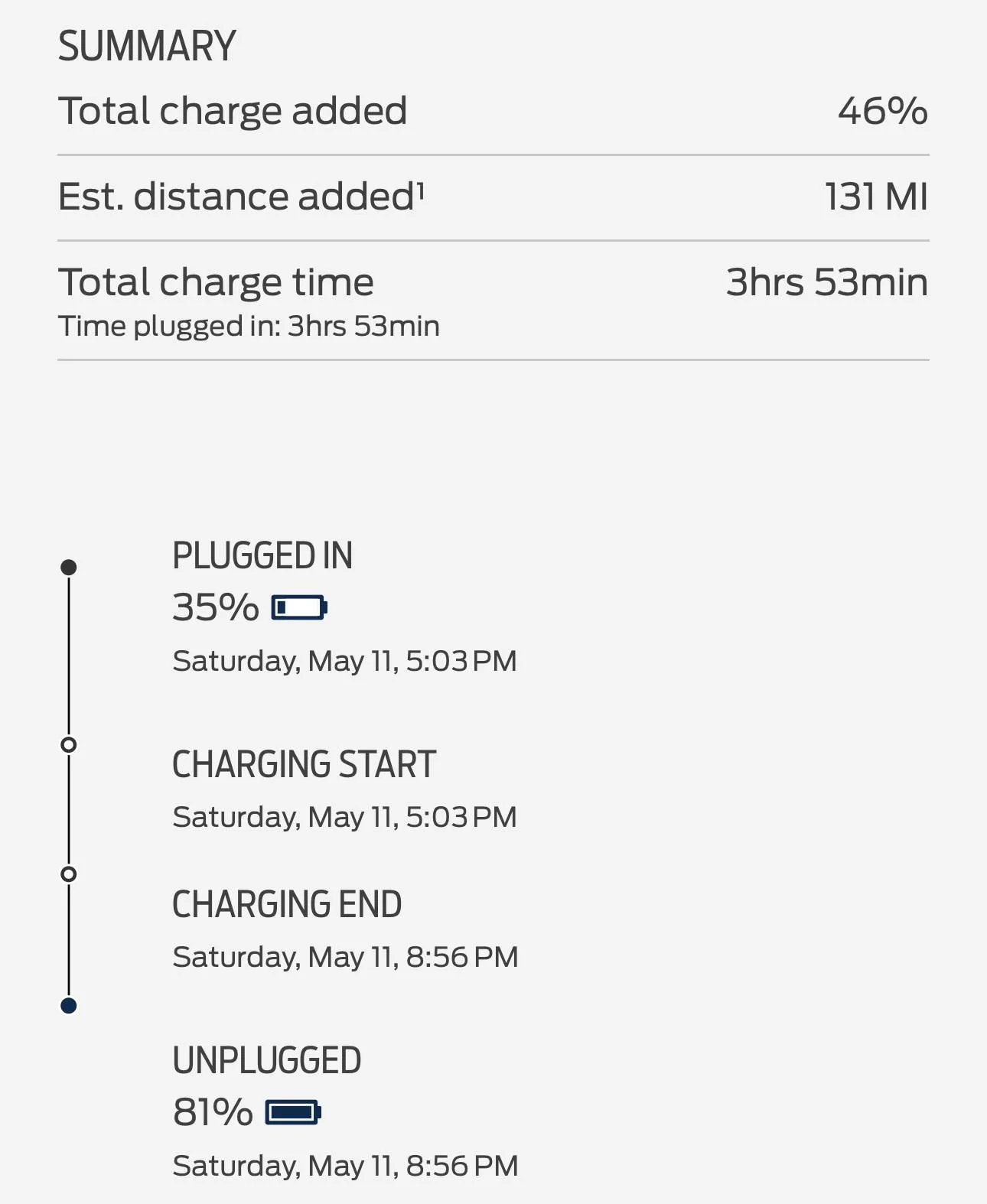

I’m guessing my L2 same just charged 39% to 81 in 4 hours?
Before unplugging, you can see the total energy that went into the vehicle. Divide by time and you will see the charge rate.
Or, look while it is charging.
I have the Ford one not the one that comes with the car but the expensive one and I believe it’s anywhere from 48 to 60, but I don’t know if I could set it for anything. I’m not sure where to look.?
The Ford charger is supposed to be 48 A and I know they installed a 60 amp breaker
48 x 240 x 93% (7% loss) = 10,700 watts, 10.7kW.
40 would be ______
81 - 39% = 42%. 91kW battery, so roughly 38kW. Divide by 4 (I suspect it is slightly less than 4) and that is 9.6. Therefore, it has to be 48amps, because 40 would be ____.
40 would be ______

That's after unplugged.
46% of 91kW = 41.86kW approximately (percentages aren't perfectly accurate).
41.86/3.88 hours = 10.8
Therefore, you are set to 48amps.
