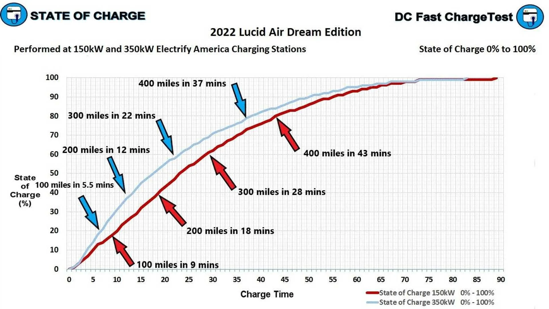

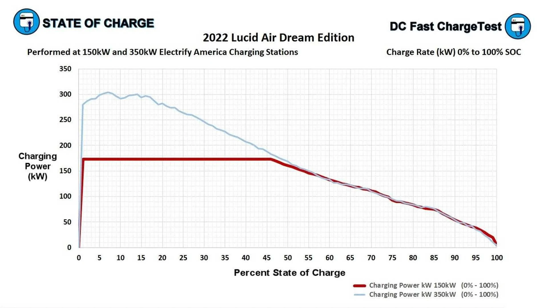

Lucid is currently the leader in charging speed, and their cars don't maintain 300 kW for more than a few minutes:
Ford Mustang Mach-E Solid State Development 1662658117957
But even with that charge curve, which should be a lot flatter with solid state batteries, the time needed to add range is excellent. If you have a Lucid, and can find a good 350 kW pump, you will spend very little time at the station.
Ford Mustang Mach-E Solid State Development 1662658454249
I think the 20 minute charge is the sweet spot. If you can charge in 20 minutes or less, it is almost equivalent to an ICE petrol stop. I only needed a 10 minute charge yesterday when coming home from vacation, and that is how long it also took to pee and walk the dogs. Waiting an additional 10 minutes would not have been a big deal at all.
With a sustained 20 minute 350 kW charge, you could easily add 300-400 miles of range even in a relatively inefficient vehicle. That is what solid state batteries will give us.
