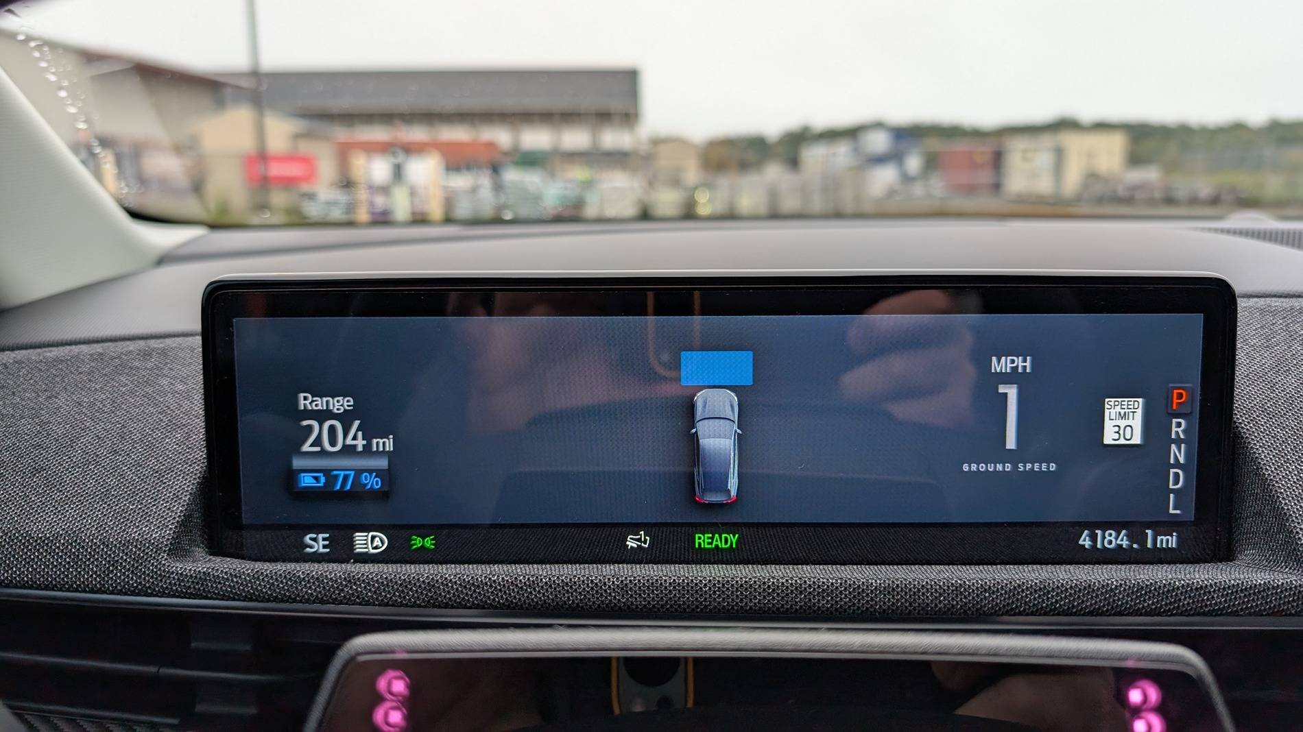

Mine caught the 1 MPH bug. First time noticing it. Currently on 6.14.0

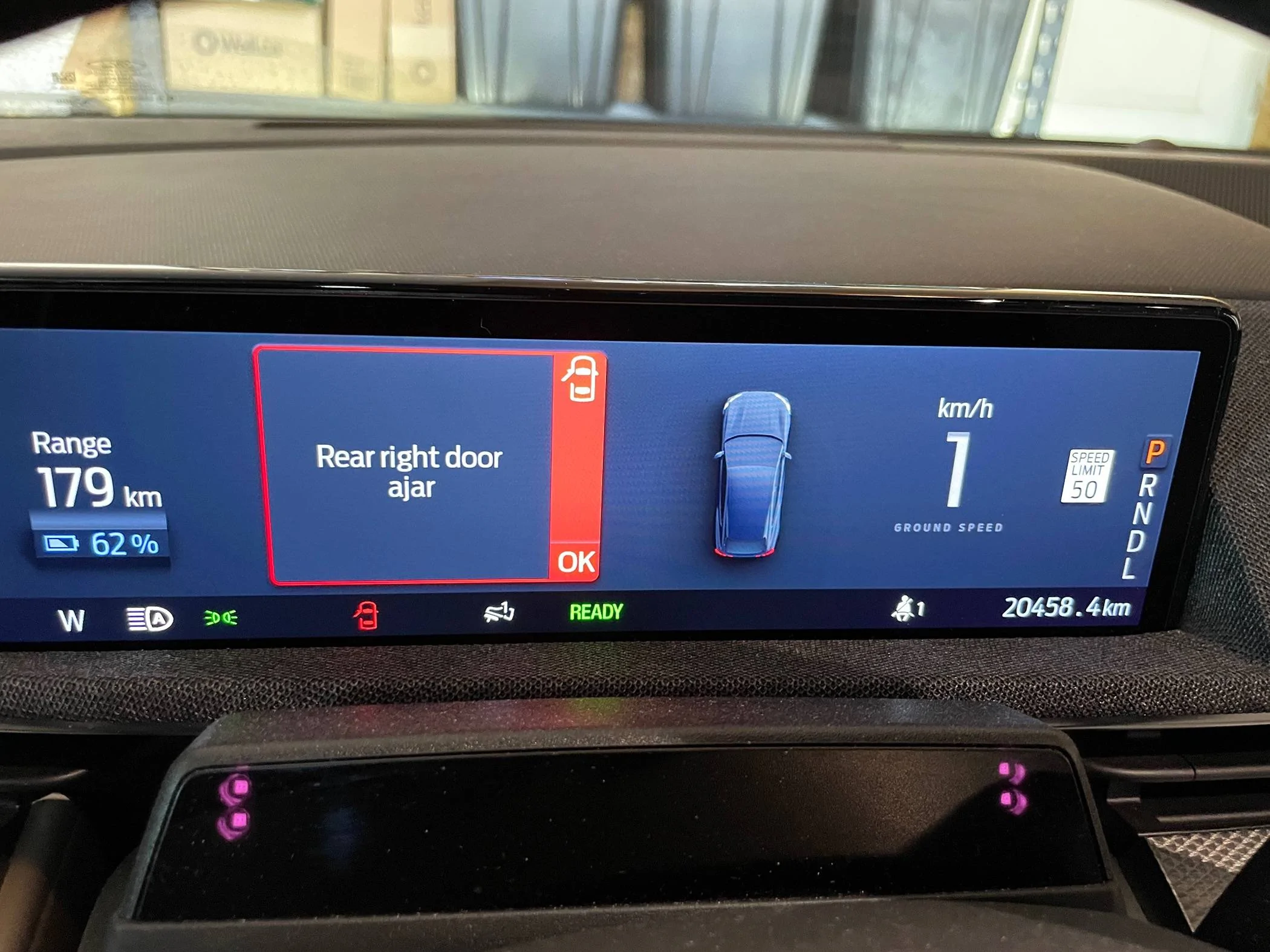

Anyone else see this before? Speedo is showing 1 mph but car is parked.
No, but don’t all Mustangs look like they’re doing 100mph while standing still?
